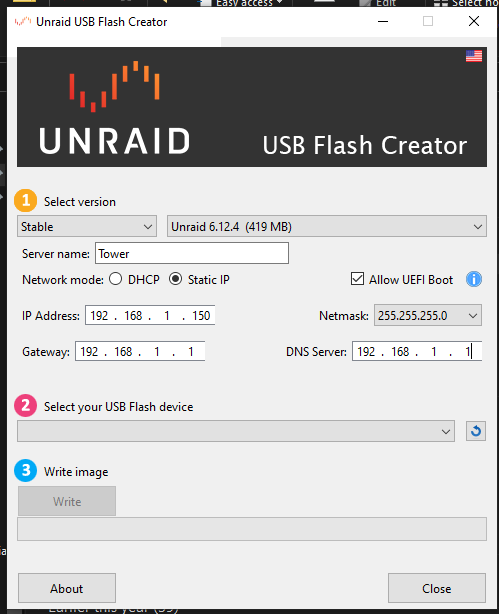

When I boot into unraid using the old USB, it is loading to the wrong IP and has the name of towertest. So I copied my Config file and reinstalled the OS using the downloader utility. I changed my IP to the correct number and made sure the name is Tower. But when I bootup, it is still on the wrong IP and has Towertest as the server name.

Don't understand why, here is the configuration I used to recreate the USB

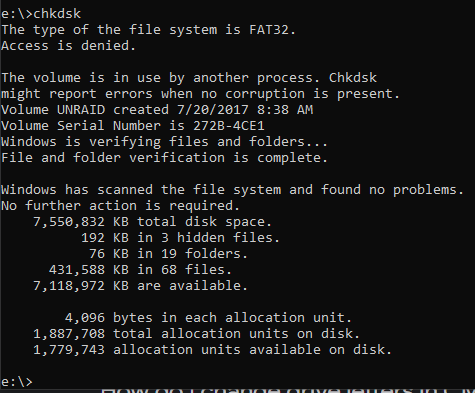

I looked at your diagnostics and the network.cfg is missing from it.  Shutdown the server.  Pull your flash drive and have a look at it on your PC.  Go to the /config directory/folder and look at the dates and times on the files.  Do they make sense?   (You do have a oldnetwork.cfg file.  So you should have a new network.cfg with a later time and date.) While you have it out and in the PC, run chkdsk on it.
Hi
The dates look correct to me. Some files were created years ago when I 1st created my server. But many are from the last 2 days, when I tried to recreate the USB.
The network.cfg file did not get recreated. Per earlier instructions, I renamed the networkconfig file.
Chkdsk did not find anny errors
