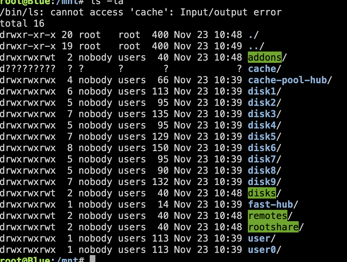

And now I have no docker or cache folder. Appdata can't be found either.

Do you know why the cache is showing ? and how to fix that?
Showing where?
When I do ls -la the cache shows "?". Also in the docker settings, I'm getting errors that appdata and cache folder can't be found anymore.

Regarding the cache issue:
Nov 23 10:49:01 Blue kernel: XFS (sdc1): Metadata corruption detected at xfs_bmap_validate_extent+0x41/0x68 [xfs], inode 0x40000081 xfs_iread_extents(2)
Nov 23 10:49:01 Blue kernel: XFS (sdc1): Unmount and run xfs_repair
Check filesystem, run it without -n.
Phase 1 - find and verify superblock...
Phase 2 - using internal log
        - zero log...
ERROR: The filesystem has valuable metadata changes in a log which needs to
be replayed.  Mount the filesystem to replay the log, and unmount it before
re-running xfs_repair.  If you are unable to mount the filesystem, then use
the -L option to destroy the log and attempt a repair.
Note that destroying the log may cause corruption -- please attempt a mount
of the filesystem before doing this.
This is what I got as a response. I'm not sure how to get the file system to replay the log.

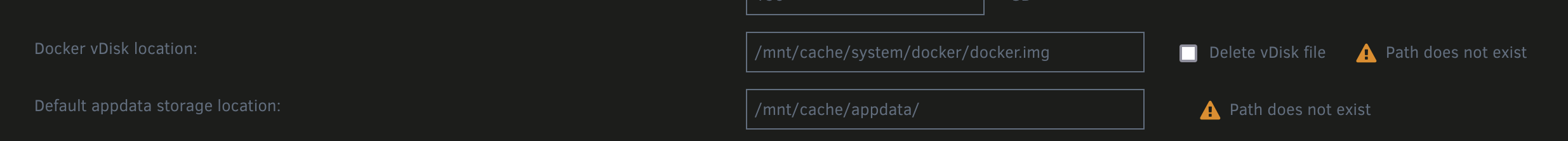

Below is what I see in docker.
Use -L
I did that. The shares disappeared. I rebooted and they came back. I re-downloaded the containers since they were gone. I needed to change some of the network settings, maybe because of the macvlan change. But I think everything is back up. The bigger question is if the two fixes will help resolve the locking up issue.
