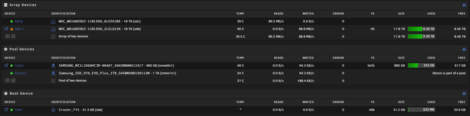

I'm not sure if I'm not quite understand what you wrote or if I didn't explain my setup well to begin with, here's a screenshot of my main disk setup...
1 hour ago, allied-encumbrance5583 said:
this seems to be making the reconstruction extremely slow
The bug doesn't affect rebuilds.
Do a new config, assign old parity as disk1, old disk1 as a pool (or disk2), start array, confirm disk1 mounts and format the pool/disk2 xfs, copy the data, once done do another new config to assign them to the desired slots.

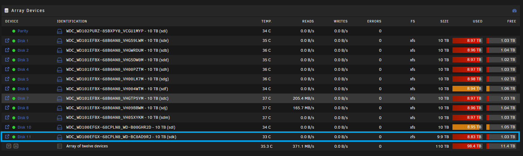

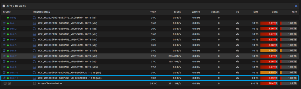

1 hour ago, Nanuk_ said:
Does anyone know why in the Main unraid dashboard it says 8.83TB used but on Glance it's only 256K used?

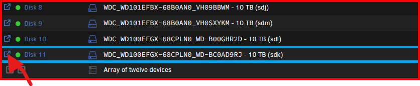

Click here and see what is on the disk:
That open up the Dynamix File Manager which will allow you to examine the disk's content and you should certainly be able to determine if there 8.8TB or only 256KB stored on it. There is a 'CALCULATE' button which will show info on each Share (or directory) stored on that disk.
Thanks again @Frank1940 ! I tried it. Looks like Glance is wrong. I'll just have to get another drive and transfer the files to it before reformatting it.
