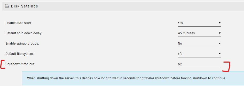

@EDalcin, get times on stopping the array on the Main tab and add 25% to it.   Then look at the setting on the   SETTINGS     >>>   Disk Settings  and set the marked parameter in the screenshot below to that calculated value:

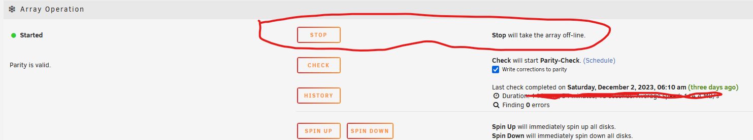

Where exactly is this? I couldn't find it.
 I have "90" at "Shutdown time-out:". Should I have more?
It depends, the diags after an unclean shutdown will show, but you can safely set it to 150secs, a higher value it's often needed.
On the MAIN tab of the GUI as shown in the following screenshot:
You do the timing manually with a stopwatch (or its equivalent).  Great accuracy is not required as the time may vary several seconds from measurement to measurement.  You are after a good approximation of the time required.  Remember if the array can not be stopped within that time setting on the Disk Setting tab, Unraid will force an unclean shutdown!  As I understand it, Unraid will do a clean shutdown as soon as it has detected that the array has been stopped so having a shutdown time that is on the high side has no real penalty if things are working correctly. (The sole exception being if your UPS runs out of battery power as a result of waiting...)
Great explanation @Frank1940 ! That makes perfect sense now. I'll hit "Stop" and do the timing manually. Then, I'll set the "Shutdown time-out:" accordingly. Thanks!
