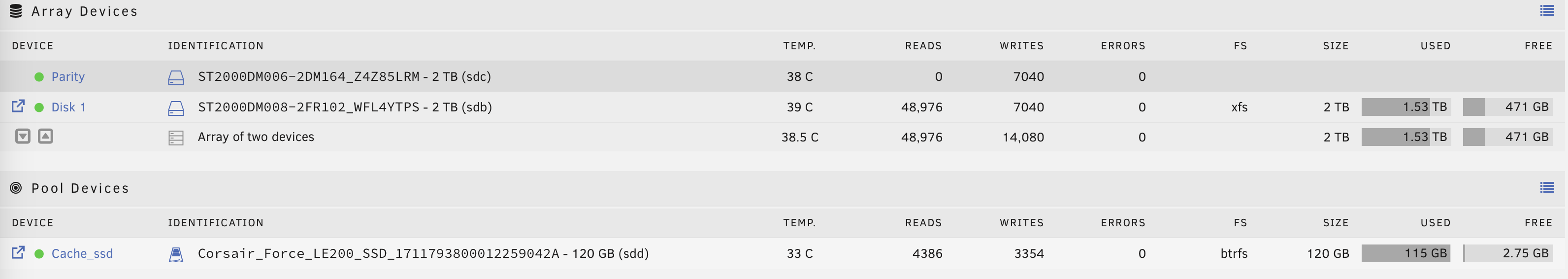

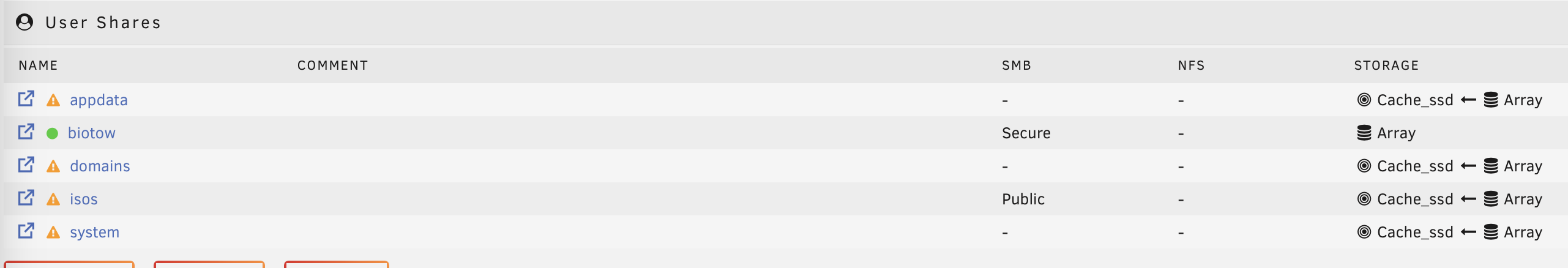

I am a newbie on Unraid and messed up setting up the cache in first place. Right now my main share folder is split between cache and array and mover does nothing when I try to reverse things back to normal.
While I put by bulk data share on array now, I cannot empty the space on cache. Here are screenshots of the setup I have. "biotow" is my shared folder.
How can I move those files back to cache? Then I will set appdata, domains and isos back to cache.

None of your shares are set to be moved. And your cache is probably too small for anything except appdata, domains, system, (and isos if you want those on cache)
First thing is to move the other share b----w off cache. Mover won't move any share without a setting for Secondary storage. Set that share to Primary: cache, Secondary: array, Mover action: cache->array.
Run mover, wait for it to complete, post new diagnostics then we can try to see if your "default" shares will fit on cache.

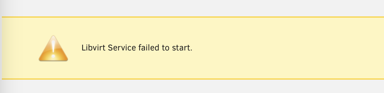

@trurl I just got home from work and found my Libvirt service dead after this. Everything else seems to be working and no actual data loss from the "b--w" share is seen. It seems like VM is refusing to create .img file for VMs. Here is the diagnostics:
biotower-diagnostics-20231207-1727.zip
And weirdly Jellyfin refuses to work in port 8096 but 8097 works fine.
Thanks!

Did you actually have any VMs yet?
Nothing can move open files. Disable Docker and VM Manager in Settings until things are where they need to be.
I recommend removing mover tuning plugin until things are working well. Since your cache is so small you may not need to move anything after things are where they need to be anyway.

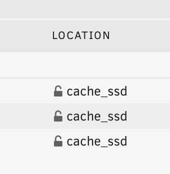

I have turned uninstalled mover tuning, and set my system folder to be primary on cache, changing the mover action accordingly. As of know, the following error has disappeared. Mover seems to be working since I can see my folders' location being updated as "cache_ssd" rather than both. I need for mover to finish working it seems.
Thanks for your answers.
As I stated the issue is solved. Both VM and Docker are working properly Right now there are no issues. The state of shares:
Thanks for your input, it opened my mind about unraid config.

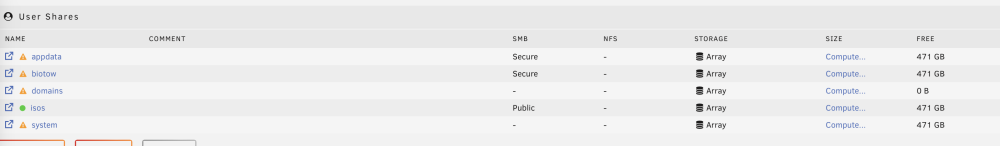

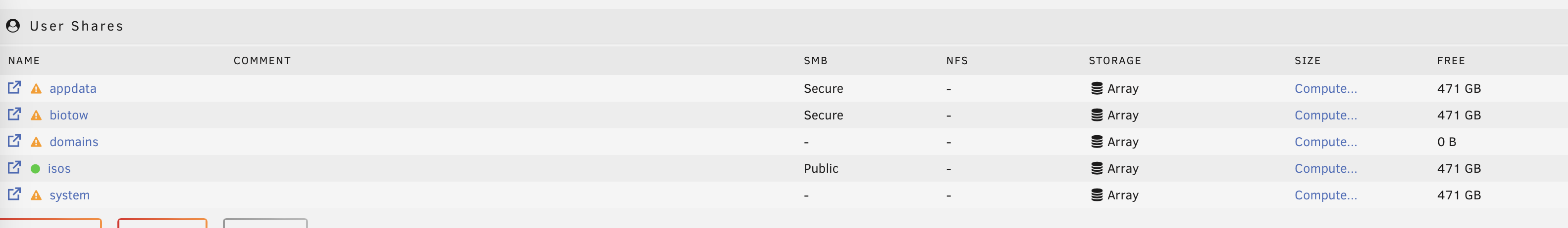

Have you confirmed that those shares no longer have any files on the array?
Yes, every share is like the screenshot below. I will not upload each and every share to not to flood you with multiple pictures.
