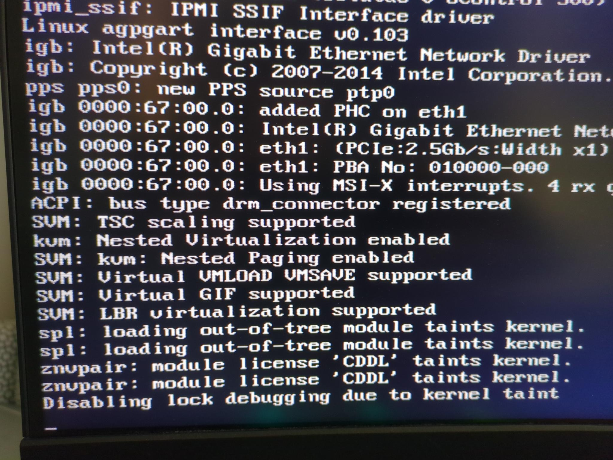

After a day of memory tests, I tried to boot into unraid. I get the following line:
"AES CTR mode by8 optimization enabled"
(would attach an image, but doesn't look possible without uploading it somewhere)
Then nothing. Tried with plugins, without, with gui and without, all the same.

Can you unlock the other one and lock this one? The other one has the image of the output.
There are limitations until your first post is approved since we get a lot of spammers.
This thread is where the replies are, so I will leave this one unlocked. I doubt that image in the other thread will be useful, but here is a link to it:

I've been fighting this same issue for a few days now, pulling out what little bit of hair I have left. But in my case I was able to work around it. In my case, I am doing a new Unraid build, getting ready for the 6.13 BETA to start as I want to do a massive all flash array on ZFS with bifurcated cards and ssds, so I'm building a new Threadripper based system with a 5955WX and currently an AsRock Rack WRX80D8-2T board (though I have tested a few boards with the same issue lately).
Come to find out, all the boards I have been testing with have an onboard BMC/IPMI interface with the AST2500 built in VGA. I had to plug in a standalone VGA as my VGA to HDMI adapter was seemingly not working and I needed to see what post was telling me. While display was correctly routing through my GTX 1030 until unraid started loading the drivers for the BMC. Soon after it seemed to "freeze" at "AES CTR mode by8 optimization enabled". What I am thinking may be happening is unraid loads the drivers for the onboard BMC and then routes output to that, leaving the session I am watching stale, as if the system froze. I ended up disabling onboard VGA in the bios, and what do you know, booting without issue.
Just wanted to chime in for someone else having a similar issue.
Edited by cybrnook
Yes, that can happen when there are multiple GPUs, you can also blacklist the AST driver so that it's not loaded by Unraid:
https://docs.unraid.net/unraid-os/release-notes/6.10.0#linux-kernel
Yep, this also did the trick (blacklisting ast). Let me boot into unraid while still using the onboard VGA, no external GPU required.
