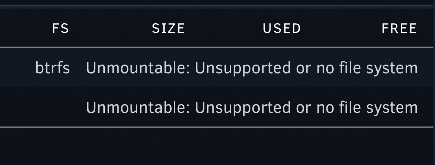

I’m sorry but… how do I perform a backup of the pool?
It’s not mounted so the shares aren’t available
The previous log snippet showed the pool going read-only, not unmountable, reboot and post new diags after array start.
Try
btrfs rescue zero-log /dev/nvme0n1p1
Then restart the array
