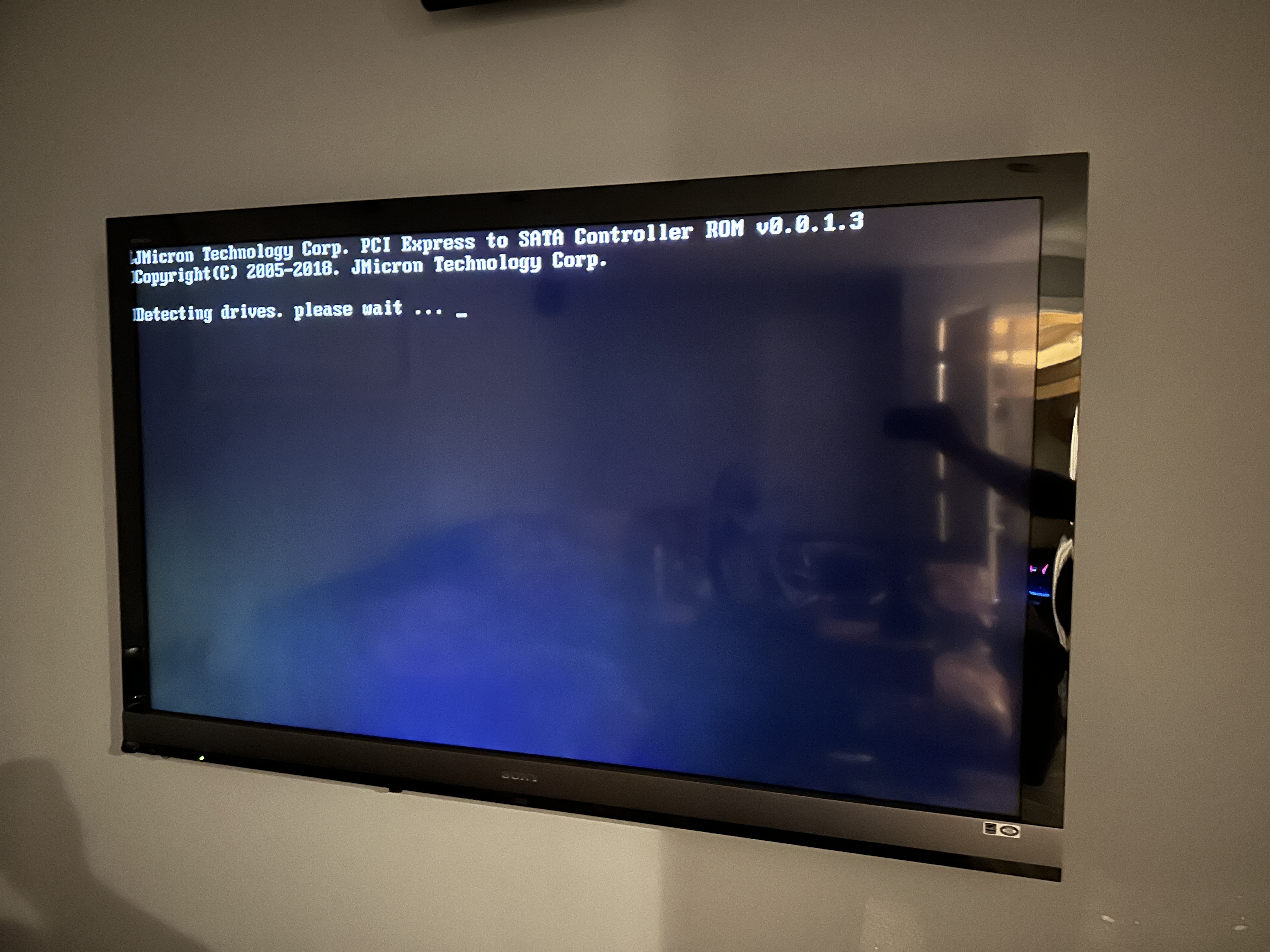

I restarted it a while ago, and I got this screen. I'm not able to log in.
Any idea ?
Detecting drives. please wait...

Doesn't look like you have even made it to the Unraid boot menu. Must be a hardware problem.

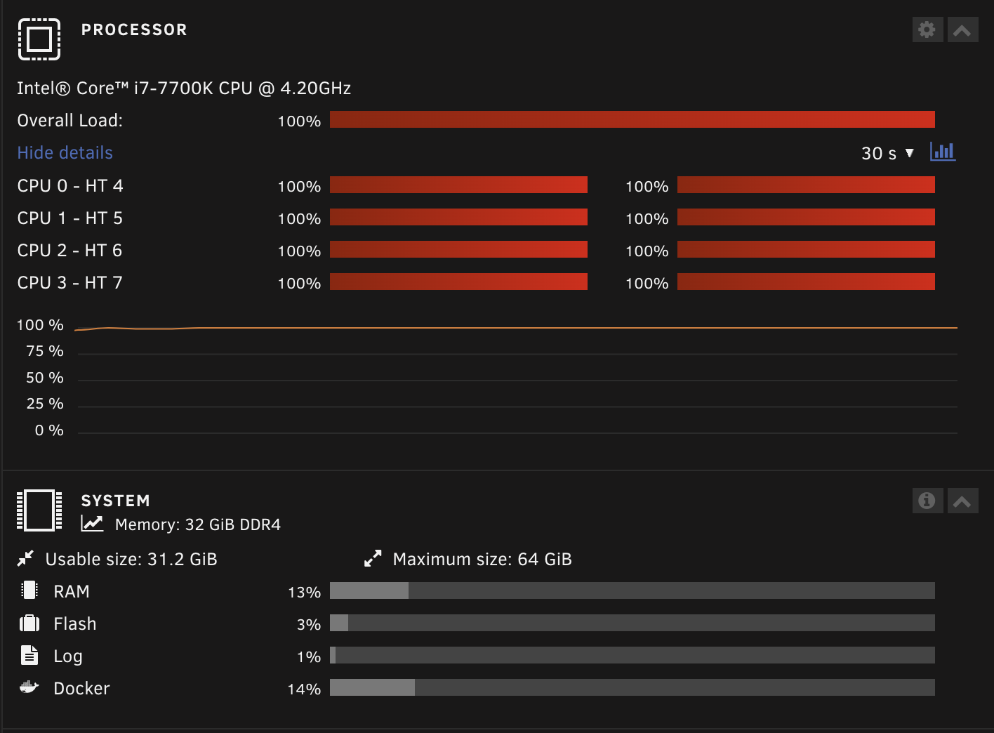

My CPU is at 100%...1021851113_Capturedecranle2023-12-15a09_23_03.thumb.png.5d7680586ae7eb0b8c159b279ba889c5.png
I think is this plugin...

I returned to
Nothing work !
You need to get it to boot from the flash. Check your BIOS settings

If it never finishes detecting drives, seems like a hardware problem. Will it boot without the disk controller?

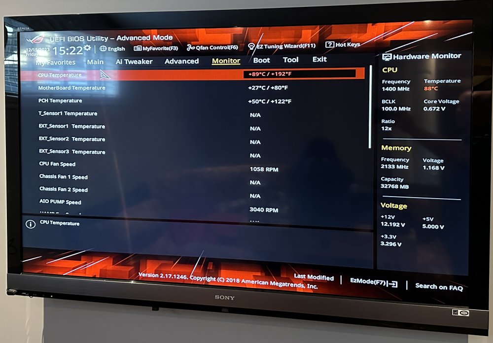

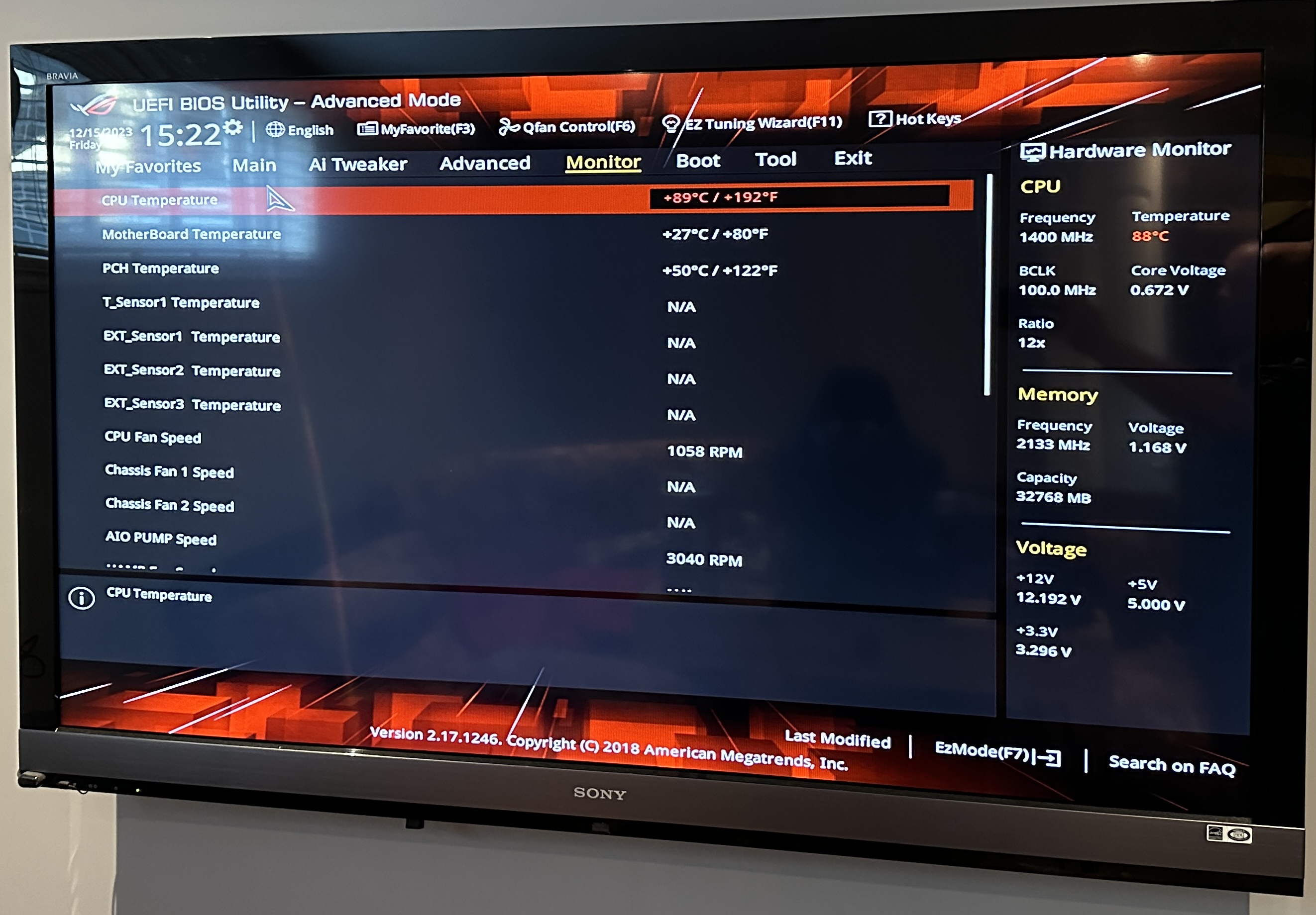

My CPU overheat !
I remove the disk control, and now I can access to the bios.
4 minutes ago, Jobine said:
My CPU overheat !
Did you change anything in the server? Is it possible there's too much dust or in a confined space with not enough airflow? It's possible your CPU maxed out under normal load due to thermal throttling.
Nothing change...
I have a liquid cooler and It's clean.
In Unraid, there are no alarms or a way to see the temperature.
Dynamix System Temp plugin
You need to fix this problem before attempting anything else with this computer. Thermal paste, fans, whatever it takes.
