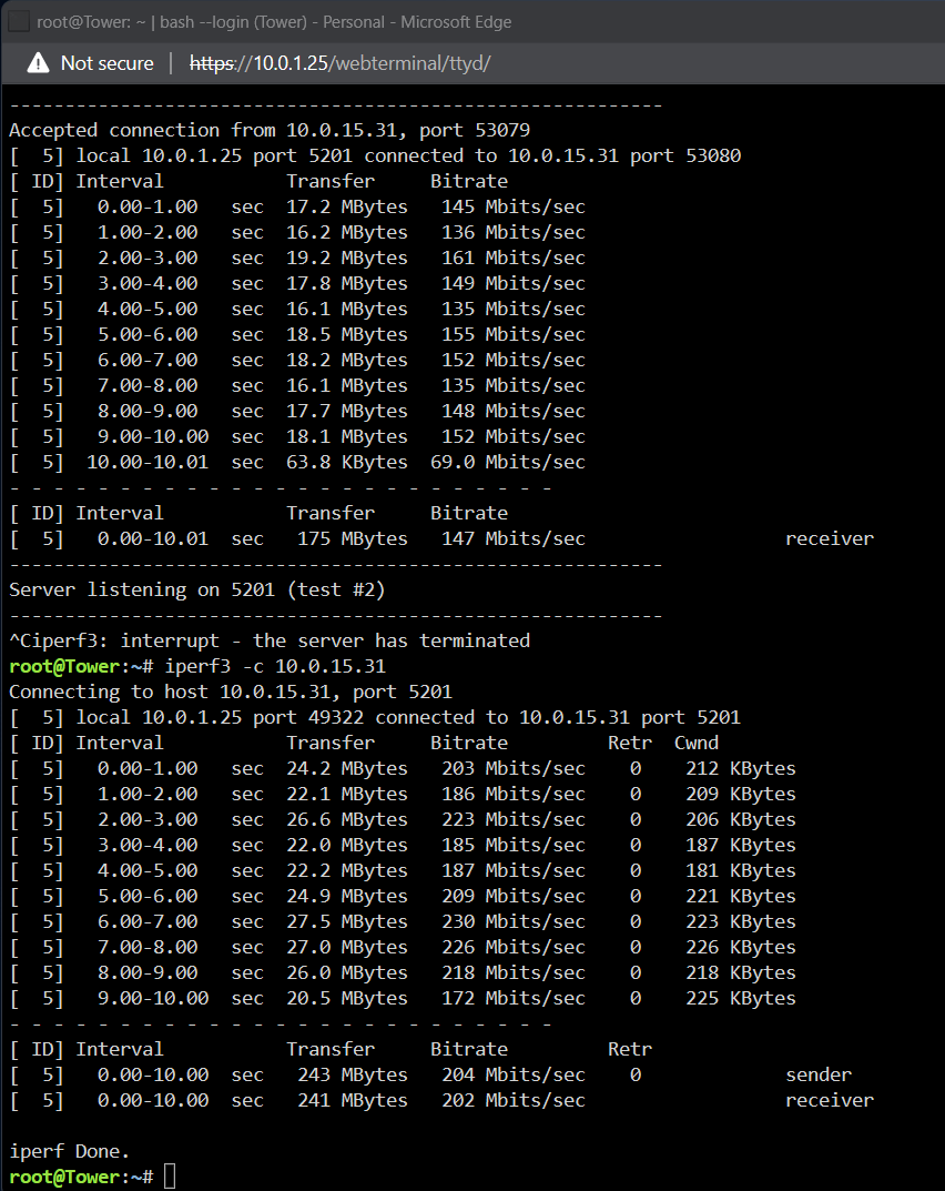

@JorgeBiperf test attached. Ethernet connected to same switch, but on different vlan. I have replaced multiple cables and tried different ports. Must be network somewhere? Local disk transfers are as expected.
The test confirms the network is the problem, could be NIC, switch, cabels, etc, also if you get the same speeds over wifi check the routing.
