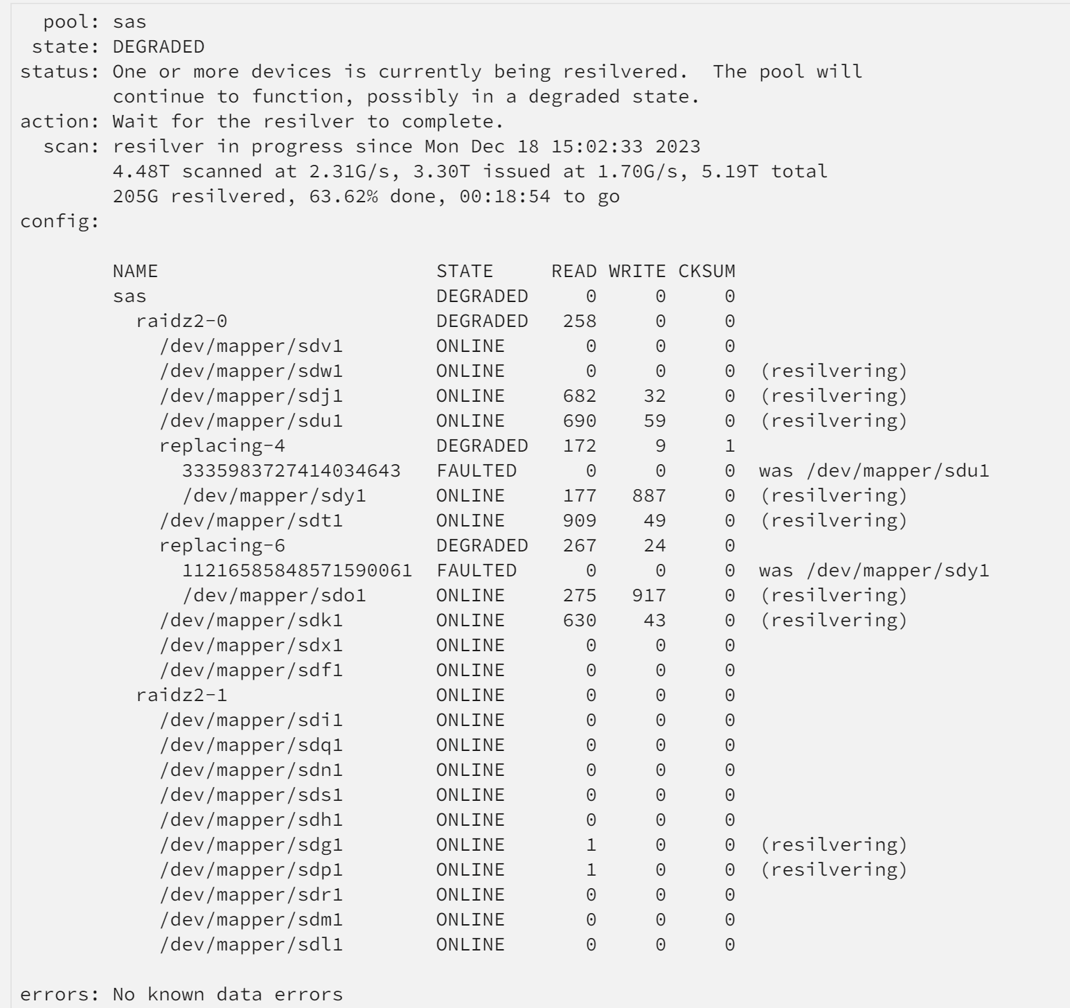

Hi
Does this mean two of my SAS drives failed at once? Could it be the SAS controller instead? Please let me know how to diagnose
So many drives with issues suggest a controller or power/connection problem, post the diagnostics.

This is happening with multiple devices, and these "Power-on or device reset occurred" errors usually mean a power/connection problem.
