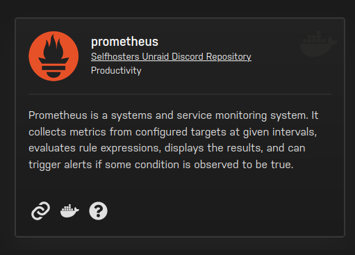

Prometheus
Find in CA under "Prometheus" and install
In /mnt/user/appdata/prometheus/etc create or edit prometheus.yml to include this text block:

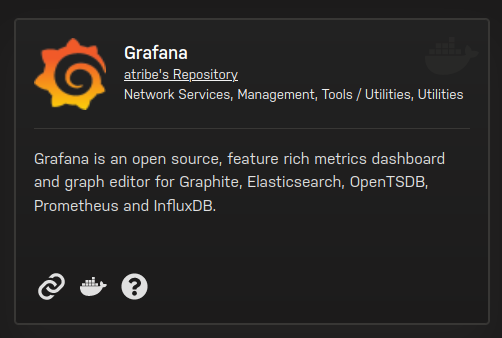

Grafana
Find in CA under "Grafana" and install
After you have gone through initial setup and logged in to Grafana:

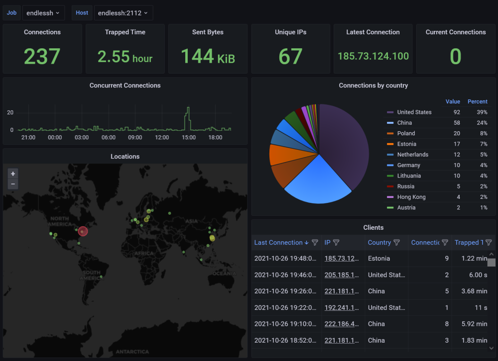

You should now have a saved Dashboard that will visualize your endlessh-go metrics like this
It may take some time for anything to populate as you need to wait for attackers to find your honeypot :)

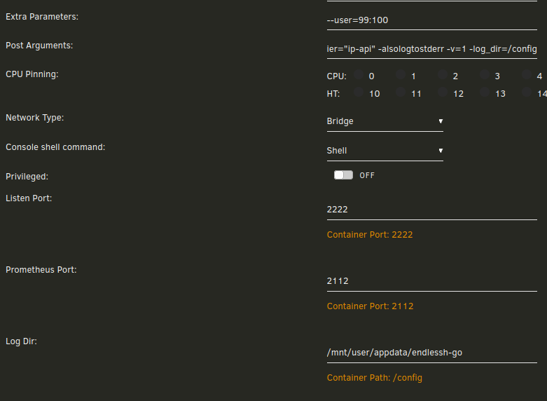

The container logs all output to the docker container logs by default. If you wish to also log to file modify your container like so:
  • In Post Arguments replace -logtostderr with -alsologtostderr
  • In Post Arguments append this to the end: -log_dir=/config
  • In Extra Parameters add this: --user=99:100
  • Add a new Path variable
    • Container Path: /config
    • Host Path: /mnt/user/appdata/endlessh-go
Your settings will look like this after all modifications are done:
