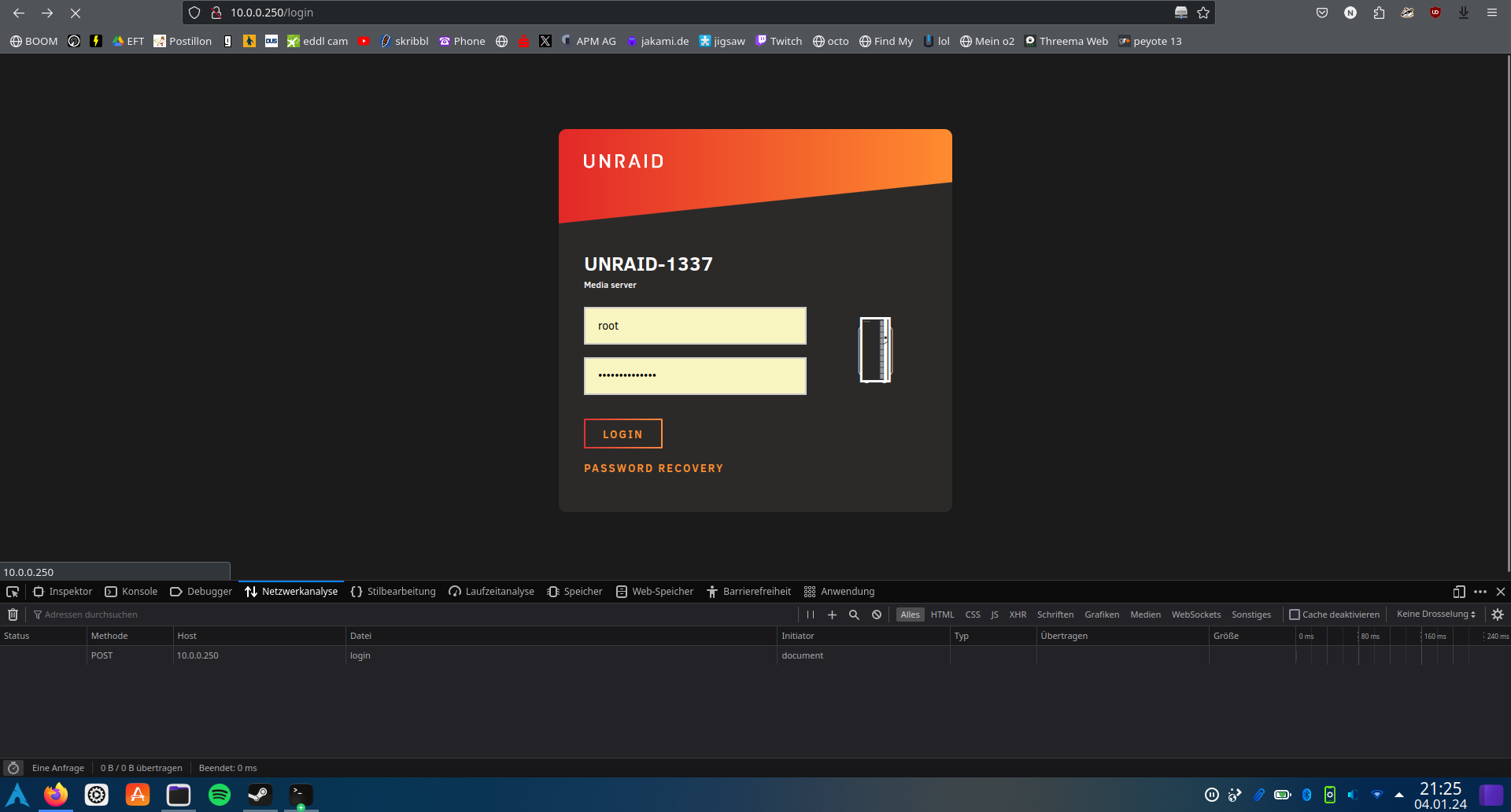

Hey, my Unraid-Dashboard suddenly doesn't want to load. After logging in, the browser just keeps loading over and over. Found nothing interesting in the logs in my eyes. The last uncommon thing, I changed, was adding a "Unassigned Drive" for Torrenting. Dashboards from Dockers and all VMs are fine and up. The USB Stick is maybe 1 Year old and was brand new. So no idea what is causing this. I attached the logs. Which I collected by running "diagnostics" and scp'd them over to my local machine. I just hope, that someone can help me, thanks in advance! ❤️ dashboard: unraid-1337-diagnostics-20240104-2111.zip- HappyPandaX Support Thread

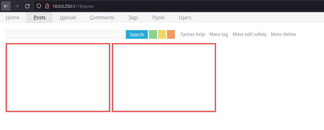

It seems that you have to set privileges to the folder szurubooru-api is using (if not changed then /mnt/user/appdata/szurubooru/data) chown -R 1000:1000 /mnt/user/appdata/szurubooru/data I had the issue where I couldn't see the pictures. One clean install later and the above command solved it for me ^^ 6AM now 7AM Edit: I finally got my last issue solved. Surprisingly, it is also important to change the path for the client to the same folder as the API...^-^ 7AM now, but everything seems to work now ^^- Conbee 2 (Zigbee) USB Stick stopped working in a homeassistant-VM

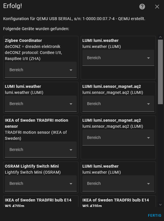

Weird, after a restart and reconfiguring, I got it working, thanks a lot for the hint in the right direction Had "Device Mapping" at first, even tho i needed "Port Mapping"- Conbee 2 (Zigbee) USB Stick stopped working in a homeassistant-VM

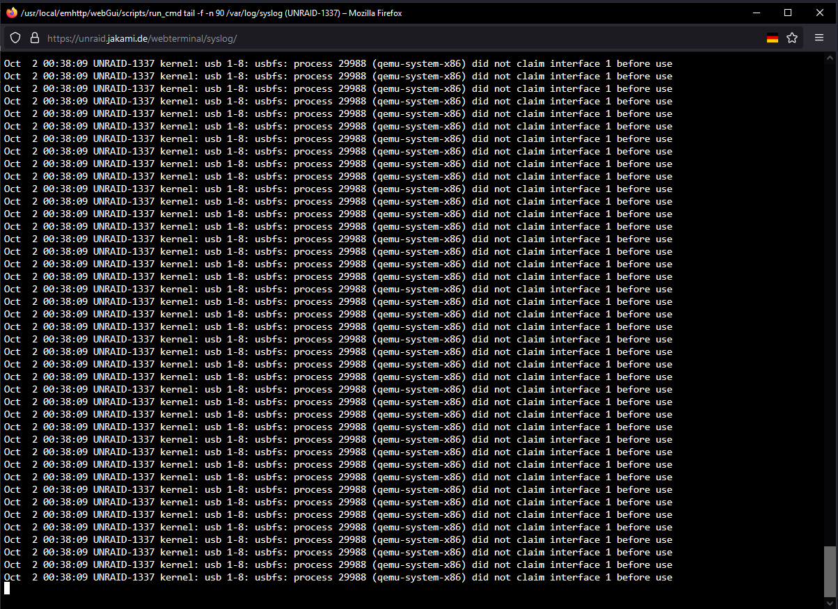

Thanks for your really quick answer. I did the following steps: - Uninstalled "libirt hotplug" - shutdown the vm - removed the usb from the vm - followed the instructions for installing the USB manager and the serial plugin: This sadly leads to these two errors: and in the syslog a huge amount of logs (~20 per second) Edit: Even restarting Unraid didn't fix the issue. But the syslog is not full of this weird log on the second screenshot, but the first one remains.- Conbee 2 (Zigbee) USB Stick stopped working in a homeassistant-VM
