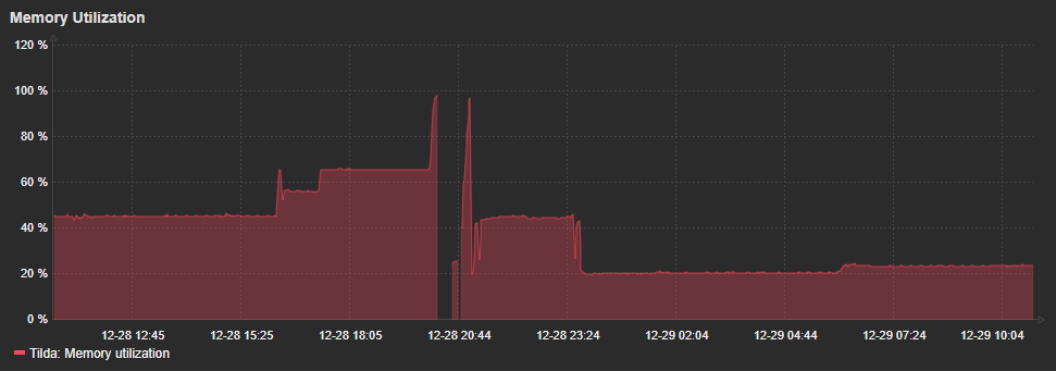

I also have a screenshot of the Memory utilization recorded by my Zabbix Server. The time in the graph, where the gap is, I restarted the server and before that, the zabbix agent on the unraid server was not available.

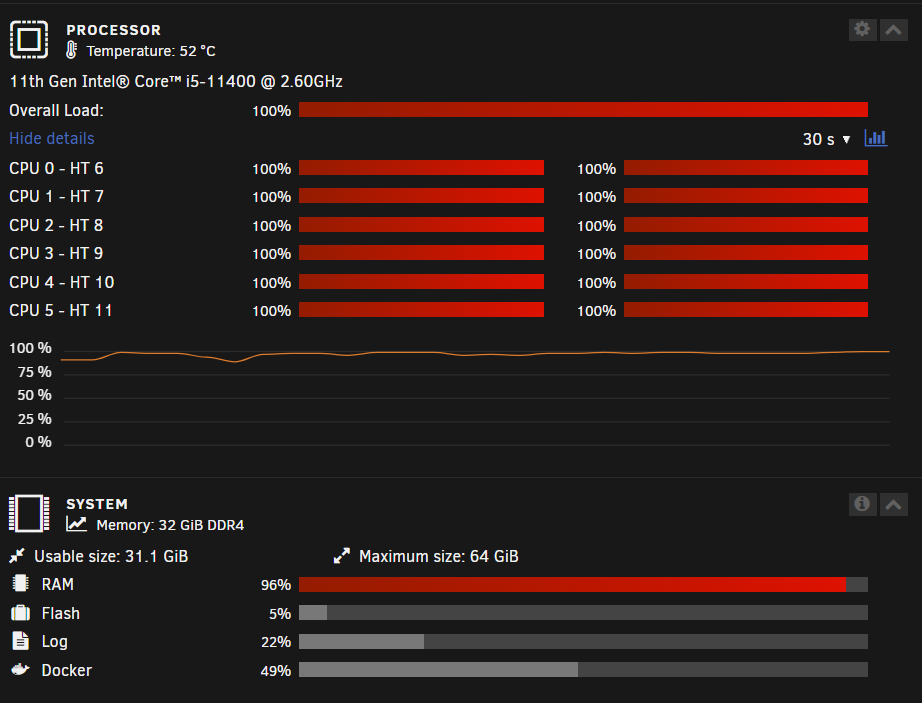

While I was working today on this problem, the unraid host ran into high memory and cpu utilization again (screenshot below). I checked the cpu utilization of the vm again and it was around 50% (4 GB). I shut down the vm and after around 5 minutes, CPU and memory on the unraid host went back to normal.
So I think it's very likely, that the OOM error is related with the ubuntu vm.
