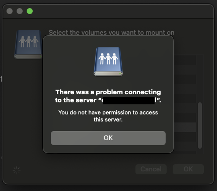

This corresponds with Finder failing to connect, and showing the following error:
There was a problem connecting to the server “SERVERNAME”.
You do not have permission to access this server.

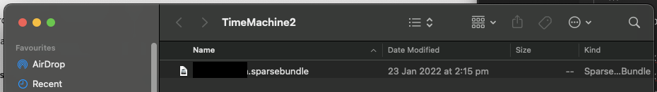

I can connect via Finder 🎉:659098414_Screenshot2023-12-31at5_06_51pm.png.f192b2f6f48d0542cc18114012ad8b88.png
