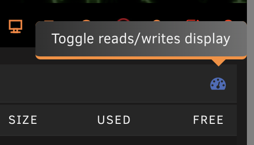

Did you go to unraid main and toggle read/write view on?
This will show the on drive speed rather than the blackmagic disk speedster running via something else.
