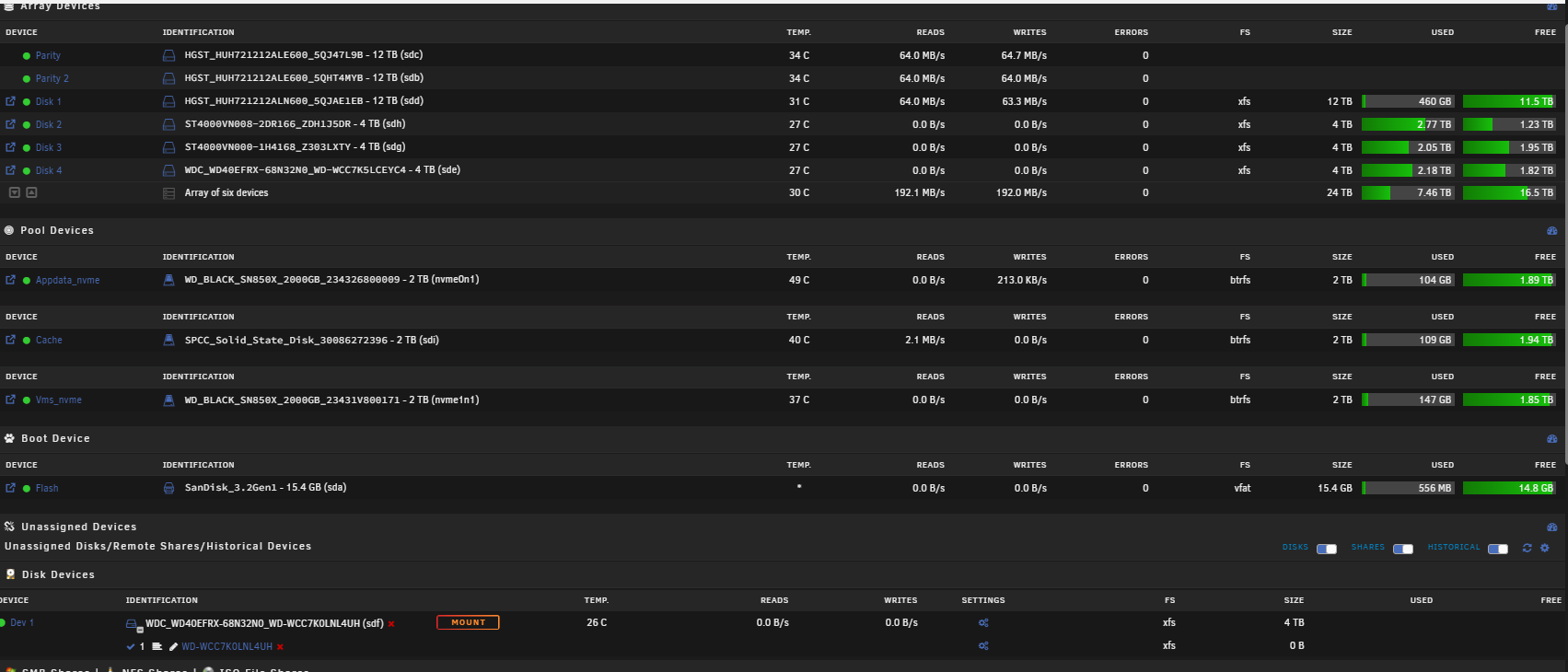

Disk 1 is the disk in question. (the 460GB of data on this drive is my initial attempt at restoring the missing files and can be deleted if needed)
Dev1 is the old disk.
