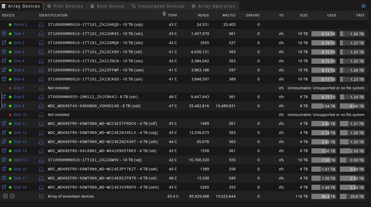

I've managed to get my unraid server into a bit of 'funky' state. I'm not able to add new disk to it. The array is currently up and running just not as 'protected' as i'd like and missing a couple of disks.

When trying to add a a parity disk I get "Too many wrong and/or missing disks!". I'm not able to start the array.

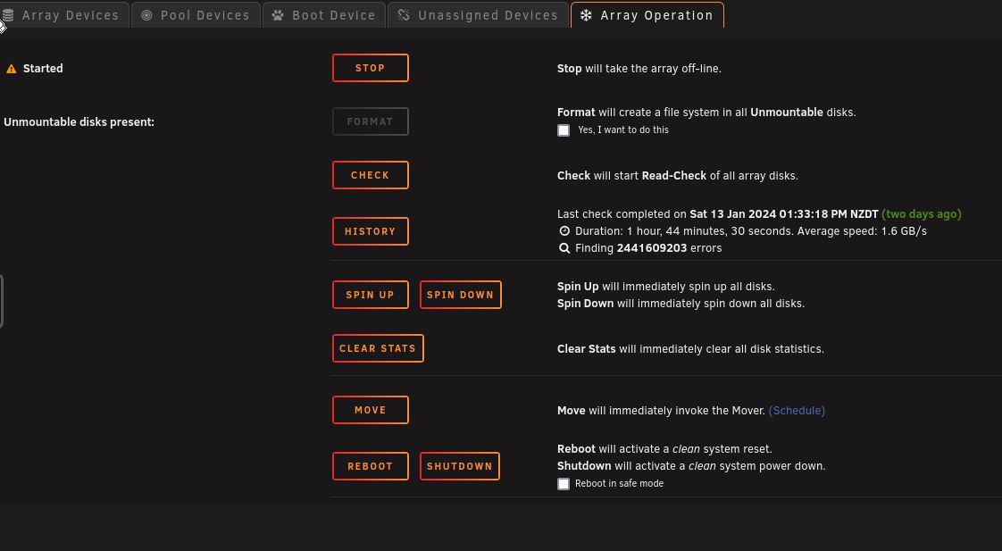

Am I not able to add disk because of the read errors when running a 'check' - Finding 2441609203 errors. I'm unsure how to fix this.
I see a couple of I/O errors in the logs - I had a quick google and found one thing that said this is normal till the disk gets added to the array - unsure if this is true?

Are disk7 and disk10 meant to be present and have data on them?
You have two disabled disks with single parity, so they cannot be emulated, are the old disks still connected to the server?

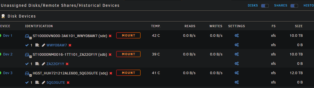

I have 3 unassigned disks I've been trying to add to the array.
12tb to replace the dead parity disk (bringing me back to 2x parity disks)
2x10tb to replace the other to disks
You cannot currently replace any disks, did disk7 or disk10 finish rebuilding on any of the unassigned disks before? If not are the old disks still intact?
Correct, cannot replace any disks. Disk7 & 10 did not finish any rebuild.
