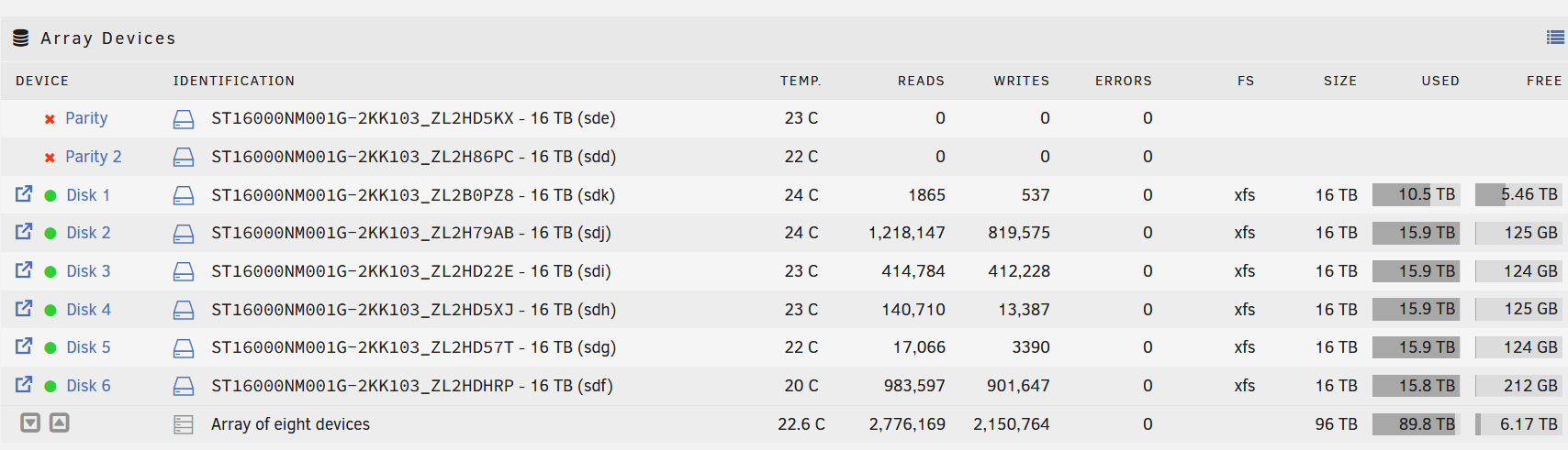

I came home to both parity disks being disabled, with a whopping 2000+ errors on each parity disk.

It is an 8 disk array, raid 6. I am worried for my NAS!
I find it very strange that both parity disks fail together when the array has being going for 2 years. I restarted twice, and both disks remain disabled. This message popped up:

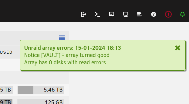

Adnd the 2k errors on each parity disk were zeroed away:

The parity drives will remain disabled until you go through the process of rebuilding them.  If you want to try rebuilding parity back to the same drives then the process is covered here in the online documentation accessible via the ‘Manual’ link at the bottom of the GUI or the DOCS link at the top of each forum page.
The error you posted looks rather like a cabling or power issue so you should check that before attempting any rebuild.    The system’s diagnostics might also give clues as to what was happening.

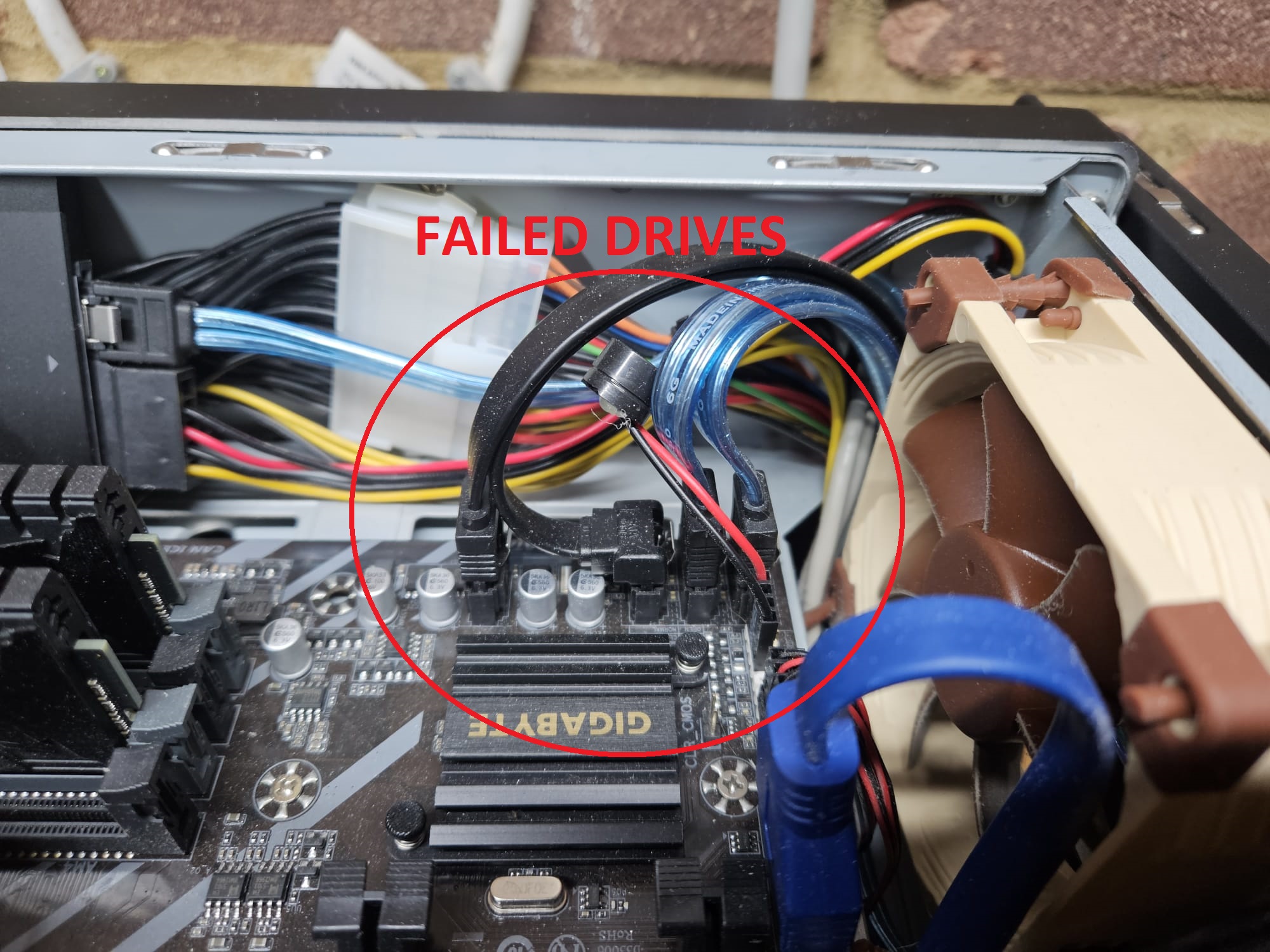

I thought for sure the 4 effected drives were going to be 4 HDD's on one backplane. It wasn't! It was both SSD's (not on a backplane - they go directly into mobo) that form the cache and both parity drives (on one backplane).
Now I will pop of case cover and check if drives share a PCIE card, or plug right into mobo, or both...
Another twist - the four failed drives all plug directly into mobo! The other 6 HDD's plug into the PCIE card:
1669805076_WhatsAppImage2024-01-15at23_21.54_9f3ab4aa.thumb.jpg.07bf63aeba1cead2cf87173dd55308ea.jpg
I'm now thinking power issues. PSU or unstable power coming into PSU.

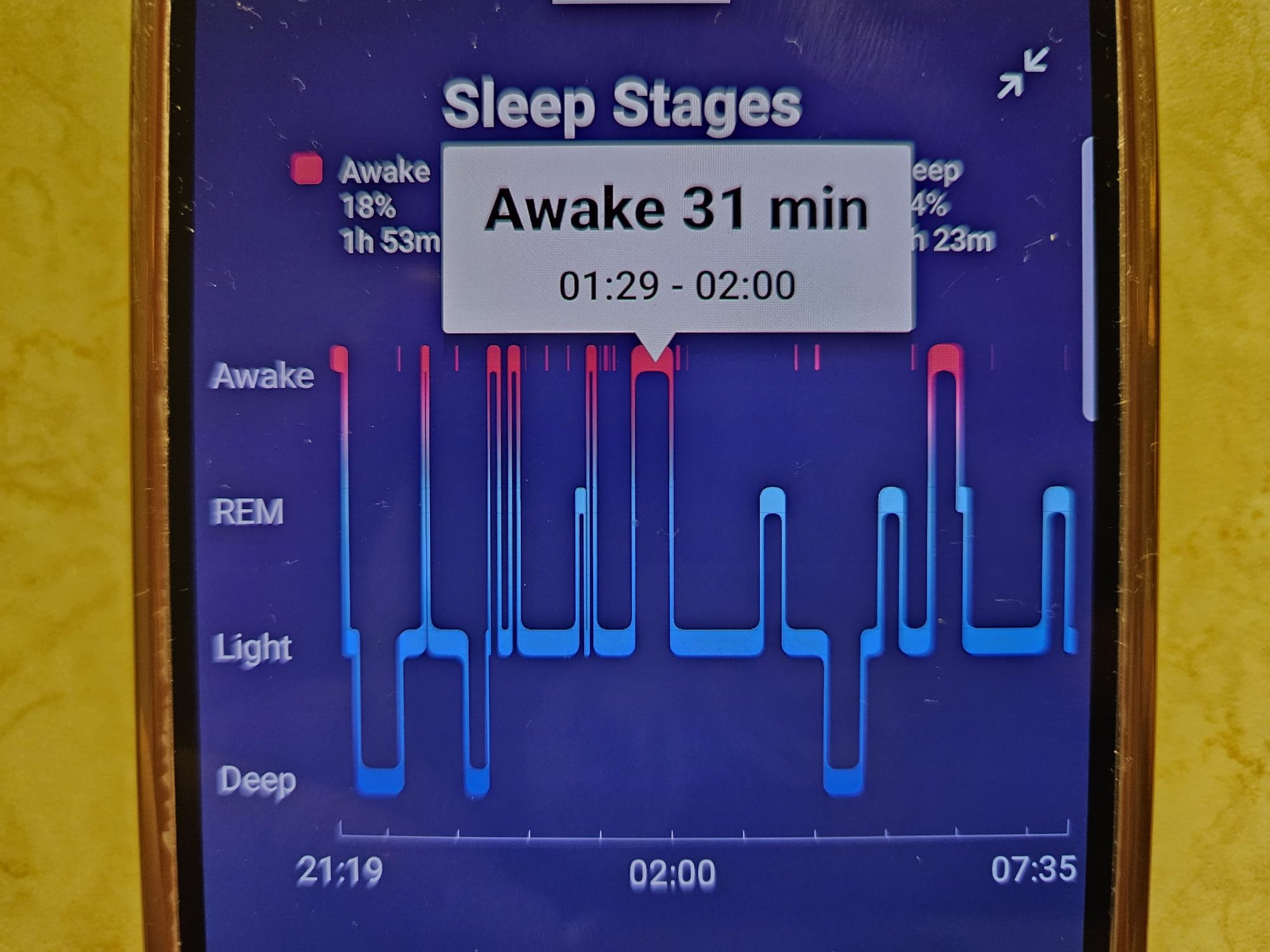

I tell my wife about the issue, and how it happened at 1:31 am. She thinks she went into garage (where NAS is) at that time for midnight weatabix (pregnant). She checks fitbit, the watch that tracks sleep, and confirms she did indeed!
917760270_WhatsAppImage2024-01-15at23_30.42_a5099c71.thumb.jpg.2c3d5df2cf2ae383bceef2f190c8ba4a.jpg
We had an electrician in a week ago who installed lots of automatic lights in garage...
I'm now thinking the new light set up isnt playing nice with the NAS. I will leave them always on for now, so no power spikes. I will look into how it is wired, and if I can get hardware to monitor power supply to NAS.
