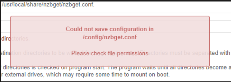

so i installed nzbget-ng from tab Apps and run it. as i want to save changes in the settings i receive the following error and i dont know what to to, or were to find the path to solv the problem.
does anyone know what i can do?
What's your installation path location? Have you tried using the default?
Your current UNRAID config appears to deny you write-access to /config/

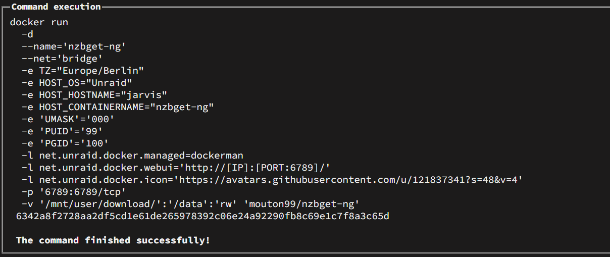

i just changed this path to my download folder on installation of the docker:
i dont know were i can find the /config folder.

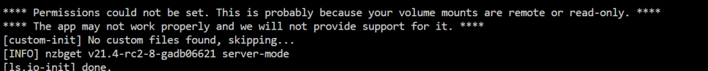

i found this we clicking on the docker in dashboard and then on log:

seems i get it wrong, so this is what you wanted?
I don't use that container, but it seems the docker template doesn't actually include a volume mapping for /config. Most containers provide a default for this with a host path in your appdata.
