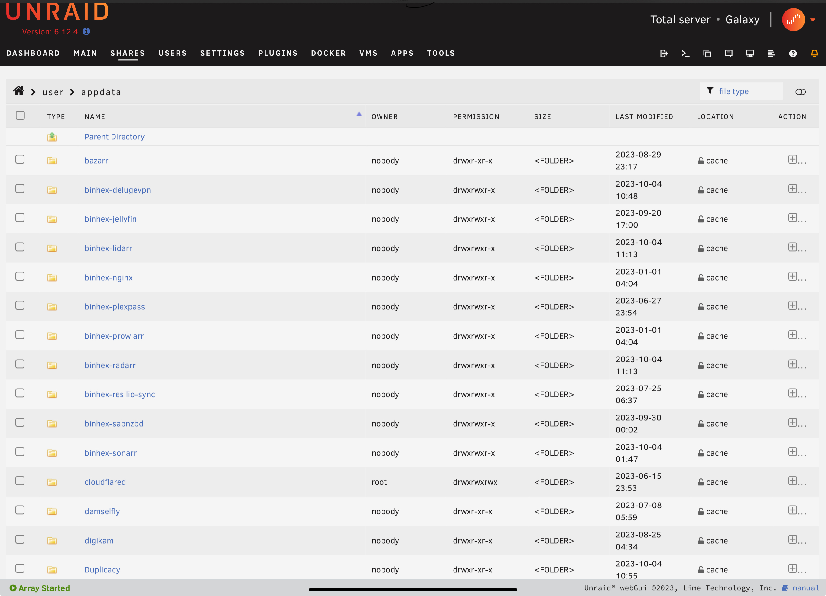

Appdata seems fine, but there are no dockers. Is there a way re-add the dockers, but capture the configuration from the existing appadata files?

The configuration isn't in the appdata. Like all other settings in your Unraid webUI, the templates for reinstalling your containers is on the boot flash in the config folder.
https://docs.unraid.net/unraid-os/manual/docker-management/#re-create-the-docker-image-file
https://docs.unraid.net/unraid-os/manual/docker-management/#re-installing-docker-applications

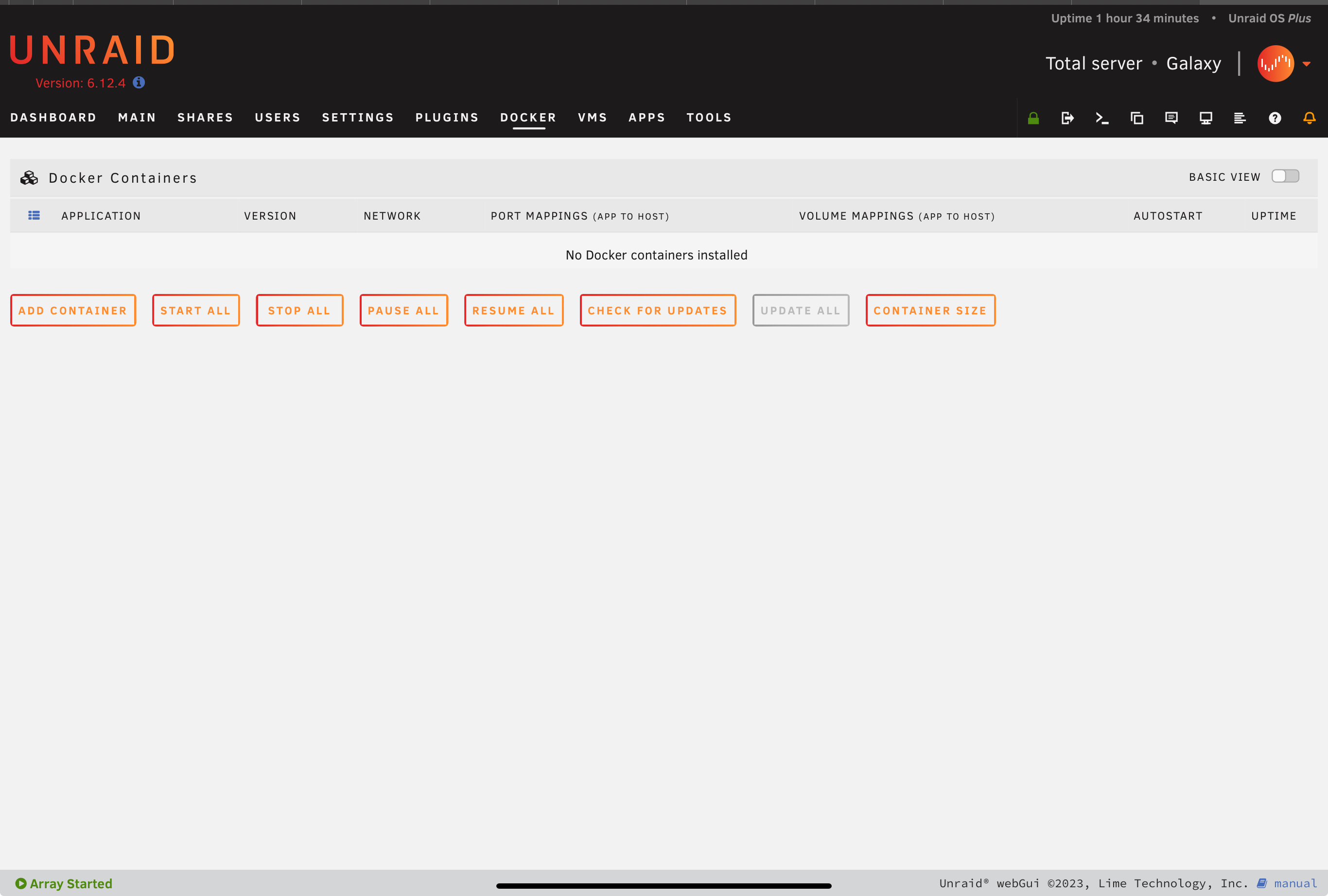

Given, I am not using my backup usb as it would not boot, I am using a fresh unraid install. So it doesn’t have my old containers.
Do you think I could copy the docker templates from the unbootable usb? If so where are the templates and associated files located?
if it Docker.man and docker folder within the plug-in folder? Or should I copy over more?

See if you can copy /boot/config/plugins/dockerMan/templates-user, other than that you also need the appdata folder, that should still be on a pool (or array), you can then recreate the docker image and restore the containers from Apps.

Ok, I have made progress.
i have all my dockers back.

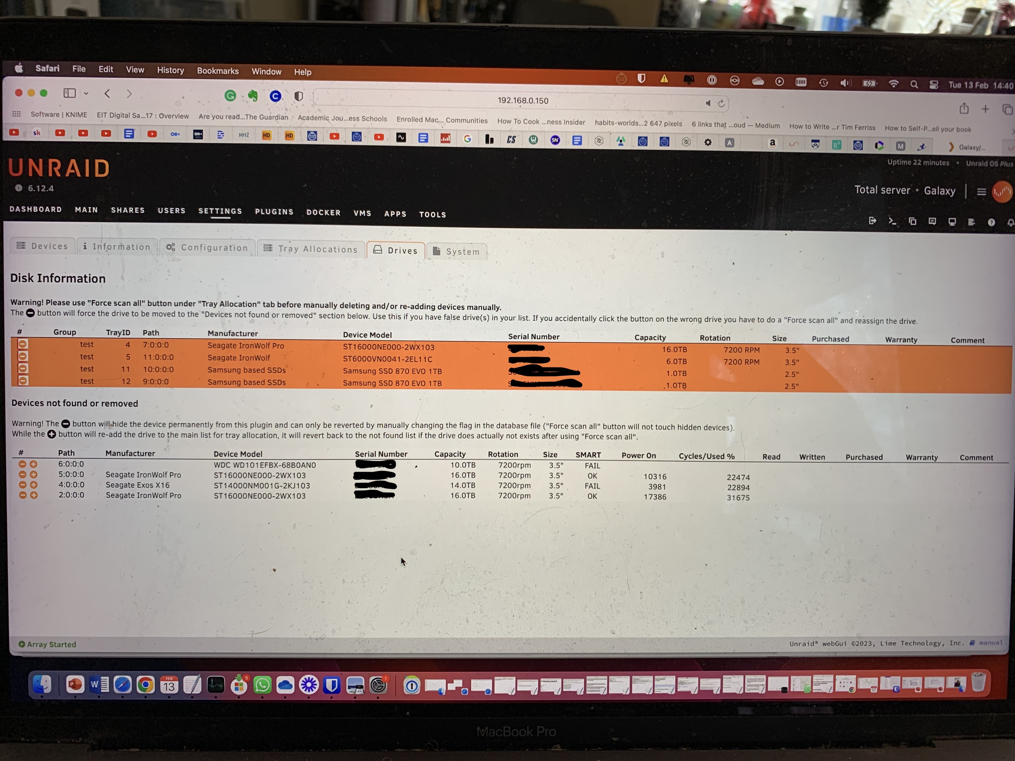

OK here is a bit more info.
I added the Disk Location plugin.
The two 16 TB Seagate drives (one is data and one is the parity)  in the Not Found Section passed the SMART test, so they have power and they both have new SATA cables as well. However, they both don''t show up in the array (or as unassigned drives).
Any ideas on how to get them to appear? This is last issue from rebuilding. What I am I missing?

Post the diagnostics and tell us which controller those disks are using.
P.S. when needed you can take screenshots, much easier and clearer than a photo.

7 minutes ago, Profezor said:
I don't know how to find the controller information
Open the case and check were the SATA cables are connected, to the onboard SATA controller or to the addon Asmedia controller.
