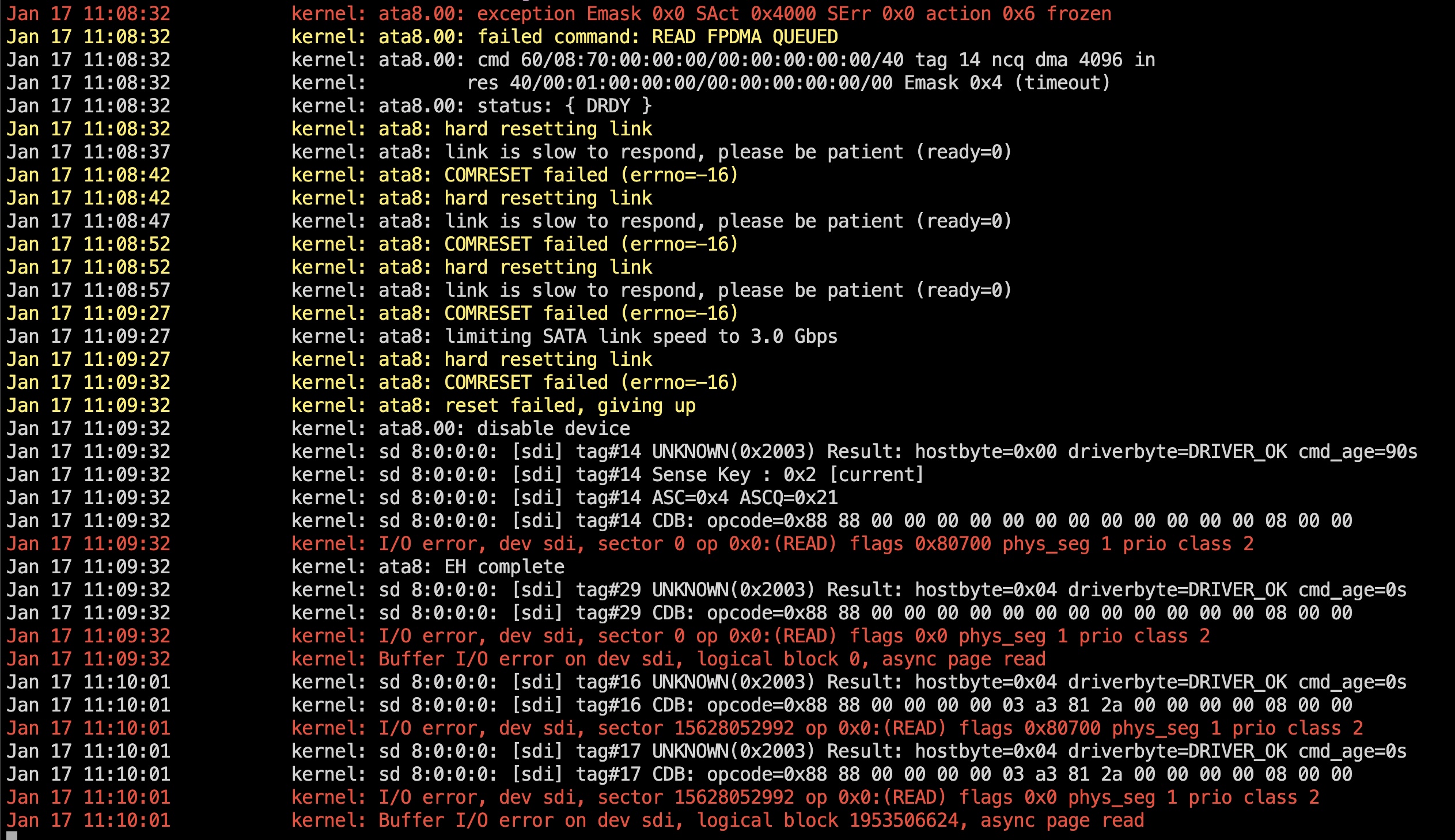

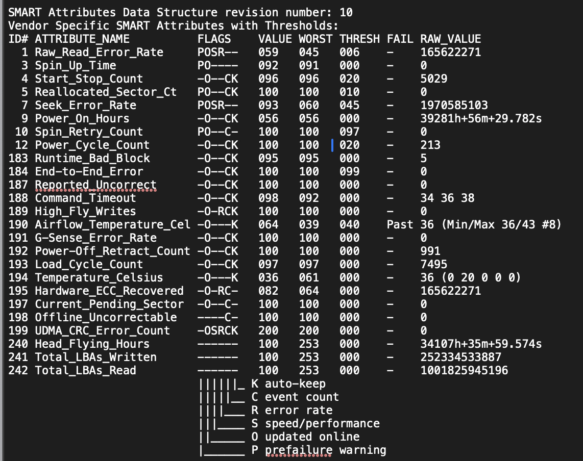

1) After a reboot, I am able to successfully run a quick SMART test and everything passes (see attached image #1).

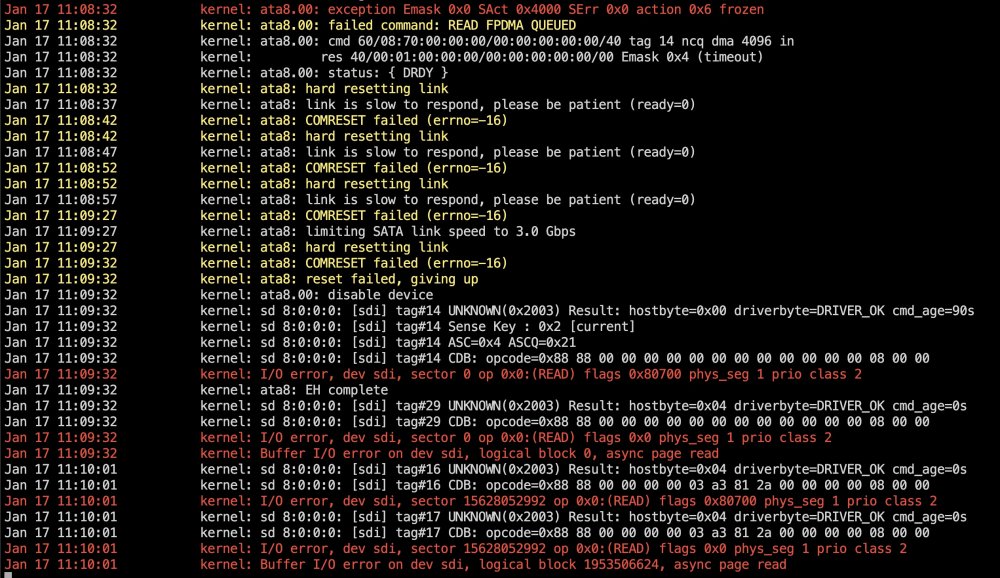

2) However when I try to run an extended SMART test, the disk disconnects and becomes unreachable after about 15 minutes. In order to reconnect to the disk, I have to reboot. A screenshot of the syslog is attached as image 2849792634_Screenshot2024-01-17at11_10_51AM.thumb.jpg.e0d90adb0a38a75c0bbb93244b0a607d.jpg

Quick SMART test does not test most of the disk - you need the extended version for that.    Not sure why it is disconnecting though as the test runs internally to the drive and does not involve the host.
Try disabling spin down on the disk and see if extended test will complete
The disconnect occurs during the extended test. The syslog reports and I/O error and the drive shows up as "disabled" in the array. So I interpretted this as the drive "disconnecting" but maybe I am using the wrong word? The drive still shows up in unraid but is not accessible.

The drive had dropped offline when the diagnostics were taken do there is no SMART report for it included.
