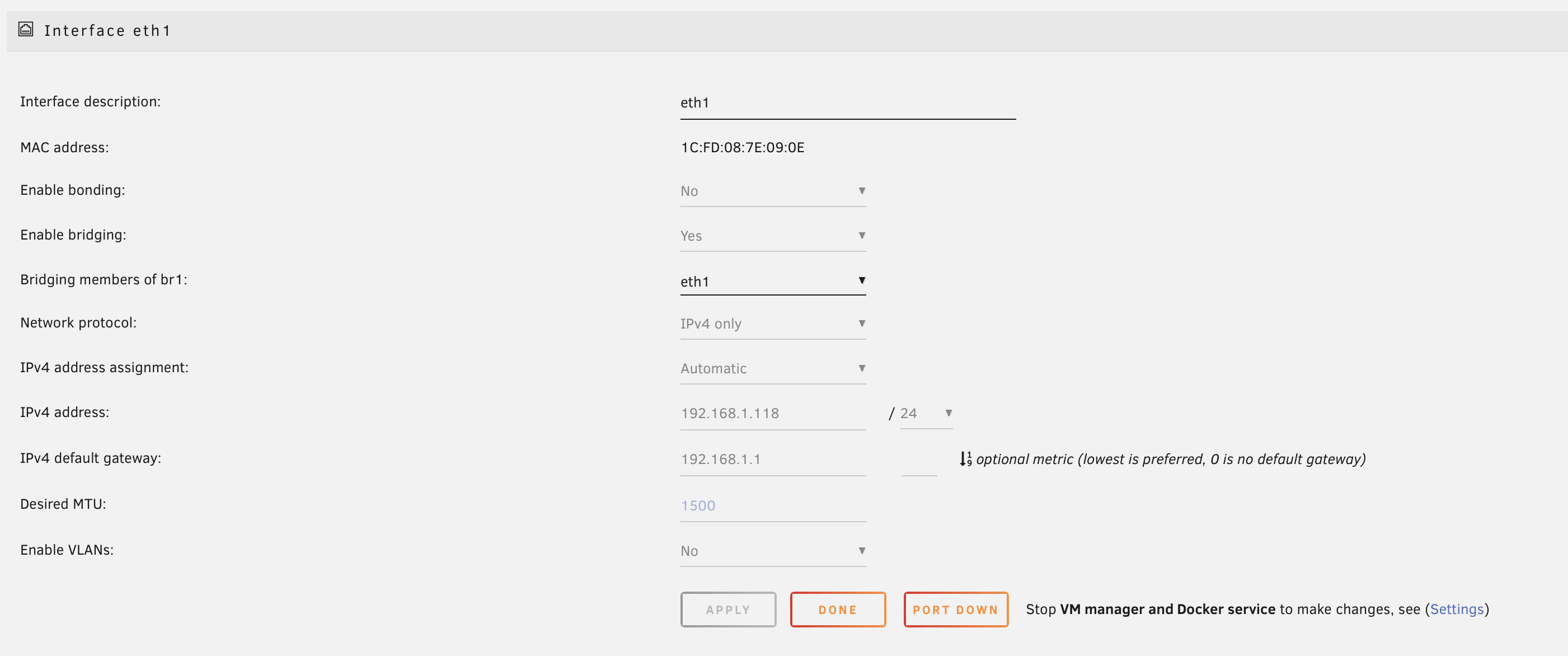

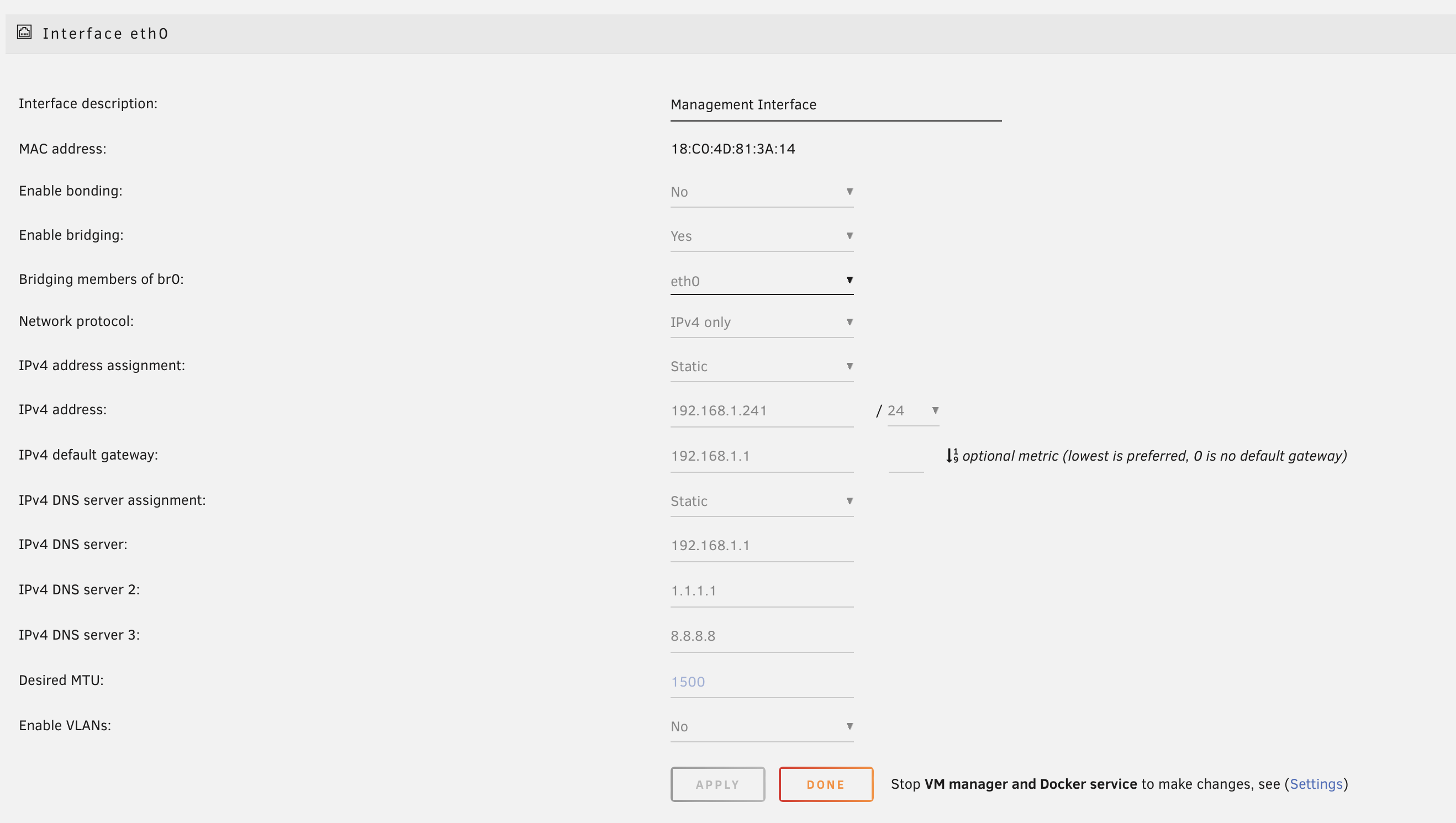

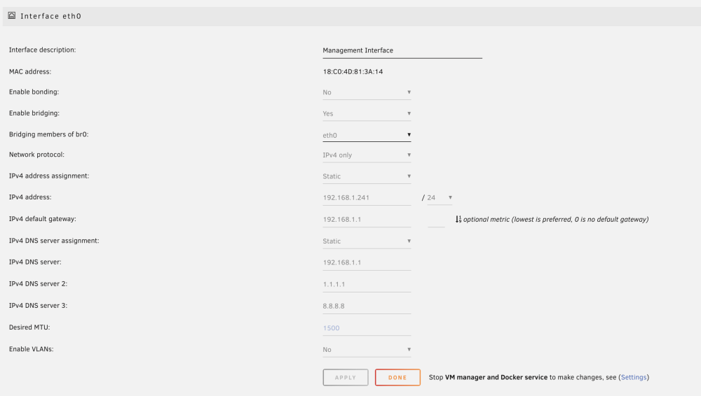

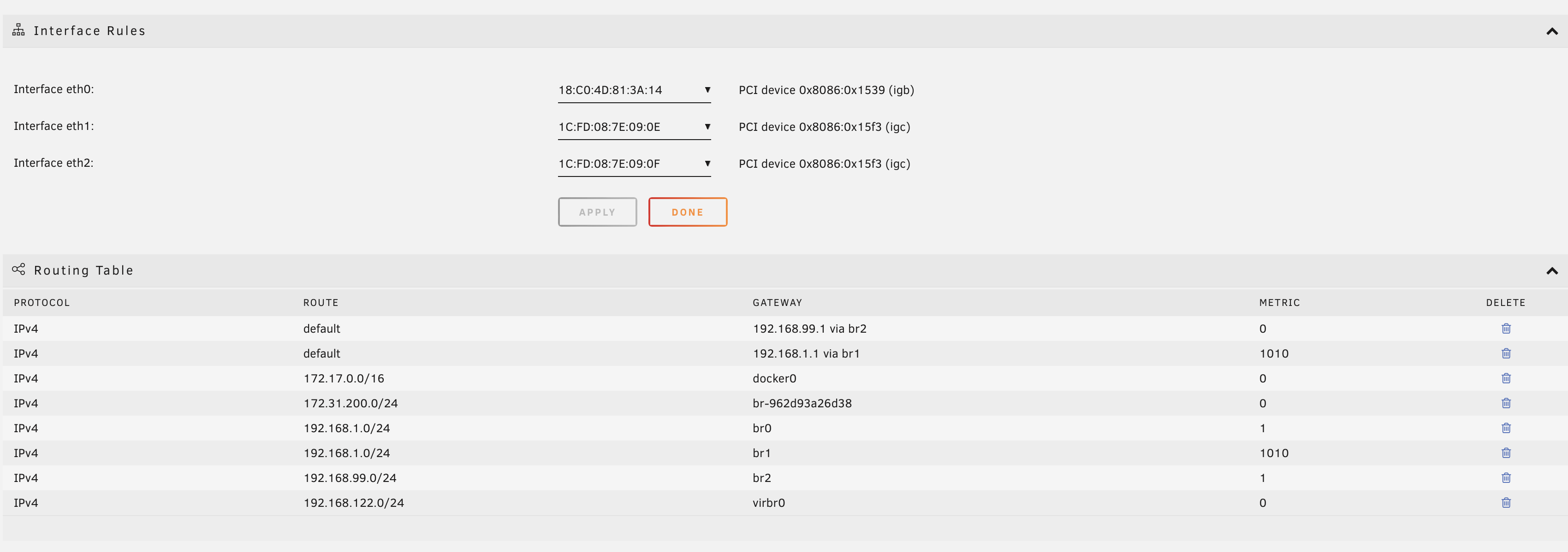

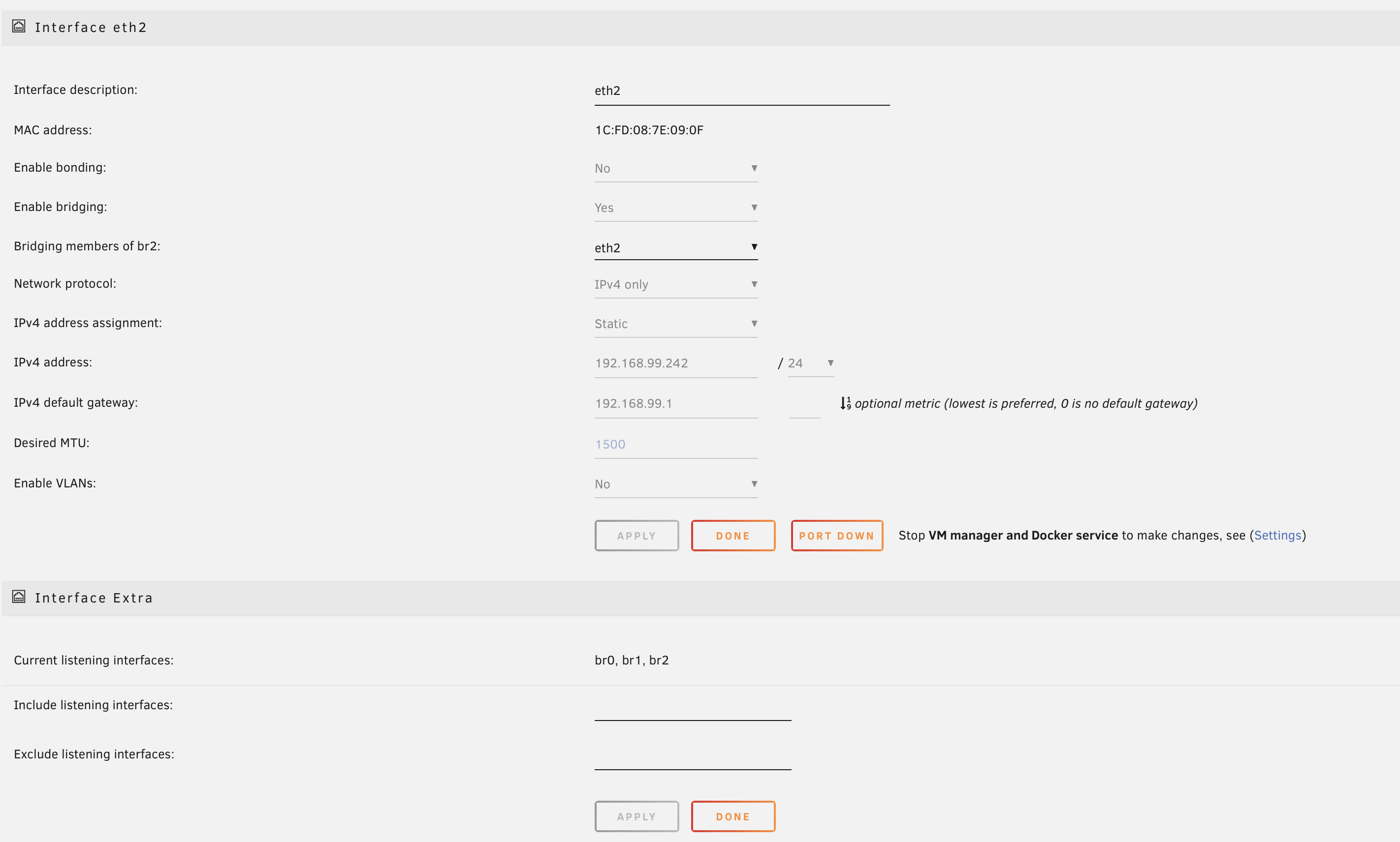

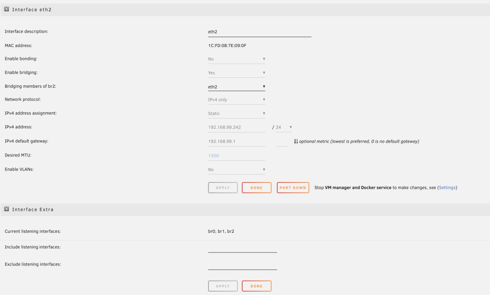

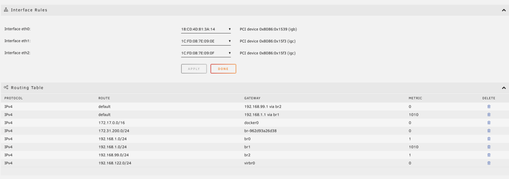

A few weeks ago I added an Intel I225-V dual NIC to my UNRAID server. Right around the same time i added Pihole to my server. Right after that I would notice that every 2-3 days I would lose all connectivity with my server and would need to force a restart. I have been trying to troubleshoot for a while now on both the Netwrok Settings and Pihole configuration and have thus come up short.
Would someone be able to help me? I know it is something stupid simple that I am missing. Below are screenshots of my network configuration and atached are my logs.

you are assigning 2 different default routers. This is usually wrong. Check which one is the real gateway and delete the entry from the other nic.
Your setup leads a random choice to pick the wrong one and then losing all internet connections.
Sorry for the late reply. I tried this approch and now only have one default gateway setup. Unfortunately, the server ran for just around 3 days, then stopped responding again, thus trigger another forced power cycle.

Your Pihole was docker ? Where it put to, br0, 1, 2 ?
Don't set same subnet to different interface.
My pihole in this configuration is tied to BR2.
Ahhh that was my mistake, I set two interfaces to the basem subnet without bonding them! Silly mistake. I will try this out and let you know if this fixes it.
