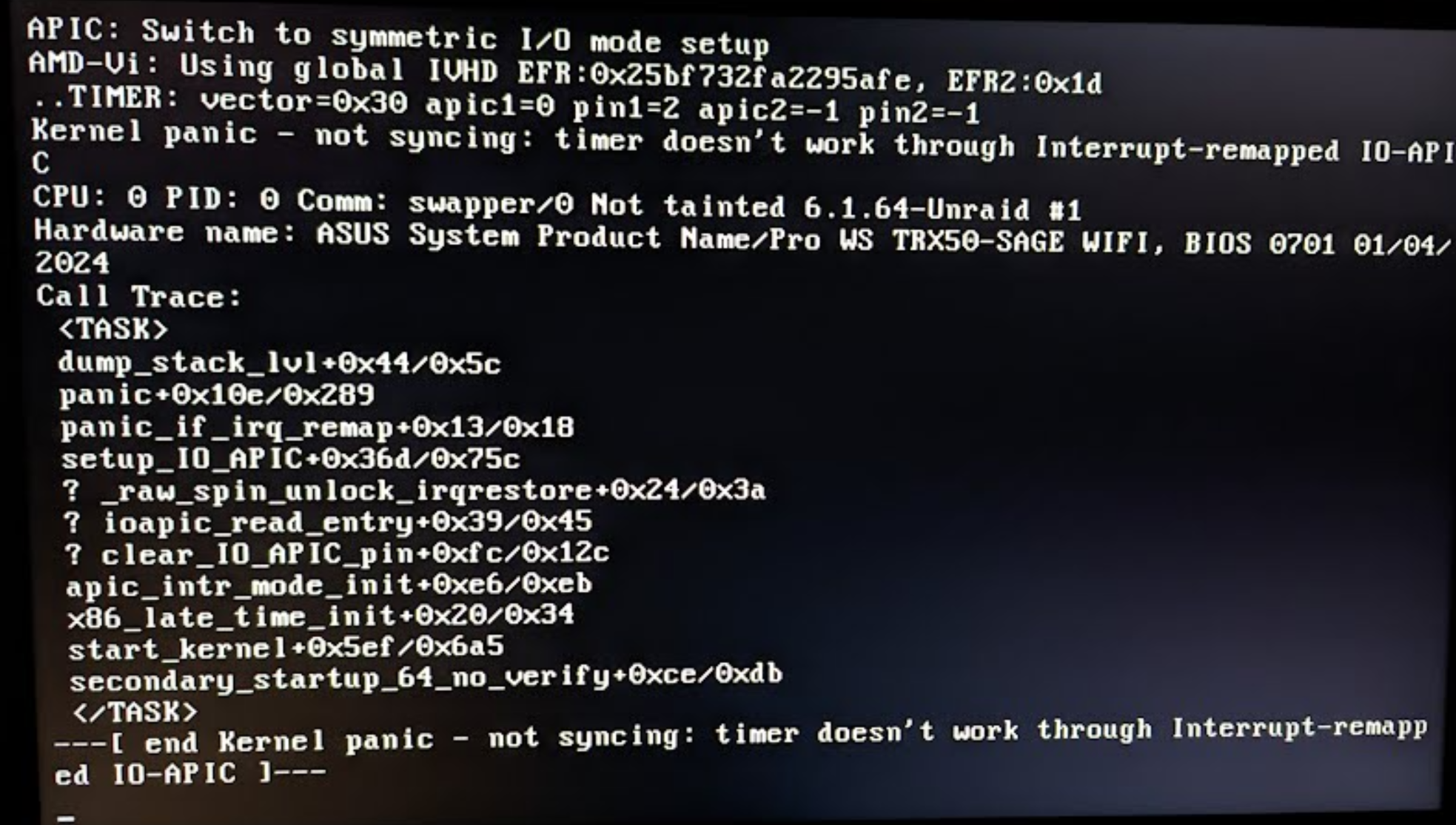

Here is the Kernel panic I'm receiving and I haven't been able to get past it messing with the BIOS.
Kernel panic - not syncing: timer doesn't work through Interrupt-remapped IO-APIC
Here are images as I can't copy/paste.

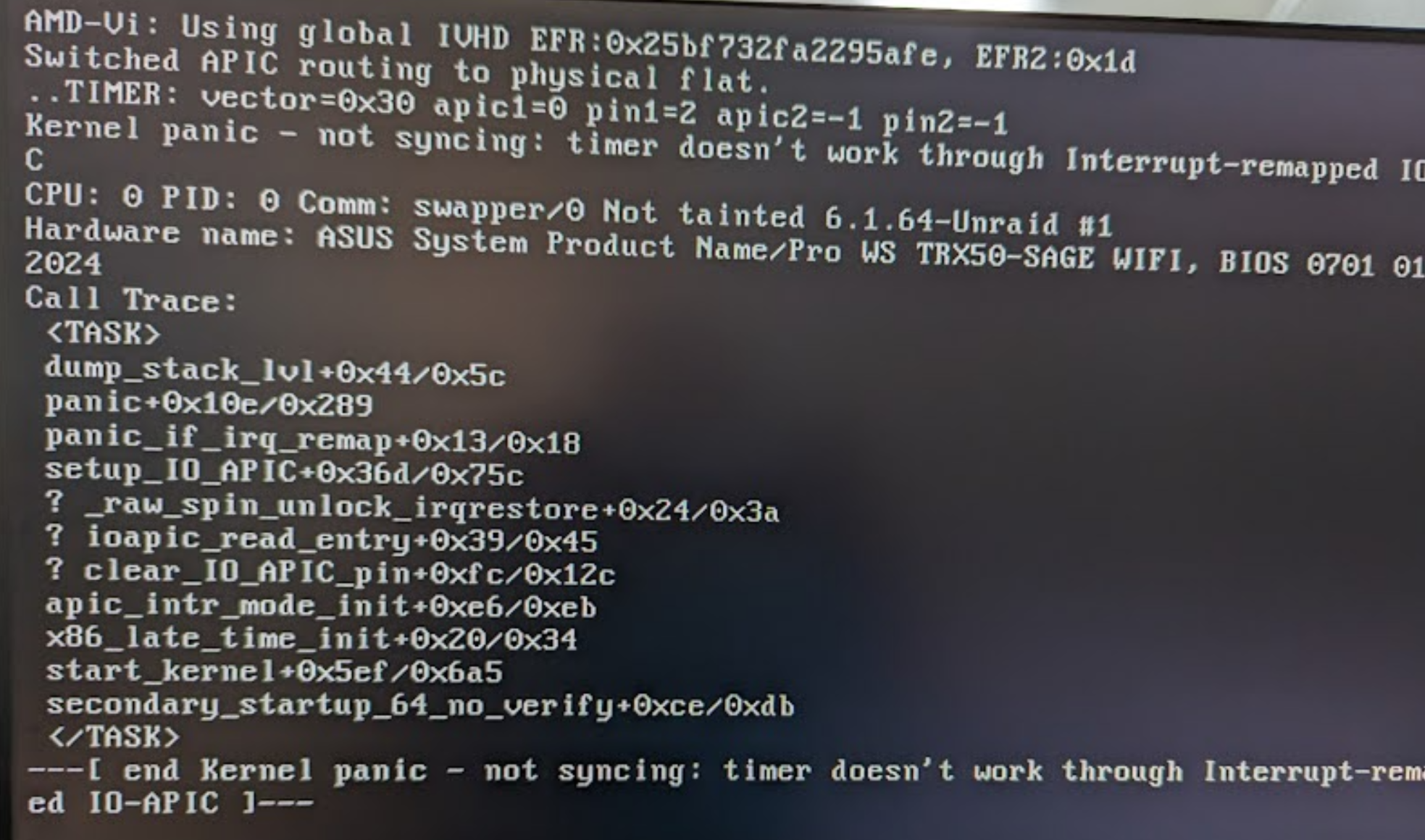

After messing with Local APIC Mode I got the similar kernel panic:

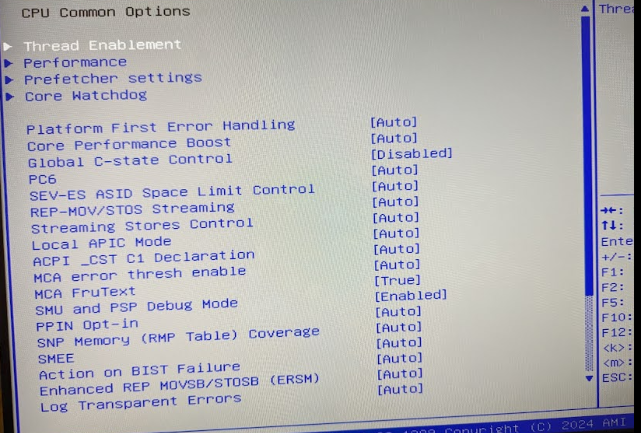

Changing Local APIC Mode to 3 different settings (dynamic vs physical flat as seen in images).
Modifying various CPU settings. Here is what is available.
