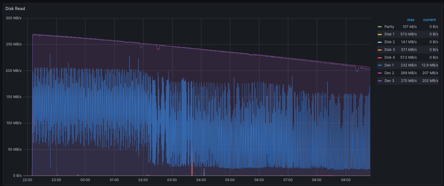

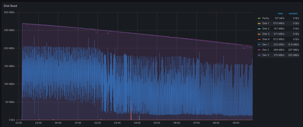

  14. I'm just going to RMA the drive. Thanks for all the feedback everyone. 🤐
  15. This is what the 12 hour looks like for these drives in post-read. Note, I precleared 3 at a time so the first set all went well.
