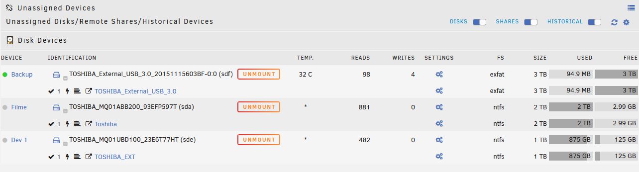

Hallo Zusammen.
Ich bin noch ein Beginner bei Unraid. Wie auf dem angehängten Bild zu sehen habe ich 3 Platten unterschiedlicher Größe als Unassigned Devices an meinen Unraid Server zu hängen. Es handelt sich bei allen Platten um USB-Platten. Zwei Platten werden nach 15 Minuten herunter gefahren (spin down), die Backup Platte nicht. Ausserden verstehe ich nicht weshalb bei der Platte 2 Partitionen angezeigt werden.
Hat jemand eine Ahnung, weshalb diese Platte nicht heruntergefahren wird?
Eine Frage am Rande, hat jemand eine Übersicht was sie Symbole bedeuten?
Danke euch schon mal für eine Antwort.

Can you spin the disk down by clicking on the orb to the left of the 'Backup' text?
When I click on the ball next to the text, two moving green arrows appear. Then the green ball can be seen again.

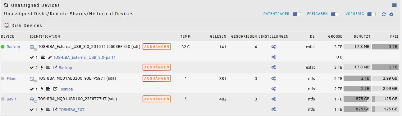

The two partitions were created by another software.  UD creates one partition when formatting a disk.
I formatted the disk on a Windows PC. No matter whether as exFat or as NTFS, you can always see 2 partitions. I also formatted the other disks on WinPC. There is only one partition there.

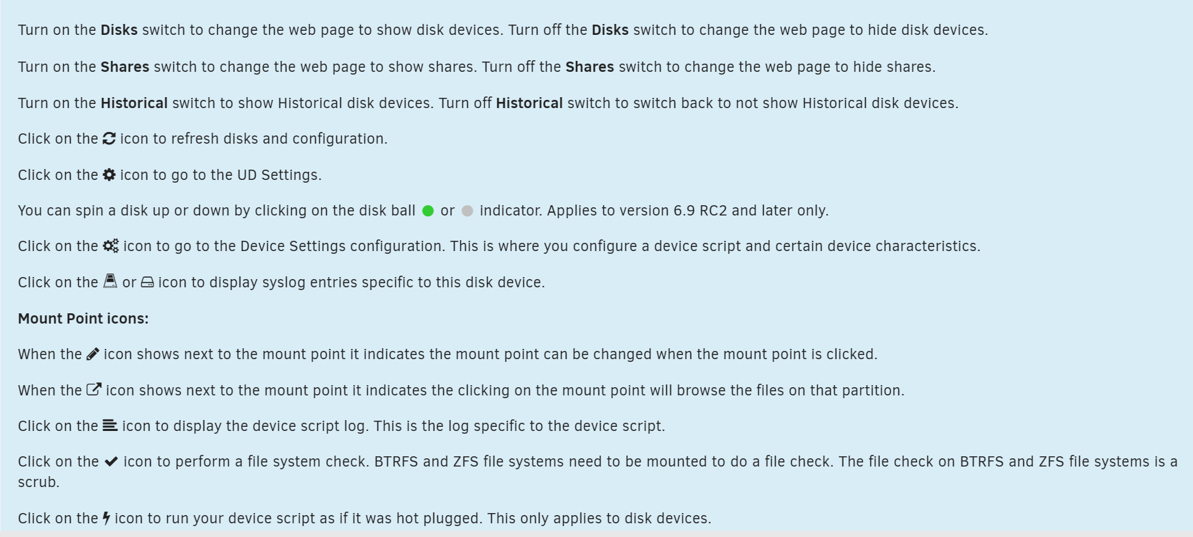

On my system I don't get any info when hovering over these icons. They are not explained in the Help '?'.
These are the icons in question from the first post in this thread:

I have since formatted the drive with Unraid and now it only has one partition. But spin down still doesn't work.

They are diasbled.  That's why you don't get the tooltip.  Go to the disk settings (three gears icon) and create the default script.  The icons will then show tool tips.  You can only create a script when the device is unmounted.
If you can't spin it down manually with the orb next to the 'Backup' text, the drive doesn't spin down.  Some USB drives won't spin down.
You can always detach the drive and power it down.

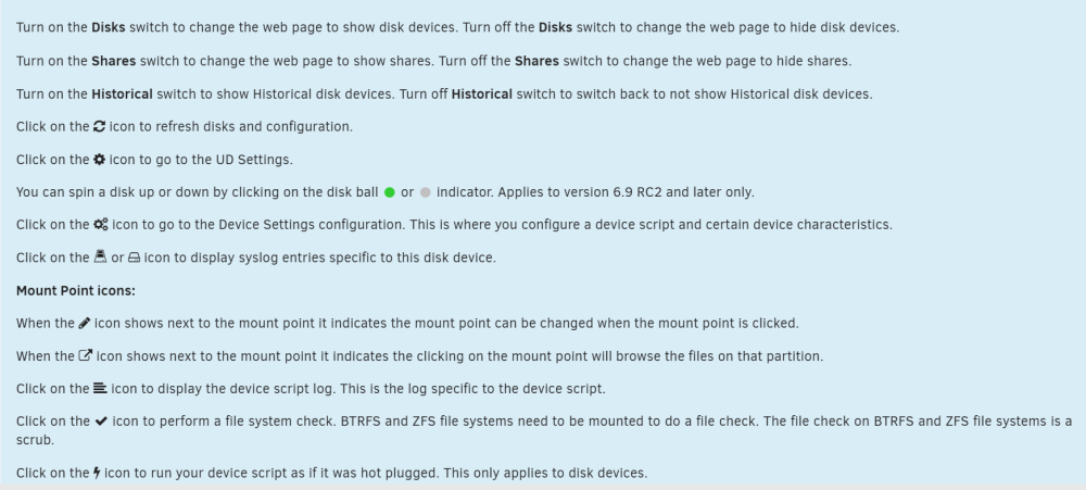

Yes, that's true. I encourage users to use the help page always. If it doesn't bother you, just add these icons to the help page. Won't hurt.
1 hour ago, dlandon said:
Like this?
Perfect. Thank you very much.
