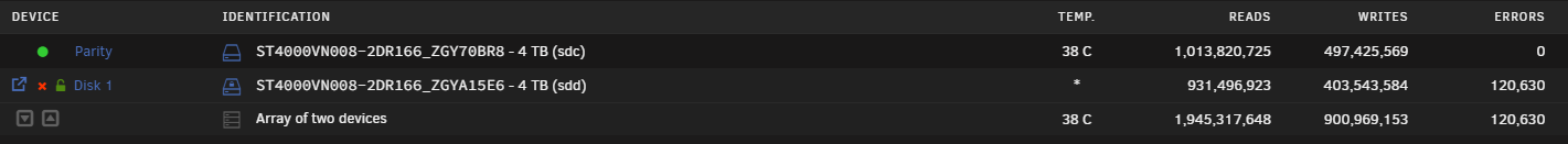

My disk 1 has failed on my backup server and the parity is still good.
Can I just make my parity my disk 1 and forget about redundancy all together on this server. Is there a way to do that?

You can do a new config and assign parity as disk1, but I would recommend posting the diagnostics first, disk1 may have dropped, not failed.
2 hours ago, trurl said:
Shutdown, check connections, reboot, post new diagnostics
Will do, won't be able to get to it physically in a couple of weeks. Keep posted.
Well, emulating a single data disk from parity isn't much different than having a single data disk without parity.

Finally the disk did fail. I kept trying to rebuild it and preclear it. I swapped the SATA cables and port and still same issue. I ordered a replacement. Thanks for all the help fellas. Learned a lot.
