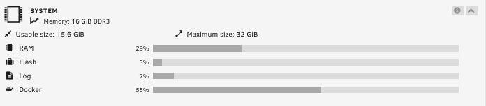

My first instinct is to review my RAM memory usage, screenshot below.
And my overall storage array still have 18T of space remaining.
