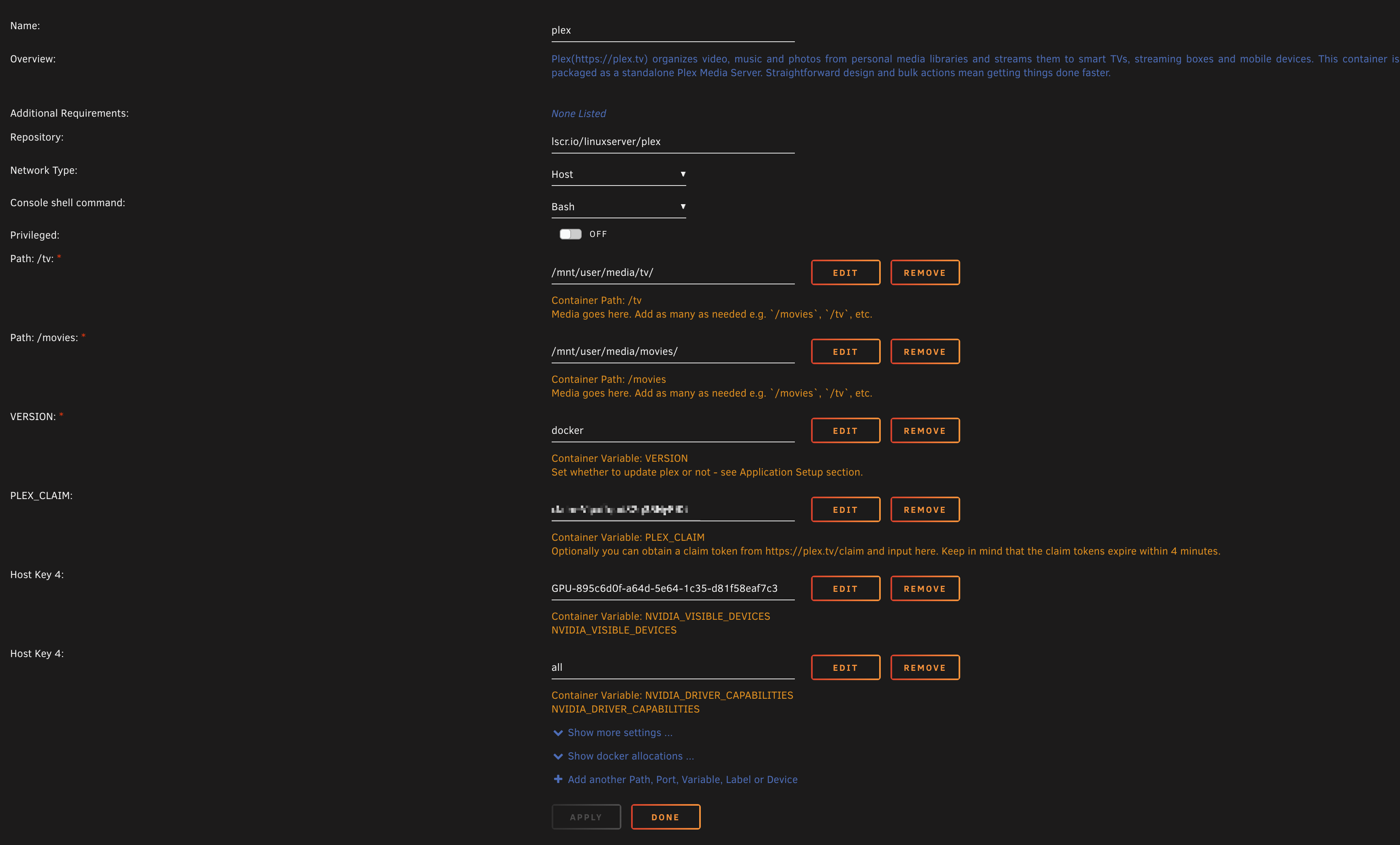

This is my plex docker:
Extra Parameters: --runtime=nvidia --mount type=tmpfs,destination=/tmp,tmpfs-size=20000000000 --no-healthcheck

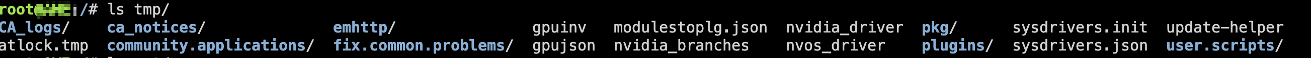

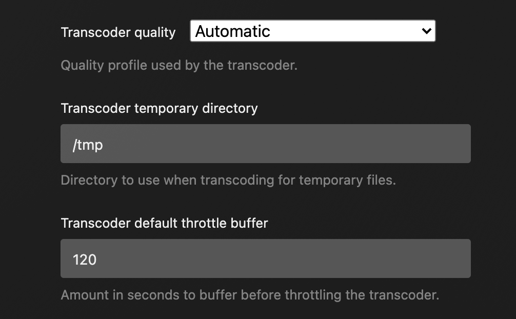

GPU transcoding works fine but I can't see where it's going to. I went to /tmp and can't see a transcode folder?
1736990953_CleanShot2024-02-02at14_12.59@2x.thumb.png.52eb174c8730d9d091e83ade2c4fafe6.png
Any help would be appreciated! Thank you!

24 minutes ago, itimpi said:
Cannot see any entry in the docker settings that maps the /tmp location that you have set at the Plex level to a location on the Unraid host (e.g. mapped to something like /tmp/plex) so the transcode temporary file will be inside the container.

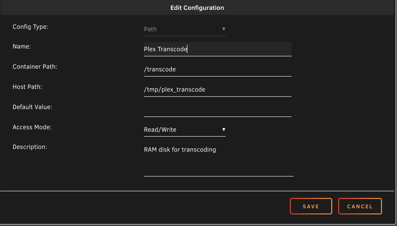

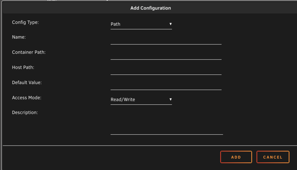

Actually I think I figured it out. I added a new path. Container Path: /transcode , Host Path: /tmp
and it shows this:
1224450281_CleanShot2024-02-02at17_34.24@2x.thumb.png.e51779066c15105b2f095dae7057837c.png
looks to be correct right?
Link to comment
and it shows this:
I would suggest mapping it to a folder with /tmp as otherwise Plex may end up removing files under the /tmp path at the Unraid level that belong to other applications.

Simply mapping transcoding  to /tmp at the Plex level inside the container does NOT map it to RAM, but to a location inside the docker.img file.     What you would normally want is something like /transcode at the Plex level mapped to /tmp/transcode at the Unraid level since at the Unraid level /tmp IS in RAM.

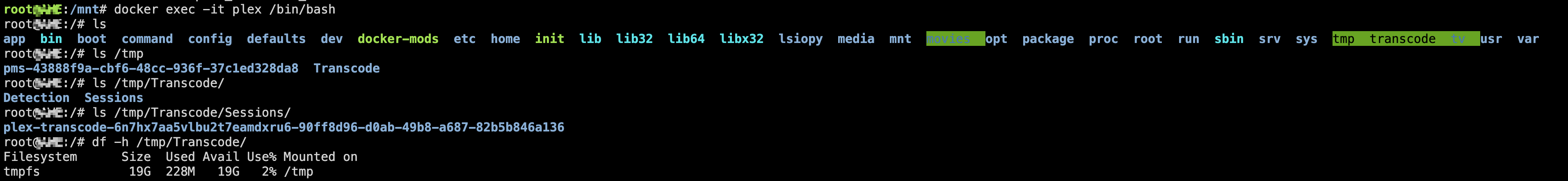

I think I understood? When I read your previous post I immediately changed the path config to this. As well as in temp directory in plex transcode settings to /tmp/plex_transcode, just to isolate it from the rest of /tmp
Thing is, it shows it's mounted on tmpfs inside the container, as you've said. I can also see /tmp/plex_transcode at unraid level but nothing inside it when transcoding, only inside the container whilst I'm transcoding. Shouldn't this be theoretically correct and safe (as it's nested in its own folder)
1106584881_CleanShot2024-02-02at17_56.21@2x.thumb.png.53452415a84d5253f3bcc795eed9019f.png
unraid level:
root@xx:/mnt# df -h /tmp/plex_transcode/
Filesystem      Size  Used Avail Use% Mounted on
rootfs           16G  1.2G   15G   8% /
inside plex container:
root@xx:/# df -h /tmp
tmpfs           9.4G  172M  9.2G   2% /tmp
Link to comment
29 minutes ago, itimpi said:
With those settings at the container level, you want to tell Plex to transcode to /transcode.   The docker system will then redirect that to /tmp/plex_transcode at the Unraid level.
Perfect! Thank you so much!! That works!

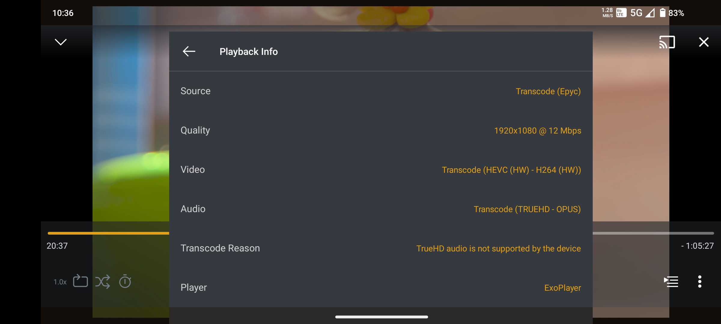

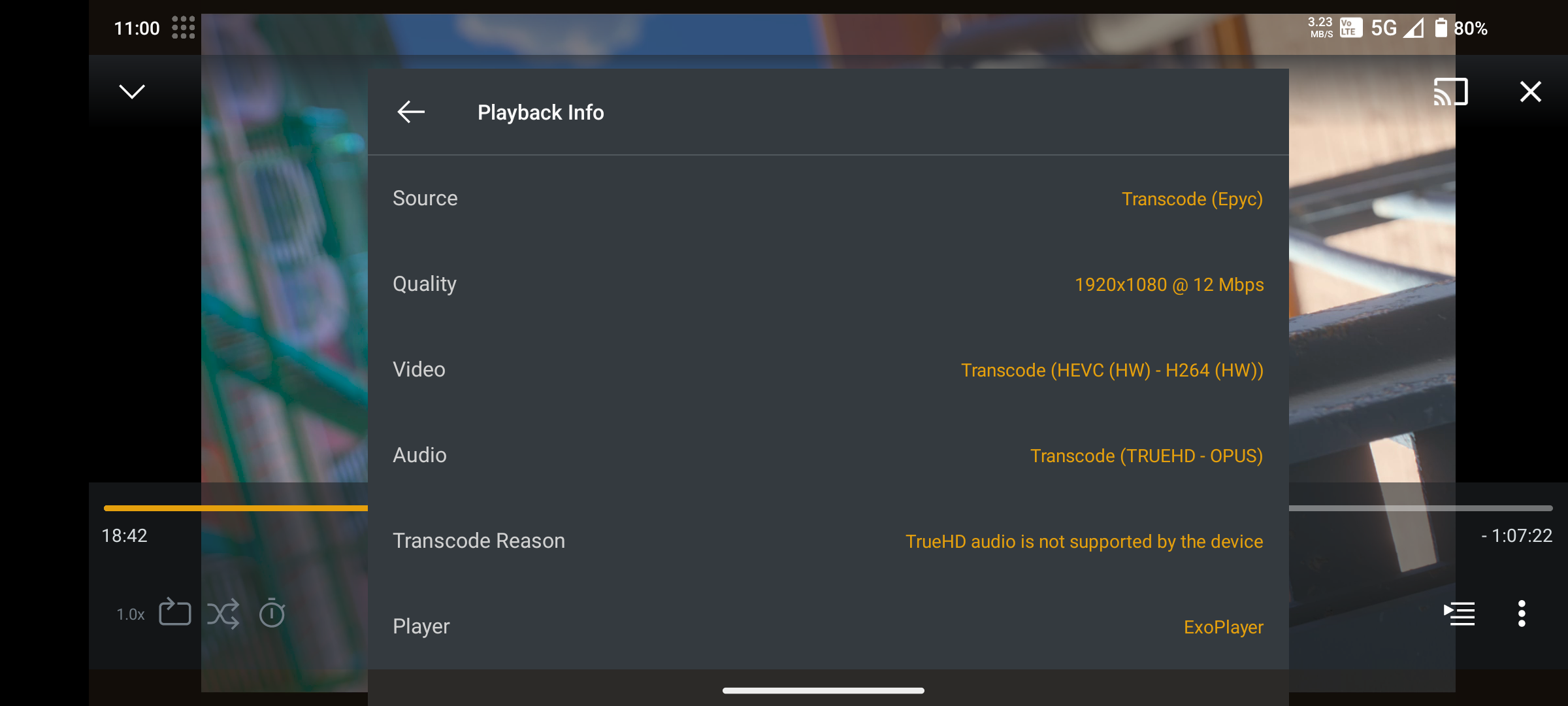

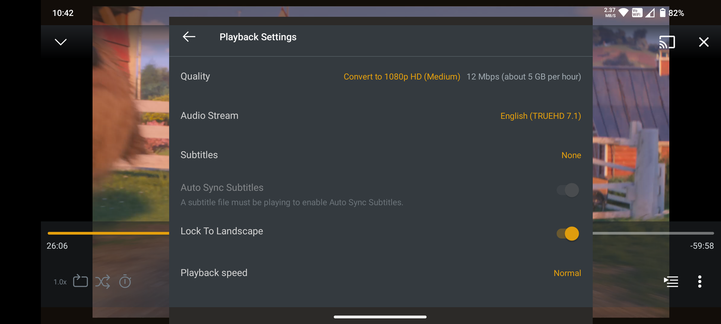

On 2/2/2024 at 7:13 PM, itimpi said:
That location is only inside the container so you should be fine.
I'm sorry for reviving this thread but just wanted to ask another question related to this if that's ok!

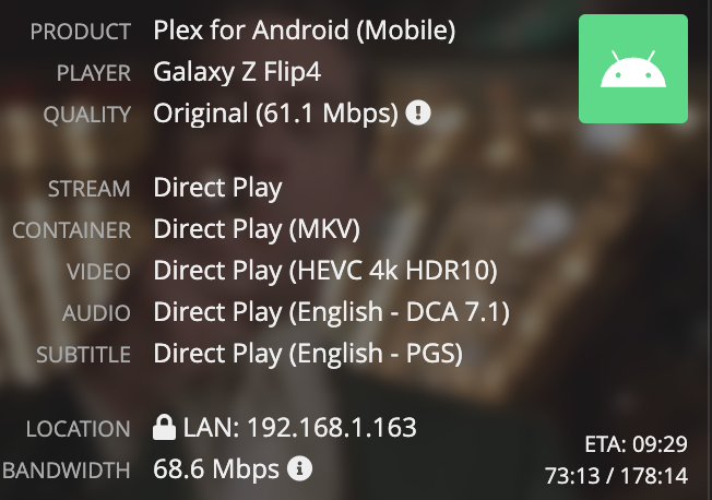

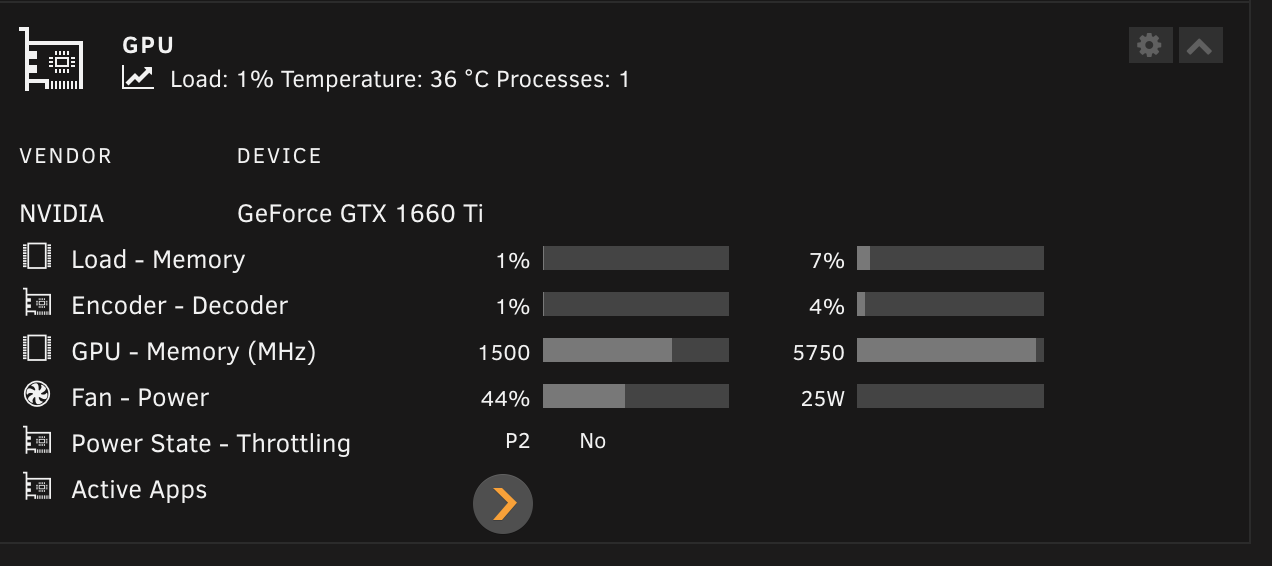

So I'm testing this out, have plex on my android phone, connected to the same network. I'm playing a large 4K 60 Mbps file, direct play to the phone. Absolutely 0 problems, super smooth, fast seek times, etc
When I change the quality on the phone itself to say, 1080p 8Mbps. I get much more buffering and slower seek times than with direct play. On the same network. I honestly assumed this shouldn't be the case as the GPU would be fast enough as well as the bandwidth requirements would be way smaller?
At the same time, it looks like it's barely affecting the GPU. Just hovering between 0-8% on Encoder / Decoder usage. Is this expected? It also seems to not change the size of the /tmp/plex_transcode/ almost at all, though I do see all the transcoded sections being created there.
Just want to gauge if this is the expected performance on a setup like this? Specifically with such a powerful machine I was hoping it would eliminate most of these hurdles!
