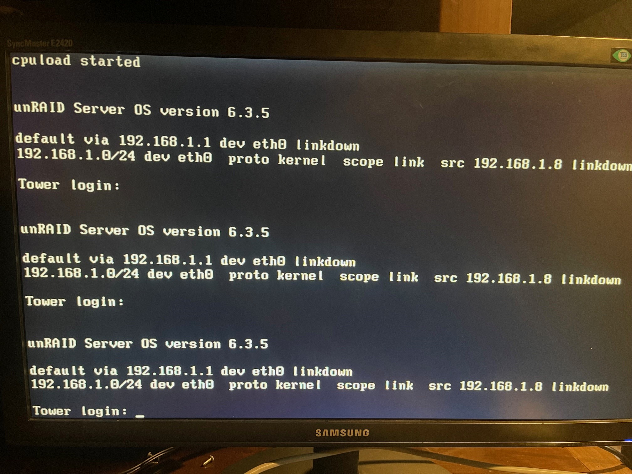

did everything in the write-up but im stuck at this point. In addition to the password situation, I also changed routers and the server has a static IP.
I 'm stuck , please see screen shot attached and advise...
Do you mean you have reserved the IP in your router, or do you mean you have set an IP in Unraid?
Attach diagnostics to your NEXT post in this thread.
Memory is coming back...Edit the NETWORK.CFG file?
Will changing DHCP to 'YES' fix things?
# Generated settings:
USE_DHCP="no"
IPADDR="192.168.1.8"
NETMASK="255.255.255.0"
GATEWAY="192.168.1.1"
DHCP_KEEPRESOLV="yes"
DNS_SERVER1="192.168.1.1"
DNS_SERVER2=""
DNS_SERVER3=""

Hey!
Thanks for your help in steering me in the right direction
I renamed network.cfg and network-rules then rebooted. It defaulted to DHCP and got new credentials from the new router!
I then accessed the Web GUI and all my files were in-tact !
