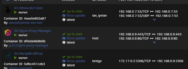

These are my docker containers
Every one of my containers will not run the WebGui.  I can start and stop each container but I am unable to get to webgui.  I have shut down the array and restarted it, shut down my system and restarted. Stopped docker completed a restart of my system then started docker.  Console will run for all containers.

Screenshot the Docker page, I had an "about:blank#blocked" yesterday, happens that the network for that container somehow got removed/set to "None".

Here is my docker page image.
Something's broken with networking
Anything that's running should have IPs there...
Don't know what it could be due to though.
