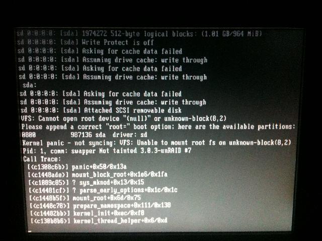

October 22, 201114 yr Author I have tried disconnecting disk3 this has made no difference, I get the following on the display VFS cannot open root device on null or unknown block please append a correct root kernal panic - not syncing

October 23, 201114 yr Author Yes that worked, am I ok assigning the correct parity, disk 1 and 2 for now?, I guess the problem now is knowing which file to replace on the old usb stick or do I transfer the reg code over this stick? Thanks alot.
October 24, 201114 yr Reformat and install unRAID the original Flash drive. Your key will only work on the original flash drive.

July 29, 201214 yr so a format (on windows) and reinstall was all you did to fix it? I am running a brand new mobo/cpu/memory combo, memtest works fine, yet I get that error very randomly... I've tried different combinations and once I DO get it to boot, it only boots once, the second time doesn't boot.... very weird, I'm HOPING it's not the motherboard
