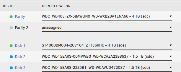

I now have my unraid server back up, but i want to make sure it rebuilds my data drive (disk 1) using parity since i'm sure i messed up the disk my formatting it in windows. I don't want to start my array cuz i'm afraid that i will lose my data...
What is the correct way to go about this and also is there a way for me to explore the contents of the hard drive without starting the array.
(Disk 2 and Disk 3) are just older hd's I found lying around so will add them to the array as well.

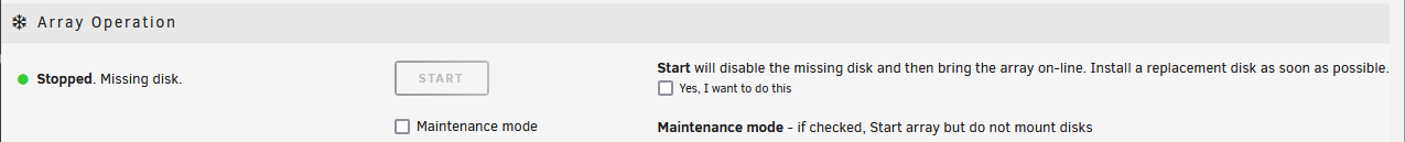

When I unselect the data drive (that I messed up) I have selected my parity drive but it doesn't let me start unless I do it in Maintenance mode and select both checkboxes.
Are you sure? You shouldn't need Maintenance mode checked to enable the Start button. Just check the "Yes, I want to do this" box.
Oh yes, I was able to bring it up and it looks like it says its emulating the data disk and I was able to see some of my files.

Yeah, his screenshot of one parity, one data, and two new disks made it unclear. In this specific case, only the parity was needed, because the original array was only one parity and one data.
So parity seems to be fine, how do I go about adding my actual drive to the array? I can just select it and start the array? I was worried if I just start it like this the parity would get messed up trying sync with the disk I accidentally formatted.
The last diagnostics you posted showed that it appeared that disk1 is being emulated correctly.    It should now be possible to simply stop the array; assign the accidentally formatted disk to the disk1 slot; and then Unraid will tell you that will cause the disk to be rebuilt with the contents of the emulated disk1 when you start the array.   When rebuilding it is irrelevant what format the target disk is currently in as every sector gets overwritten by the rebuild process.
