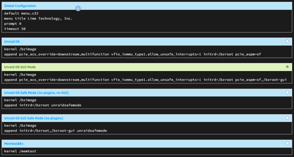

So I have always had the boot set to:
But I end up with the Login terminal prompt.

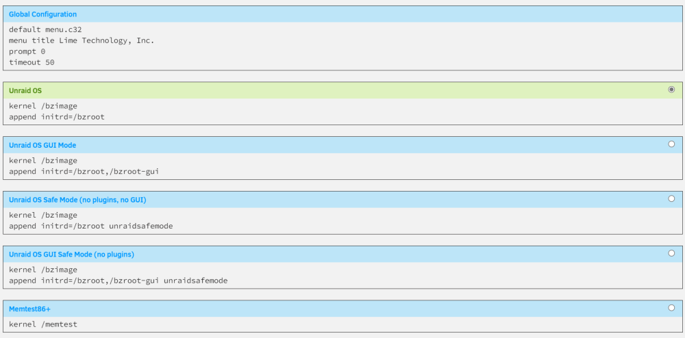

The standard setting on a fresh install looks like this:
I dont see anything prohibiting the GUI in the above settings.

The entry for the GUI mode has a comma rather then a space before the /bzroot-gui option.  The options are meant to be space separated, so  having a comma instead will stop the /boot-gui being recognised as an option.
WOUW I cant remember changing anything? (Nice catch!)

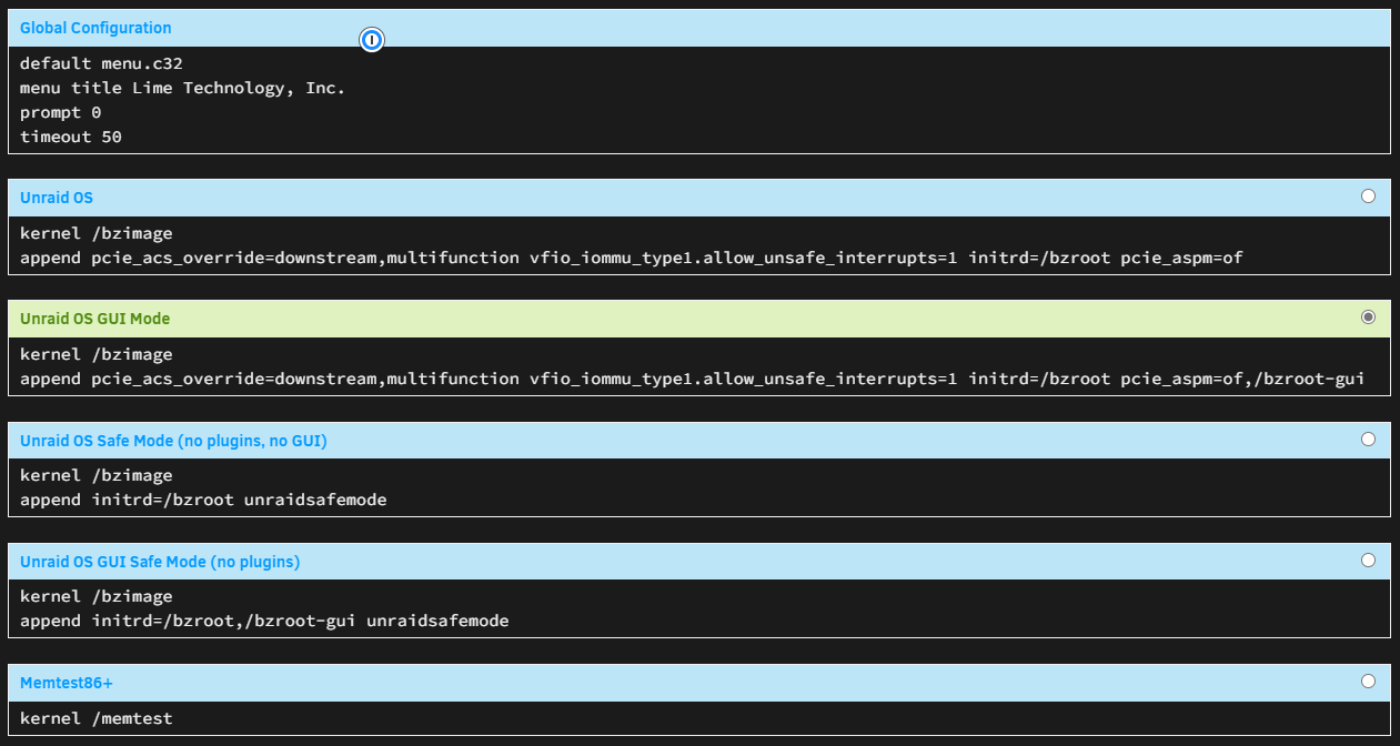

So this would probably work: (Moved the pcie_aspm=of back and did the comma.)
I have wanted this to work for such a very long time!, thanks so much @itimpi

I ‘think’ that should work.   As far as I know the order of the options is not relevant, just that they are correctly entered.  Guess it is a case of try it and see.
