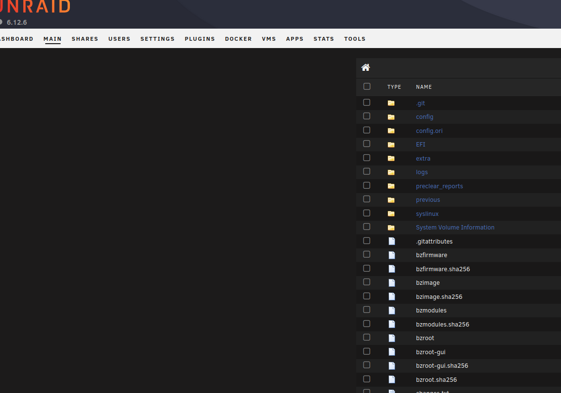

I see this in my usb drive from my microserver... so as far as I know, it is UEFI but it is not working
