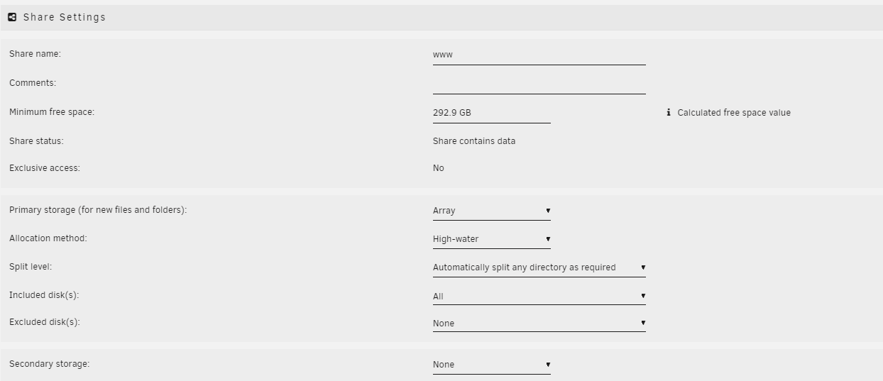

# ls -d /mnt/*/www
/mnt/disk16/www/  /mnt/user/www/  /mnt/user0/www/
This extremely simple share stored entirely on disk16, and won't mount with 'exclusive access'. Should it be able to, or am I wasting my time trying to get this working with data on the regular unraid pool?
Edited by nick5429

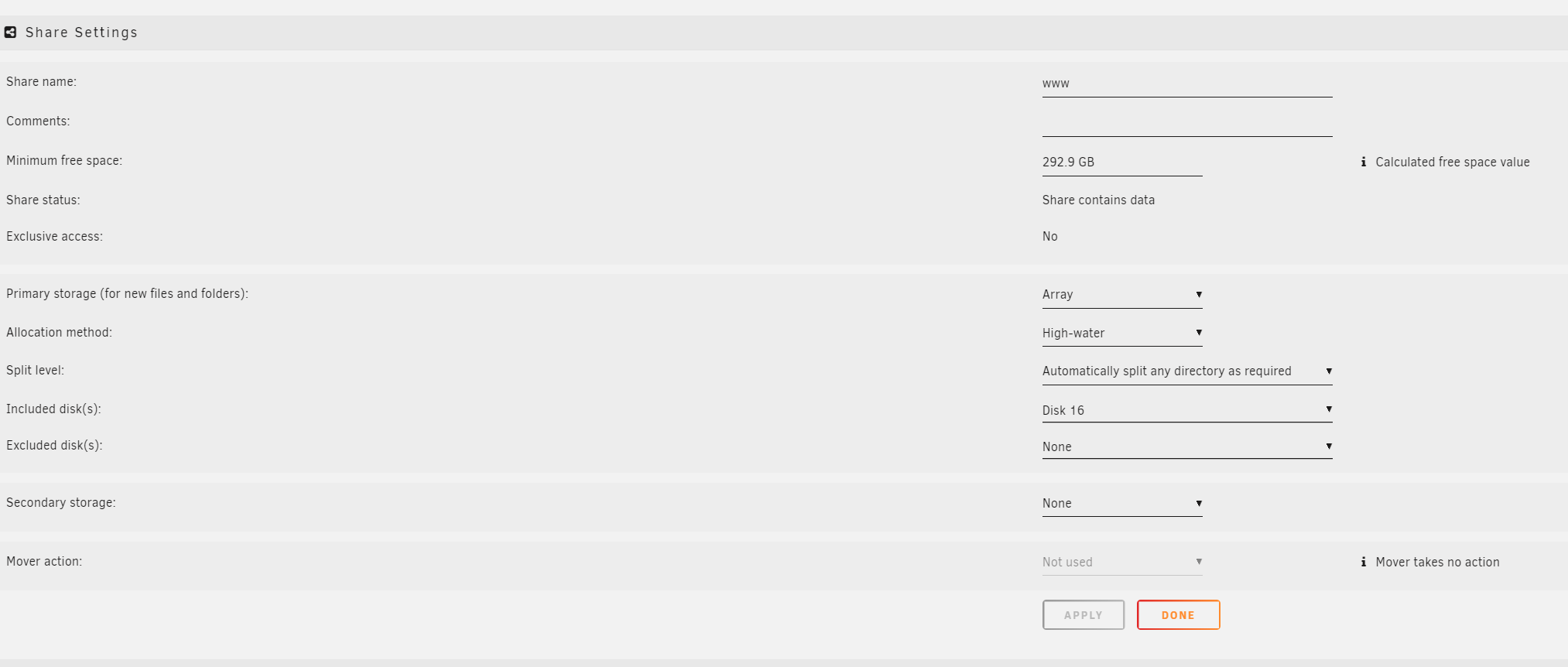

You have “Included Disks” set to All so the share is not restricted to disk16 even though that might be where all files are currently stored.
That doesn't, and shouldn't, make a difference.  After making your suggested change and rebooting:
I don't mean to offend -- but can I get clarity from someone else who confidently knows the correct answer to the core question here? Is this actually possible?  I'm surprised that I haven't been able to find anyone else either asking this question or trying but failing to accomplish this....
