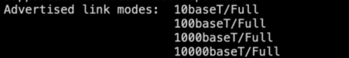

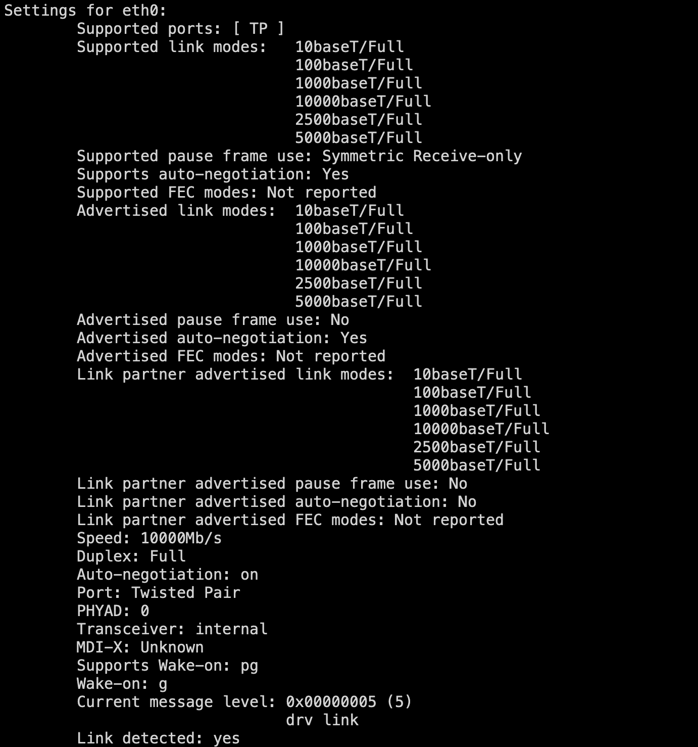

I just upgraded to the Asus Z790 ProArt Creator which has the 10gb nic built in. I have it connected via RJ45 at the board into a SFP+ to RJ45 adapter. On the Ubiquiti switch, it negotiates at 10GB, and in the webui main page, it says 10000. Using ethtool however, i see that the ubiquiti switch is asking for 10000, but the Asus motherboard can only advertise to 5000. I tried a different 10GB switch which has RJ45 ports and ran ethtool again and the same thing shows up, so I dont think its any fault of the switches or cables? I included the diagnostics and the screenshot below. Any help is greatly appreciated! I get occasional drop out in accessing the web ui and also over 500k read drops.

Eth tool is showing 10Gb
Not sure why you are getting drops. There are comments about turning off power efficiency settings for windows, not found an option on linux yet.
usually drops at 10G mean: BAD CABLE!!!
Make sure, you have got a real 10G cable. Most of them sadly are are "raw cables" which means, the cable is fine, but the plugs are not capable of 10G.
As a last resort the speed will drop to 5 or even 2,5 G to compensate the transmission errors.
BTW: it has NOTHING to do with power efficence. The link speed is the same for 2.5, 5 and 10G. Just the Usage/Pause times are different. So it is not wrong or uncommon, that a switch reports a 10G link while the real used speed is lower. Make sure that Flow Control is turned on and working, else you will notice a lot of retransmissions and slowdowns.
BTW2: if possible, avoid twisted pair 10G completly and go safe with fiber or direct connect SFP+
BTW3: you HAVE a 10G connection, read your list correctly! the 10000 comes before 2500 and 5000. And this is just an offered list, the picked speed is 10000 as you can see below.

Ah yes thank you. Right after I posted I noticed that, I deleted the post cause I just didn't see it at first for some reason, I assumed it listed it in order of speed. Thank you for pointing that out.
Ah yes I didn't read the list correctly! I'll try a new cable and see if it fixes it. I did have a X540-T2 which worked well, but I did an upgrade and there was 10Gb on the motherboard and I wanted to simplify/have more PCIE slots available. I agree with you and I also prefer SFP+, much simpler and cheaper! Thank you!
