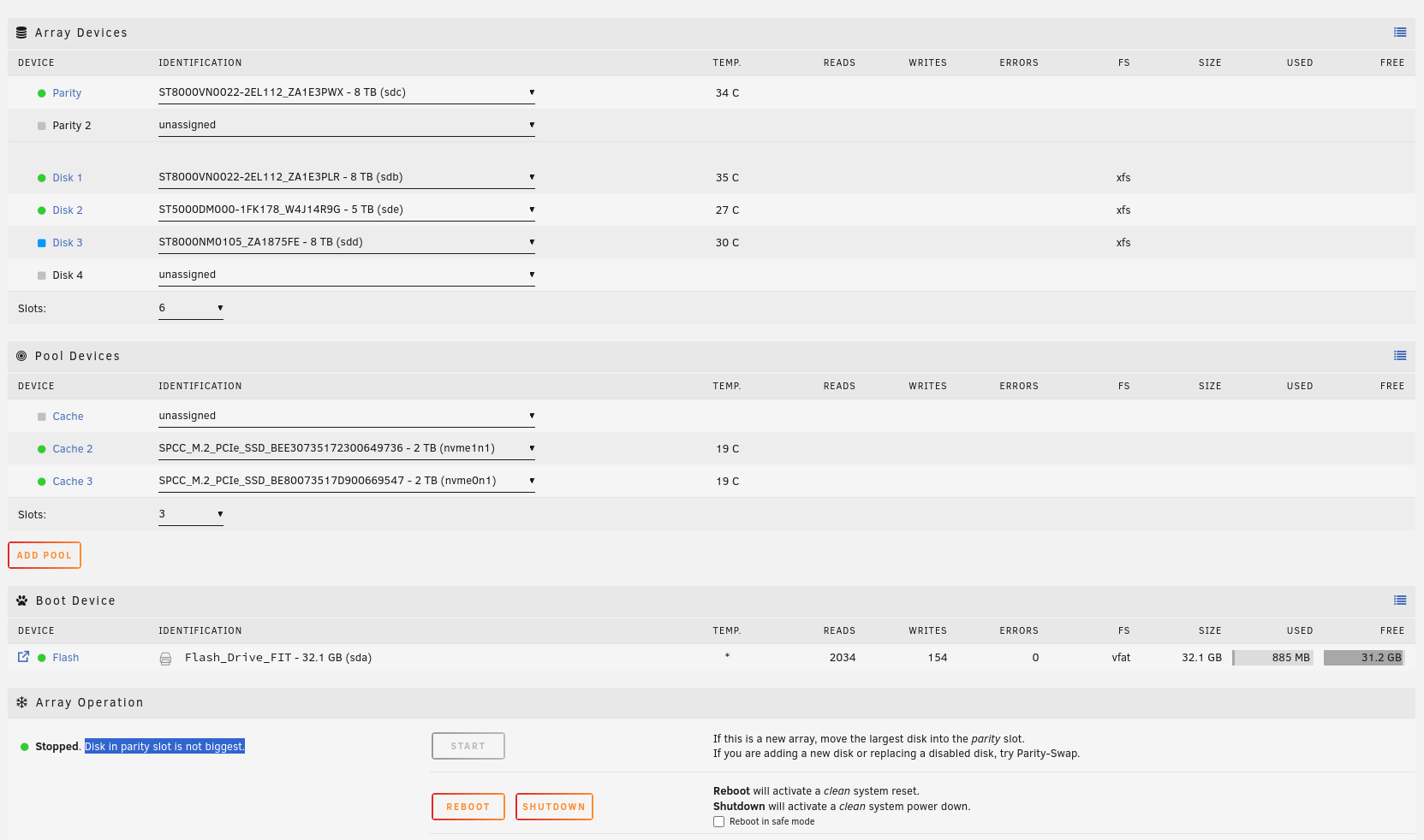

Chelun Posted February 19 Share Posted February 19 Hello all, I am pretty new with Unraid, the truth is that it has been running for years without issues. When I originally installed it I had it with a bunch of different dirves, (2) 8TB, (1) 5TB, (1) 4TB and (1) 2TB. Worked perfect but I have no need for that many drives so I decided to replace the 5,4 and 2 for a new 8TB drive that I removed from another host. I already removed the 2 and 4 TB with out issues, but the 5 has some data that I want to move to the new 8TB, So I left it in place for now. My issue is the new 8TB is recognized but I can not add it as a Data drive, it only let me add it as Parity 2 drive. Can anyone help me on setting it up as a Data drive? Here is some screenshots of my setup. Thank you in advance! Quote Link to comment

Chelun Posted February 19 Author Share Posted February 19 The parity drive is the same one, did not change it at all. the new drive (sdd) was used in a Windows VM for a while, I decomm'ed the VM and now I want to reuse the drive here in the unraid server. sdc is the parity and sdd is the new drive, when I open fdisk on each drive I see the sdc as bigger, so I don't understand what I am doing wrong here. Disk /dev/sdc: 7.28 TiB, 8001563222016 bytes, 15628053168 sectors Disk model: ST8000VN0022-2EL Units: sectors of 1 * 512 = 512 bytes Sector size (logical/physical): 512 bytes / 4096 bytes I/O size (minimum/optimal): 4096 bytes / 4096 bytes Disklabel type: gpt Disk identifier: B9C9F102-FCCB-4E59-AFB6-6561A40FD7B8 Device Start End Sectors Size Type /dev/sdc1 2048 15628053134 15628051087 7.3T Linux filesystem Disk /dev/sdd: 7.28 TiB, 8001563222016 bytes, 15628053168 sectors Disk model: ST8000NM0105 Units: sectors of 1 * 512 = 512 bytes Sector size (logical/physical): 512 bytes / 4096 bytes I/O size (minimum/optimal): 4096 bytes / 4096 bytes Disklabel type: gpt Disk identifier: 86B8EC10-FC00-4864-B442-E5EEFA93FBA1 Device Start End Sectors Size Type /dev/sdd1 2048 15628052479 15628050432 7.3T Linux filesystem I will update to 6.12.8 as soon as I finish this post. Quote Link to comment
JorgeB Posted February 19 Share Posted February 19 26 minutes ago, Chelun said: The parity drive is the same one, did not change it at all. That's not what I meant, just that before it was used as parity it must have been used with a different OS, i.e., it wasn't a new blank disk. 28 minutes ago, Chelun said: sdc is the parity and sdd is the new drive, when I open fdisk on each drive I see the sdc as bigger, so I don't understand what I am doing wrong here. sdd doesn't have a valid Unraid partition, it's not using the full disk, so Unraid wants to create a new one, and the new one would start on sector 64, so it would be larger then the existing partition on parity, I can give you the command to create a new Unraid compatible partition on the new disk to avoid messing with parity, but you may have the same issue in the future. Quote Link to comment
Chelun Posted February 19 Author Share Posted February 19 25 minutes ago, JorgeB said: I can give you the command to create a new Unraid compatible partition on the new disk to avoid messing with parity Please, I will run it and then after the drive is in, I can rebuild the parity. Quote Link to comment
Solution JorgeB Posted February 19 Solution Share Posted February 19 Don't forget that you will need to be on v6.12.8, it won't work with previous v6.12.x releases due to a bug: Unassign the disk, then type: sgdisk -o -a 8 -n 1:1M:0 /dev/sdX Replace X with correct letter, re-assign the disk, if you get the same error reboot, but it's usually not needed al long as you unassign and re-assign. Quote Link to comment
Chelun Posted February 19 Author Share Posted February 19 Thank you so much!! That command fixed it! Now the array started with the 8TB as data drive and parity check is in progress!!!! Thank you again 1 Quote Link to comment
