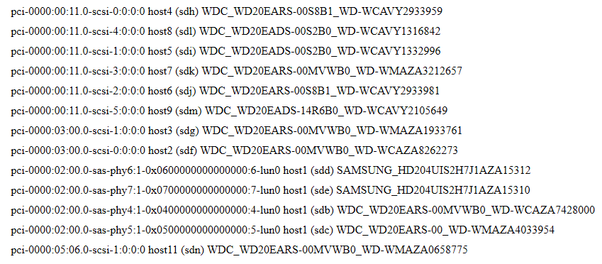

See attached image:
8775 is on the PCI card.
No errors on the 2273 disk (that's the newest one) since it was connected to a PCI-E card. The disk 8775 on that PCI card is nearly full, so it's okay to be throttled like that. I guess, anyway. :'(
Some conclusions:
1) Disk 2273 does not to be sent back as RMA.
2) Something is weird about that PCI controller card, no matter the disk that is connected to it.
