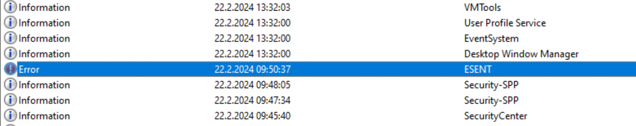

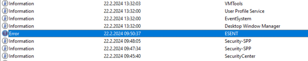

I got the brilliant idea of looking at the windows client log file. The time I estimated seems to be correct.
(That windows error is repetitive, not related to the problem in Unraid).

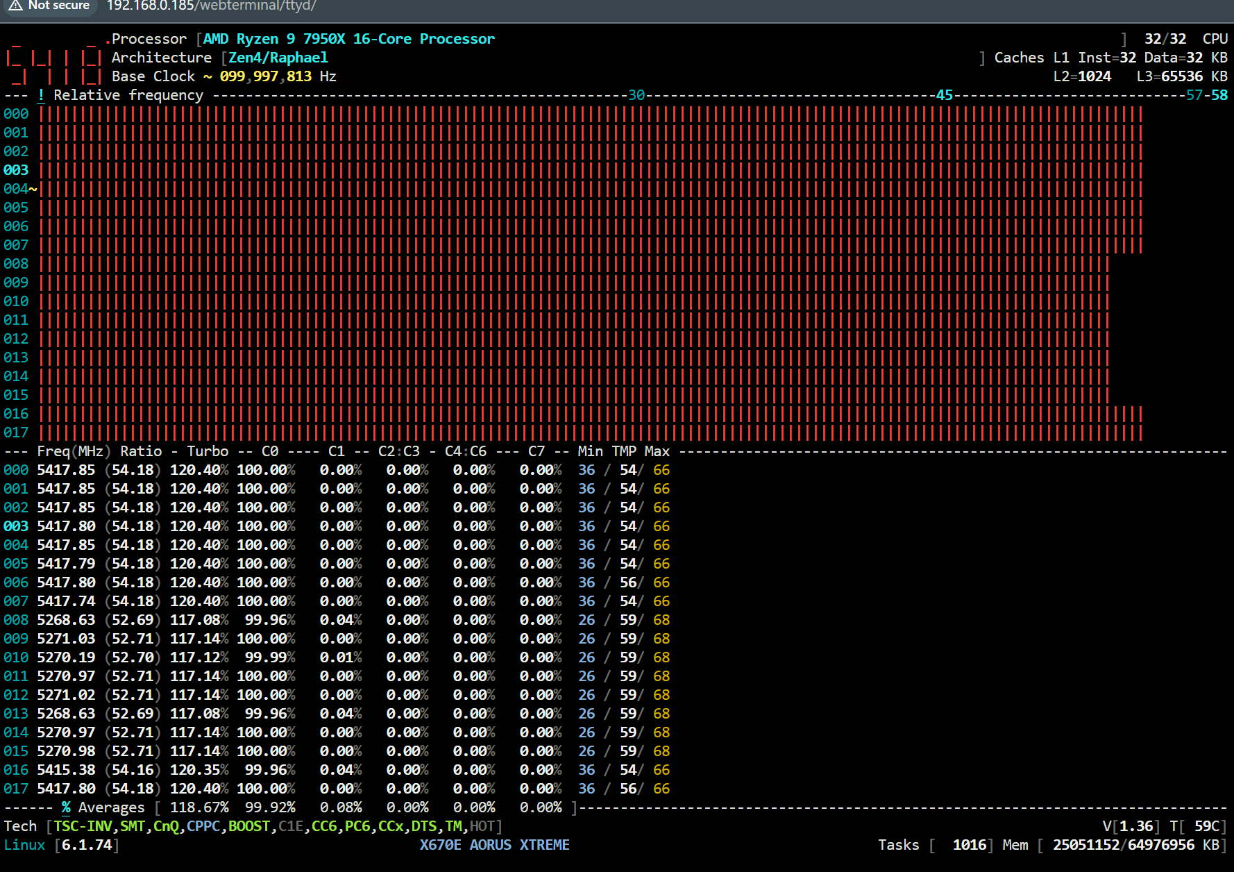

Ran this for over 30 minutes. Its not overheating CPU.
If its a memory issue then the server should simply crash/reboot/flaky, right?
Used something called CoreFreq for the CPU stress test.
