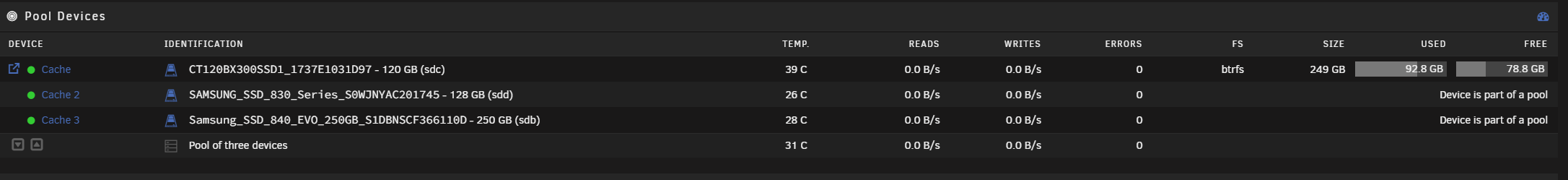

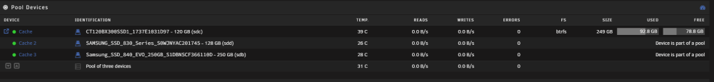

My current cache pool looks like this:
I would like to convert that pool into a single drive and simply use the 250 GB Samsung SSD. Which steps do I need to follow?

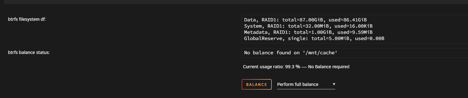

You need to make sure that the pool is completely balanced to RAID1 initially.   You can then remove 1 drive and then you need to rebalance it to RAID1 gain with just 2 drives present.   You can then remove the second drive.  You now want to change it to use the Single profile.
Done.

You mean stop the array and remove it from the pool? Like this?
Yes, if the array does not start post the diags, pool may still be reporting single profile.

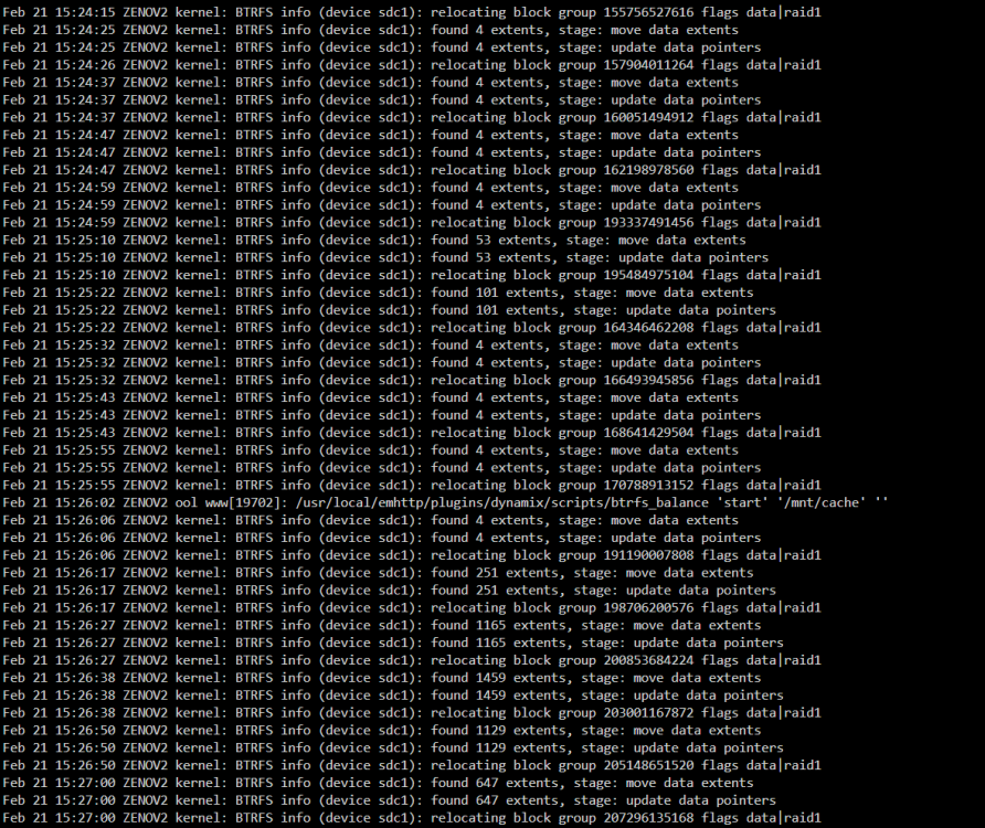

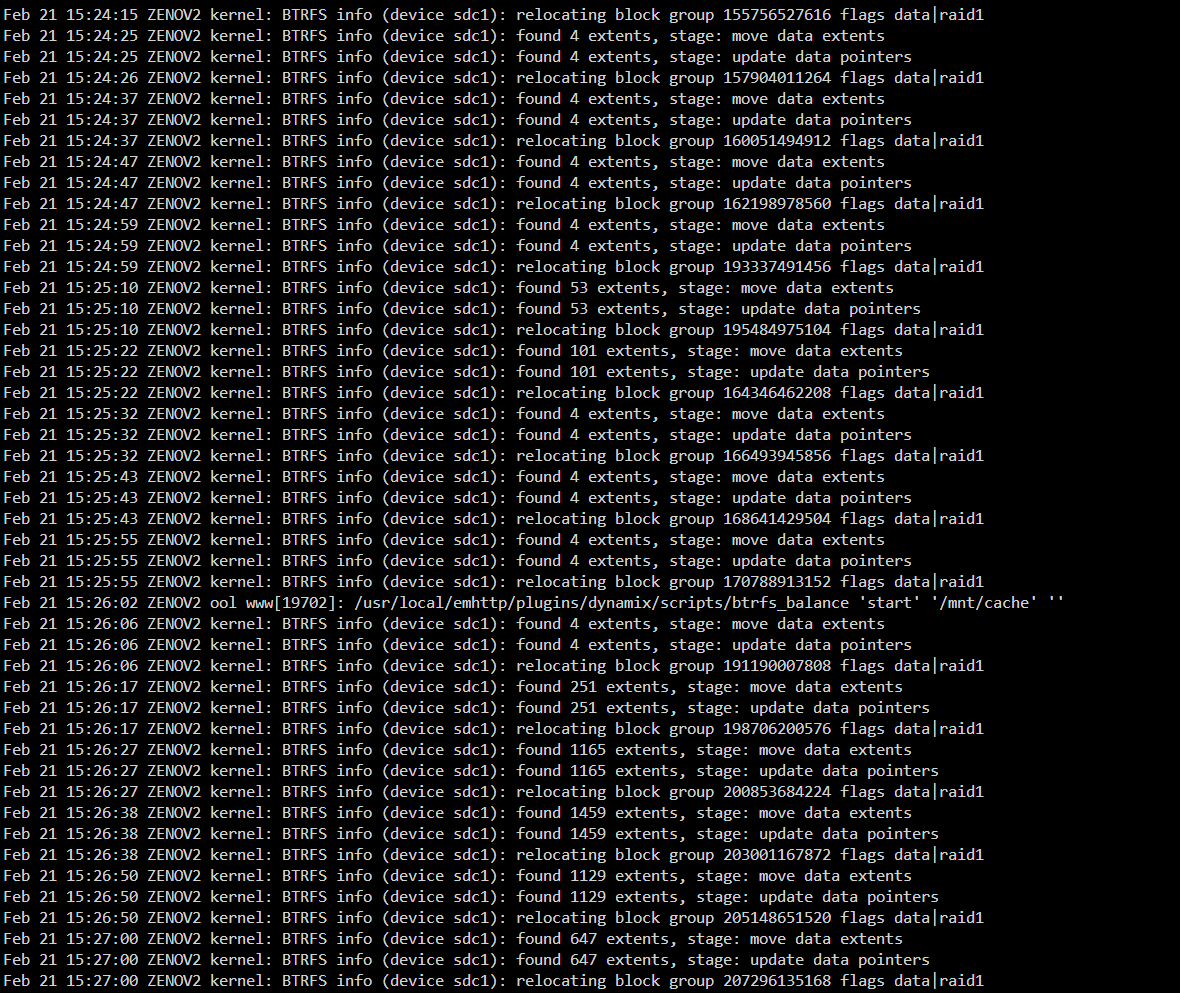

The array started but the cache drives are showing activity and the console is showing this
Edited by s1l3nce

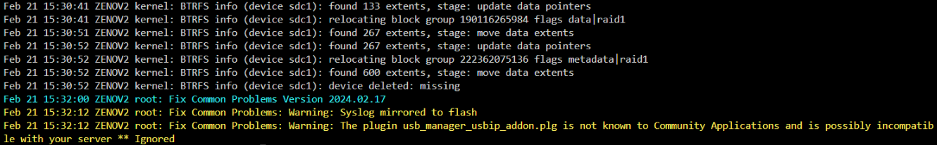

And I just got this message on the console
Should I proceed with the next disk?
Btw, on the first disk removal, I clicked here where it says "balanced" and a percentage showed up. But once the first disk was removed, when I clicked on it again, it did not show any activity, although there was activity between the drives, like I showed in the console.
Edited by s1l3nce
That's all normal, it's balancing, you can remove the other one now.

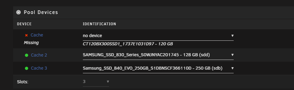

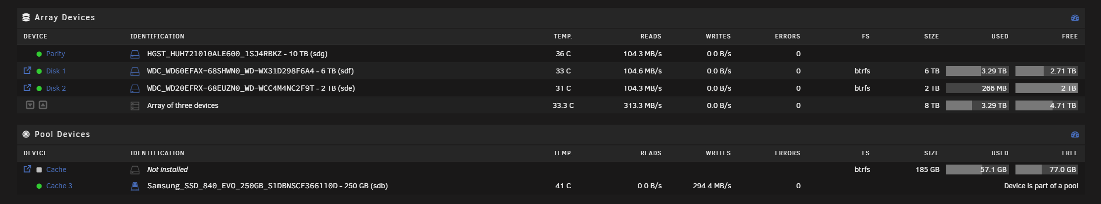

Hum... this looks weird. I removed the last disk, started the array and then this happened:
A parity check started and it says that there is a missing (not installed) disk on the first slot.
Edited by s1l3nce

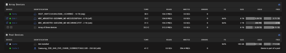

This is what I see on the slot of the last SSD I removed (that now shows as Not Installed)

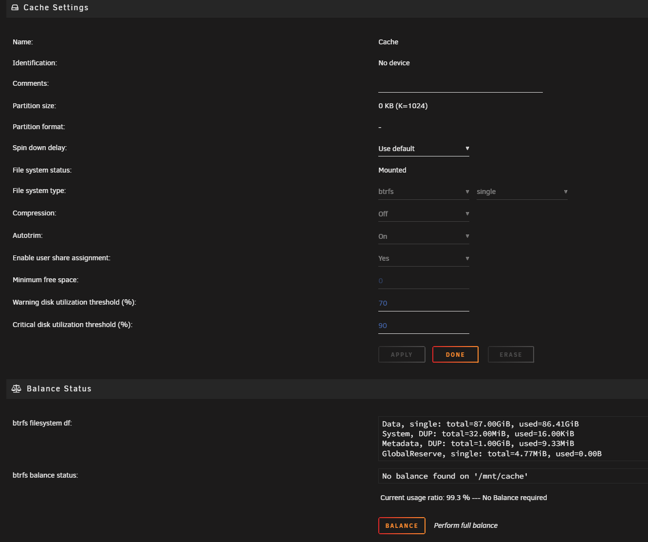

It does not seem to be possible to activate single profile from this menu now.
Parity check would be unrelated, maybe an unclean shutdown, for the pool you can reimport with the device in the top slot, stop array, unassign the pool device, start array, stop array, re-assign the pool device, start array.
It worked, brother. And, curiously enough, the parity check corrected itself after that without having to do a full parity check.

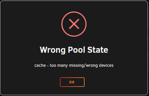

I just had a problem. I rebooted the system and when Unraid loaded back, my array was stopped. I tried to manually restart it and it gave me this error:
I've just followed this advise to resolve the issue:
