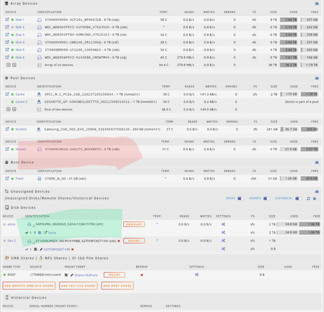

My array is fast filling up, but unfortunately right now I don't have spare cash to purchase more drives. So I plan on rearranging what I already have as I'm currently not using all the drives I have attached. Before I do so, I just need some advice on how to go about it so I don't stuff things up.
I would like to add the drive which is highlighted in red, to the array. It's currently a cache drive for just my BitTorrent files. It is an external drive but I'm going to pull the drive out and attach it internally, so long as I have enough power cords for it. I would then like to place the green highlighted drive as that cache drive.

How are you connecting it externally? eSATA or USB?
USB
I discourage you from trying USB in the array.
I'm not keen on doing it either, but my drives are almost at capacity. I might be able to hack the enclosure so I can connect via sata and still power it if my computer's power supply doesn't have enough power cords.
I may have another power supply somewhere, which will mean I'll have power. If this is the case, what would the steps be to transition?
Do you want to keep the data on the disk that is currently assigned to the shared pool?
Don't need any data on the shared pool.
No I don't have any Parity drives. I am starting a new job soon and am planning on getting one soon after. I do have a lot of stuff on the server, but nothing I can't replace.
Since there's no parity you can just assign it to the array.
Done. Thank you for your help!

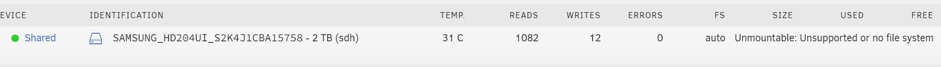

Now I have this:
Now I am about to search how to fix this and I'll be then sorted until I can afford to purchase more drives.
All good now. At the bottom it had the prompt to format that drive. So I selected it and it's all working as it should.
Not sure I follow, since the screenshot you sent still show it assigned to a pool, but great if it's resolved.
