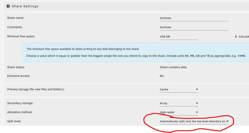

I ran mover to get all this data off the cache to the array as I have another 3TB+ to copy but after some time the mover stopped and some of the data would not come off the cache, even though this share is set up to use All disks...so I manually selected all 4 disks to be used and still the mover won't move.
It looks like my Disk 1 is absolutely full and none of the other disks are being used at all.
Settings attached.
Probably because of your split level setting
Try changing this to this:
As pick a value of "Minimum free space:" that is about 25% larger than the biggest file you will ever copy to that share.  (Your current setting of 458GB is probably about 8X larger than it need be.)

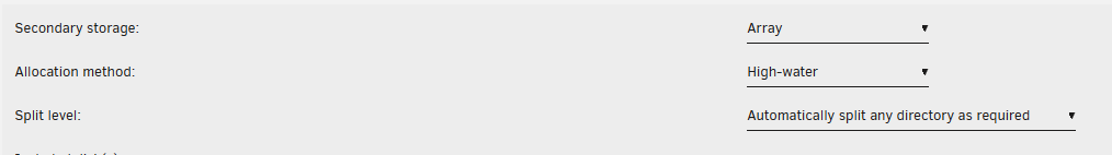

Thank you! It's moving off the cache on to another disk now.🙏
