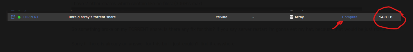

This is what I see in the share menu:

First thing, you need to click the 'Compute' link (shown by the arrow), to find the amount of storage actually used by the share.   When you do that it will show the storage used and what each disk that contains files associated with that share stored on it.
Second thing, as I recall, the circle is the amount of total space that is available to the share on the array.  If it is less that the total space on the array, this is because the share has restrictions on what disks it can use for storage of data when it does a write operation.

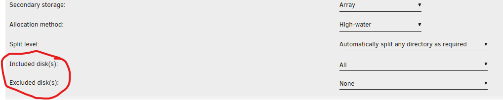

To check/change this setting, click on the Share name on the Shares tab and look for this section:
The two settings are circled.  I seem to recall that you should only use one of them-- not both for the same share.  Either include certain disks or exclude certain disks.  (I would do the one which would have the fewest number of selections.)

I have included all disks and excluded none, not even touched these setting, this is okay for me and moving data should not be affected by this.
Only thing I changed which should still not affect enything because nothing is now splitted on my array:

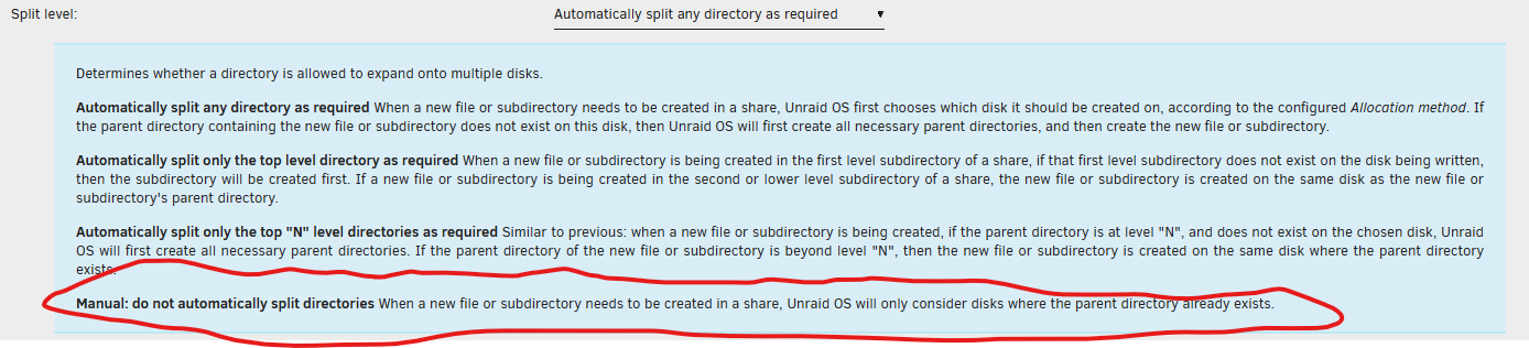

IF you turn on the help (or click on the 'Split Level', you will get this:
Yeah I figured it out myself already, but who would have thought of this... All settings are kinda self explanatory I didn't even notice the help function there...
