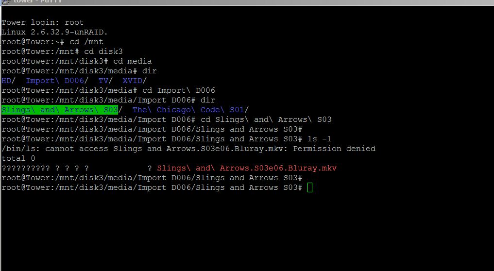

cd to the directory and enter ls -a
Why not delete the folder/files in the terminal?

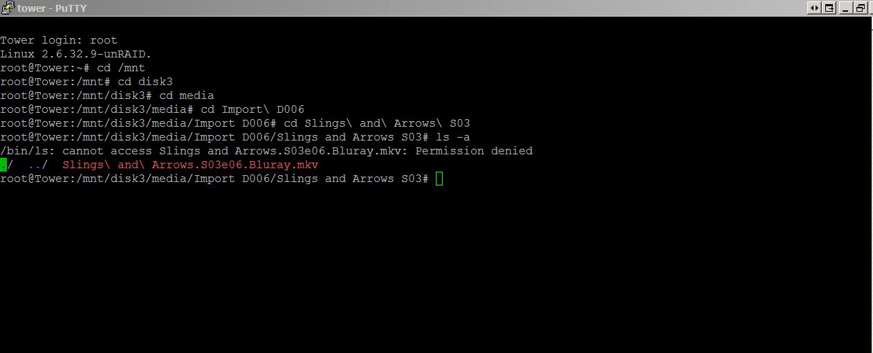

I'm not very familiar with linux but I did cd to the directory and tried "ls -a". The response I get is "permission denied." which is what I got previously. I'm attaching a screen grab of the session. If there is a way to do it, I'm game but I kind of concluded that I couldn't get to it and that's why I developed the alternative scenarios.

Ok. I think I figured out what you were suggesting. (sorry but I'm petrified of screwing things up from the command line) I navigated to the directory containing the phantom file and attempted to remove it by typing in "rm -rf Slings\ and\Arrows.S03e06.Bluray.mkv" it replied "rm: cannot remove 'Slings and Arrows.S03e06.mkv': Permission denied."

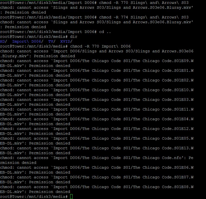

Try giving yourself permissions first. The -R switch makes the chmod command recursive. I would do a chmod -R 770 foldername or even a 774. Since your plan is to delete it really doesn't matter. It may be even easier to just see what permissions are at a higher level and apply the same throughout. Start with one file to test.
Look this this link. It explains chmod better than I could.
http://www.linuxcommand.org/lts0070.php
After the chmod completes try the ls again. You should have rights and rm should work at that point. If not post your results.
Thanks, but I'm afraid that didn't help either (screen shot attached). But also thanks for the link. At least I learned something that will come in handy down the road.

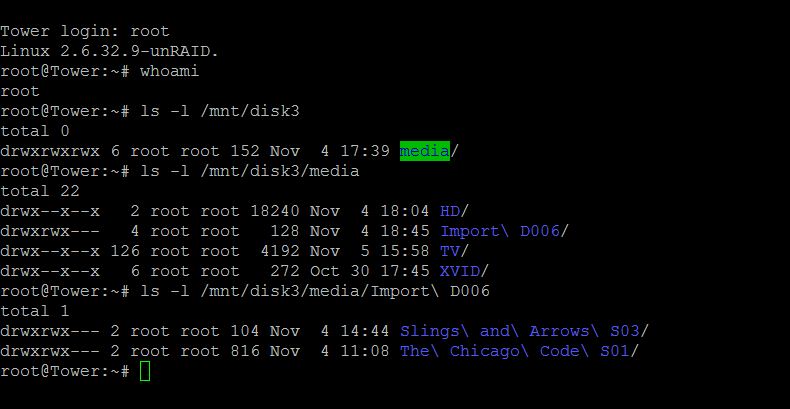

What does the following show:
whoami
ls -l /mnt/disk3
ls -l /mnt/disk3/Import\ D006
See attached. I had to modify your suggested command because the directory structure is actually: mnt/disk3/media/Import\ D006. I presume that is what you meant.
Just to hazard a totally uneducated guess, but from what I read earlier today, is it possible it doesn't see "root" as the owner of the directory, since it appears to be saying (at least to my ignorant eyes) that "root" has privileges but "other users" do not?
Anyway thanks again for the help.
This looks like file system corruption. Since the contents of the disk are backed-up you can stop the array, take a screenshot of the disk assignments, unassign the disk, and enter initconfig. Parity will then need to be rebuilt, the disk re-added, and the backed-up contents restored. It may be faster to run reiserfsk: http://lime-technology.com/wiki/index.php?title=Check_Disk_Filesystems
