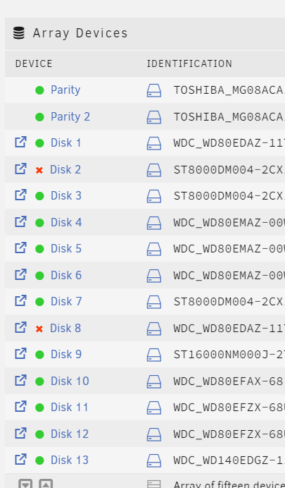

Just had two drives error out and have a red X on them. Uh oh?

Oh crap, I powered off the server without recording the actual disabled drives. Where do I see that in the diags?
Disk2 - ST8000DM004-2CX188_ZCT250PW
Disk8 - WDC_WD80EDAZ-11TA3A0_VGK45L3G
Thanks! Looks like those two drives are on the same molex to sata power splitter. If I order another one and things spin up, do I have to rebuild?
Yep, but only
