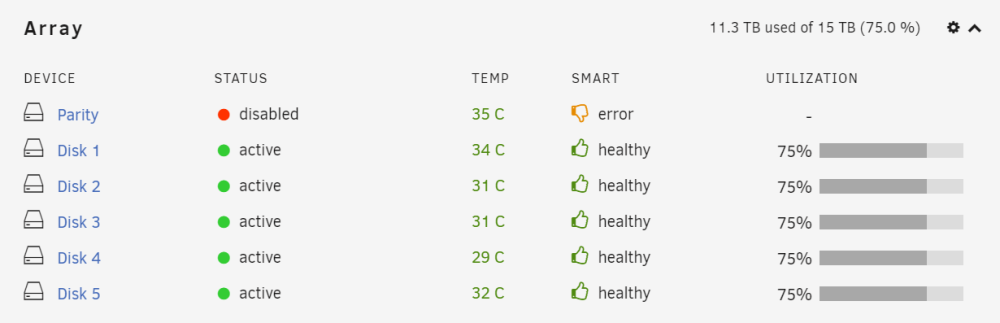

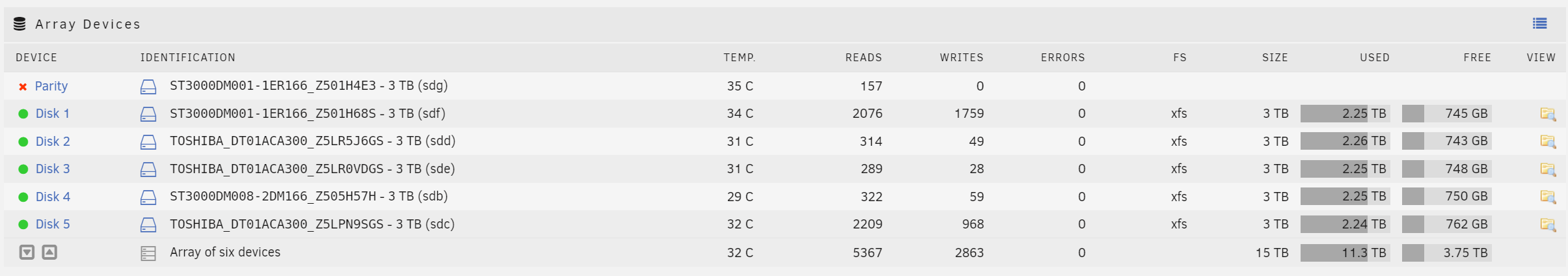

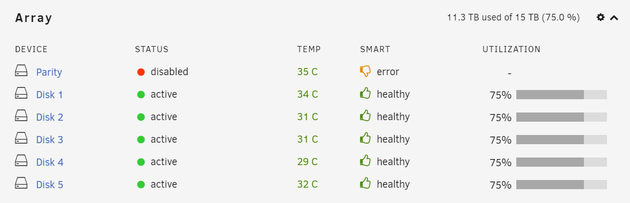

I have been away for a while travelling and come back to see one the parity disks is in disabled state.
Can anyone help me out to see if this may be due to normal glitches (power cuts out a lot here...) or if the disk does indeed look like it is or will be a goner soon and I should replace it asap?
Appreciate any help.
Edited by walterg74
Solved by itimpi

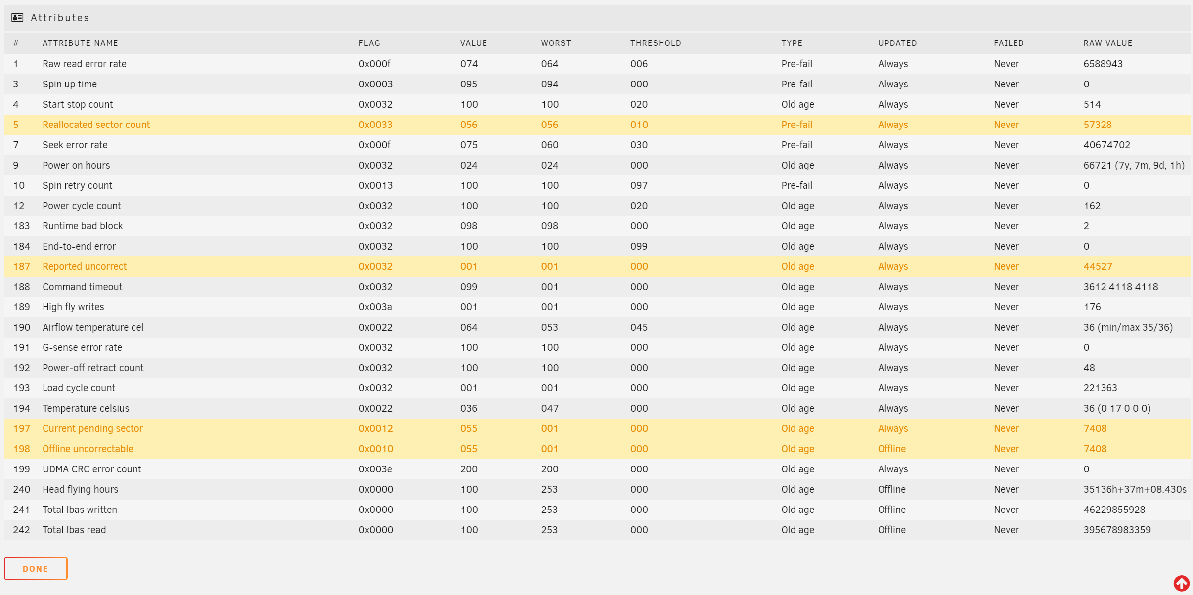

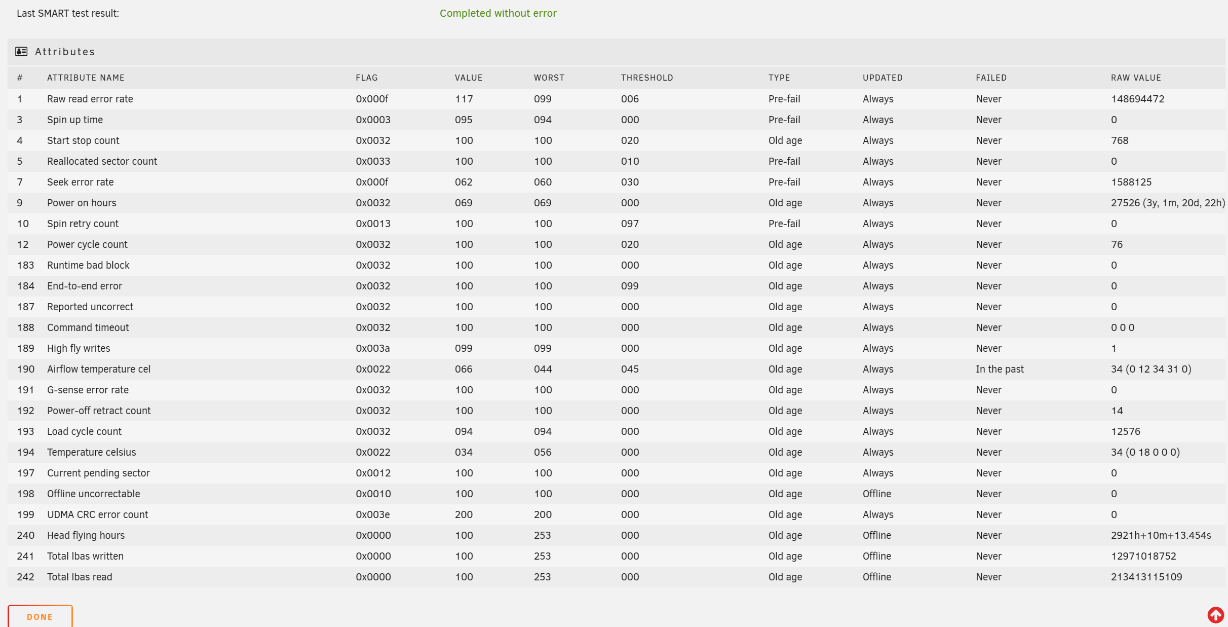

Based on the SMART report the disk needs to be replaced.
With that many reallocated sectors I am surprised the disk is still functioning 😇

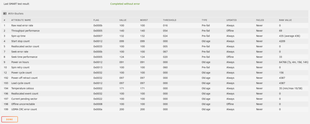

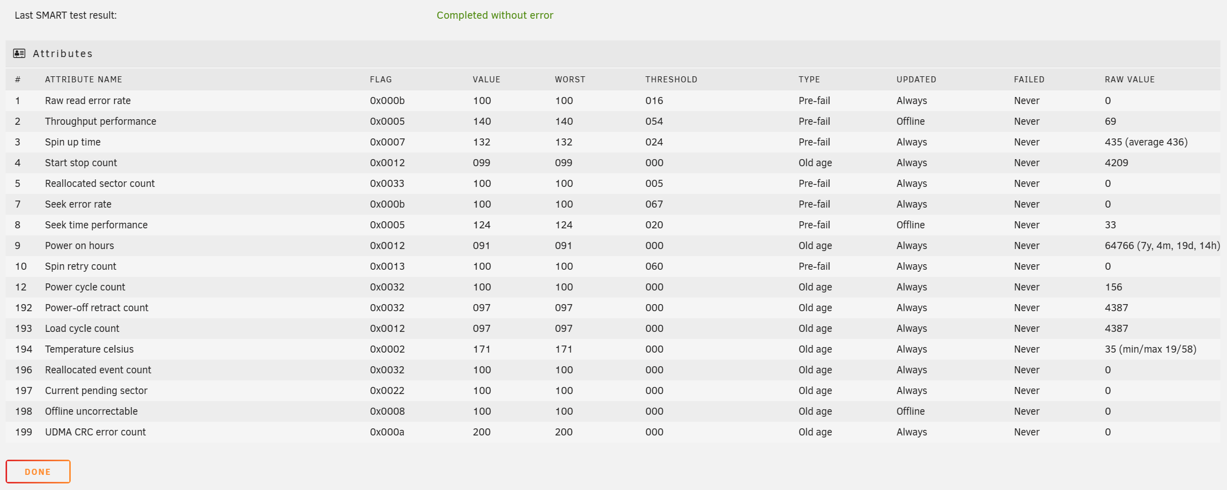

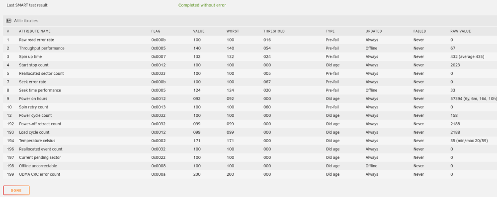

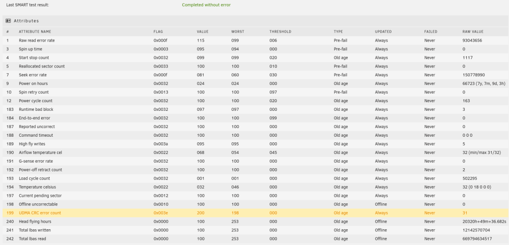

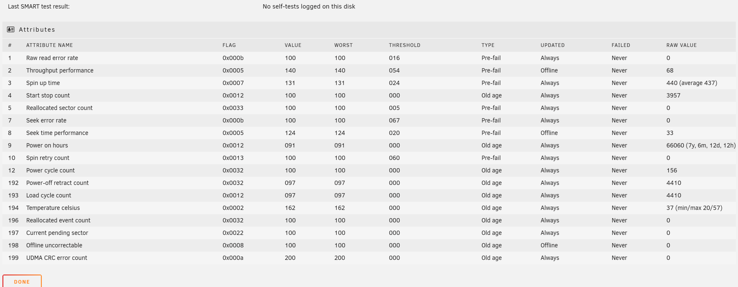

Would any of the other disks need replacing as per stats?:
Disk 1:
Disk 2:
Disk 3:
Disk 4:
Disk 5:
I built this many years ago now, as you can also see from what I guess is not too good a choice for disk size now?
Any other recommendations besides current health?
Thanks for all your help!
Edited by walterg74

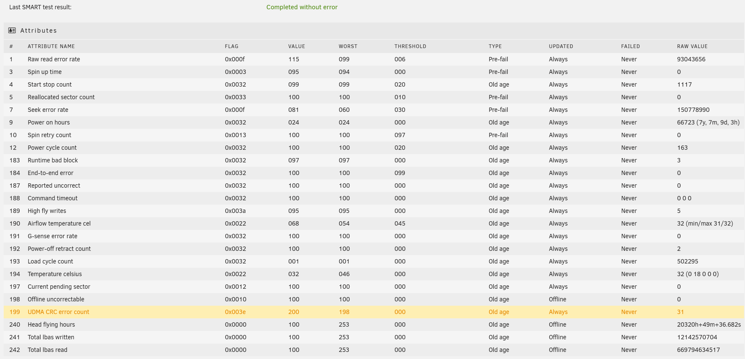

No obvious problems in those SMART reports.   The only one highlighted (CRC errors) indicates a connection issue and normally related to the cabling to the drive, and it never resets to 0, so as long as it is stable or very occasionally increments nothing to worry about it.

It definitely needs replacing.   As well as the large number of reallocated sectors Bering worrying you also want the pending sectors to be 0 on a healthy disk.
Probably  the easiest way is to run an Extended SMART test on the drive to see if that can be passed.  This can be done via a disk manufacturers tools or one of many 3rd party utilities.   If connected to the Unraid server you could also use the Preclear facility to test it.

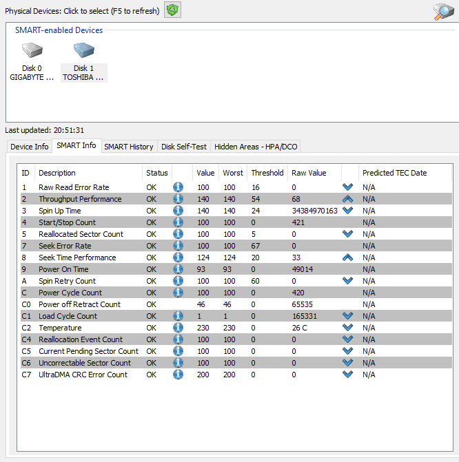

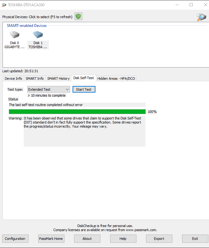

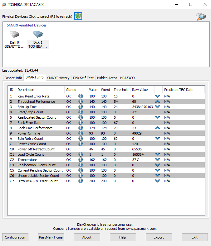

Ok, so I used DiskCheckup,
Did a short test, then extended test.  In theory these are the results:
After Short Test:
Extended Test Completed:
After Extended test:
20817177_3TBSMARTAttributesExtendedTest.thumb.png.90b48d8749e3f539d101eb71f3ab8f83.png
Would you say it's reasonably safe to use this one to replace the parity disk?
Thanks.
That looks fine.   Building parity onto it will provide a good additional test.
