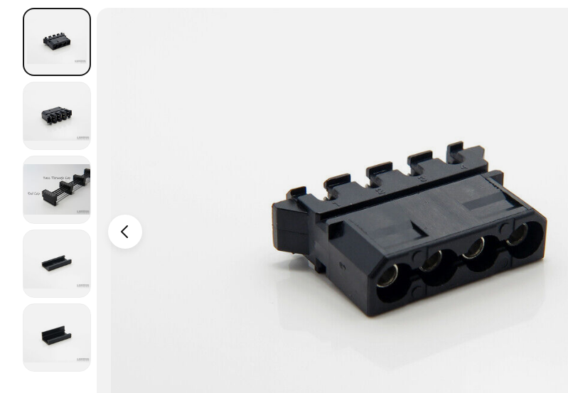

Do you have any molex connectors on the PSU?   You are likely to get better results with molex->SATA connectors as the SATA splitters can not reliably split more than 2 way whereas you can normally get 4-way with Molex ones as the molex connector can carry more current without voltage sag.

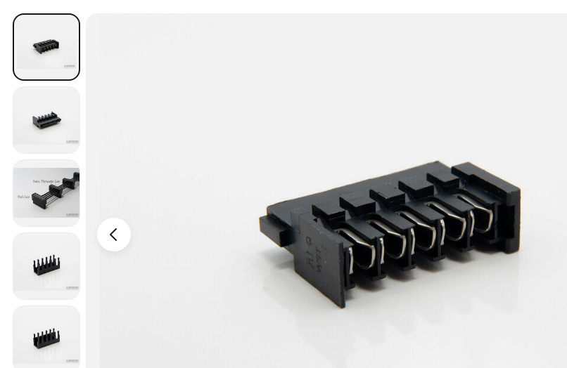

You can add either molex or SATA using punchdown/pass through connectors to the existing lines. Much better than trying to add too many drives to a single connector using a splitter. You can buy them for like a dollar on ebay.
I forgot to mention, my PSU is modular and all the 6 pin SATS power outputs are all taken.  That's why I came across those 8 pin to 6 pin adapters.  I do have open PCIe 8 pin outputs and wondered if that might be an option.  I'm just concerned the pin assignment (on the PCIe) might not be what I need.  I don't want to short anything out.
the punch-down idea might be an option thanks Michael_P.  I just don't want to put too many HDD on one line.
