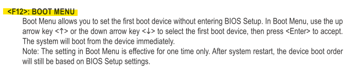

Try this during the POST routine of the MB startup (From the Manual):
Huh, okay, it works from F12 forced boot device, but then doesn't from the default boot menu. Any suggestions? Unless I'm going crazy I'm setting the normal boot priority in BIOS to be the USB drive first, but it doesn't seem to want to.
Is fast boot disabled?
Can you select the USB drive in the hard drive boot section? Some motherboards put the USB sticks in the hard drive list as well as the USB list.
Fast boot is definitely disabled. As far as I can tell this particular BIOS only has one location to set boot order, and it seems to be USB first. That said I'm not sure if the F12 menu is supposed to update as well or not, since the USB is not first in that list.
