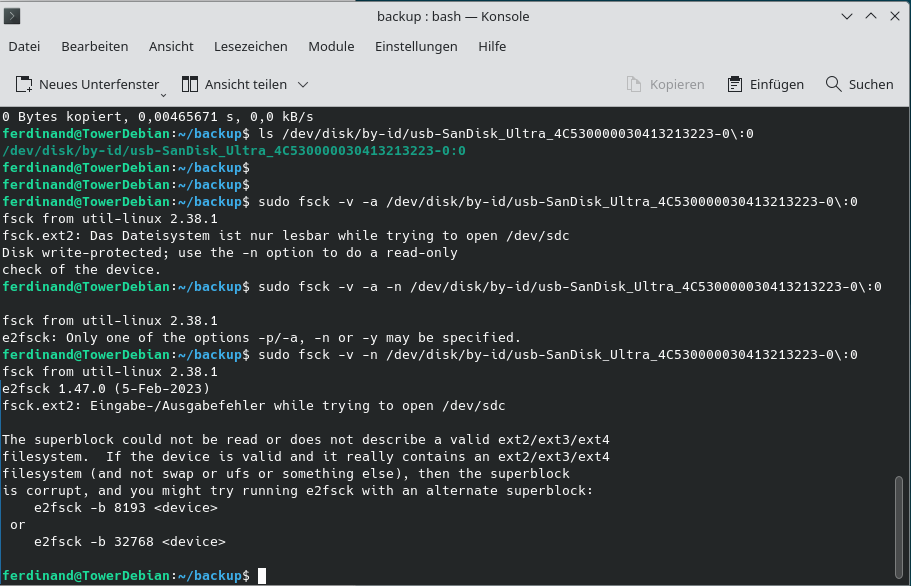

The flash drive is broken and inaccessible from either windows or linux (at least with normal automount)
I tried fsck and and this is the output:

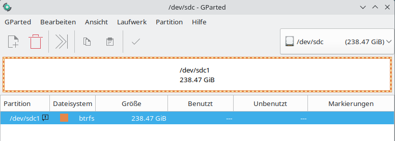

I also tried to mount the SSDs again and they seem to be BTRFS but i dont know how to mount or use them. And yes, they were set up as redundant mirrors:

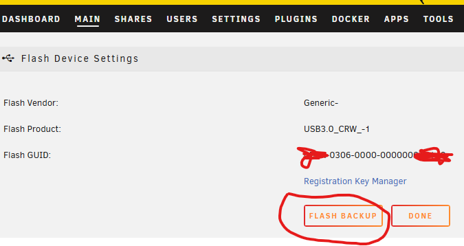

BTW, you can make that backup of the Flash drive directly to your download directory/folder on your PC by clicking on the 'Flash' under "boot Deice" on the MAIN tab of the GUI.  Then click here:
I am posting for more for the other Unraid users who are also making backups of their flash drive that end up on the array than for you.  If you are doing this, realize that the backup will not be readily available when you most need it!!!!
