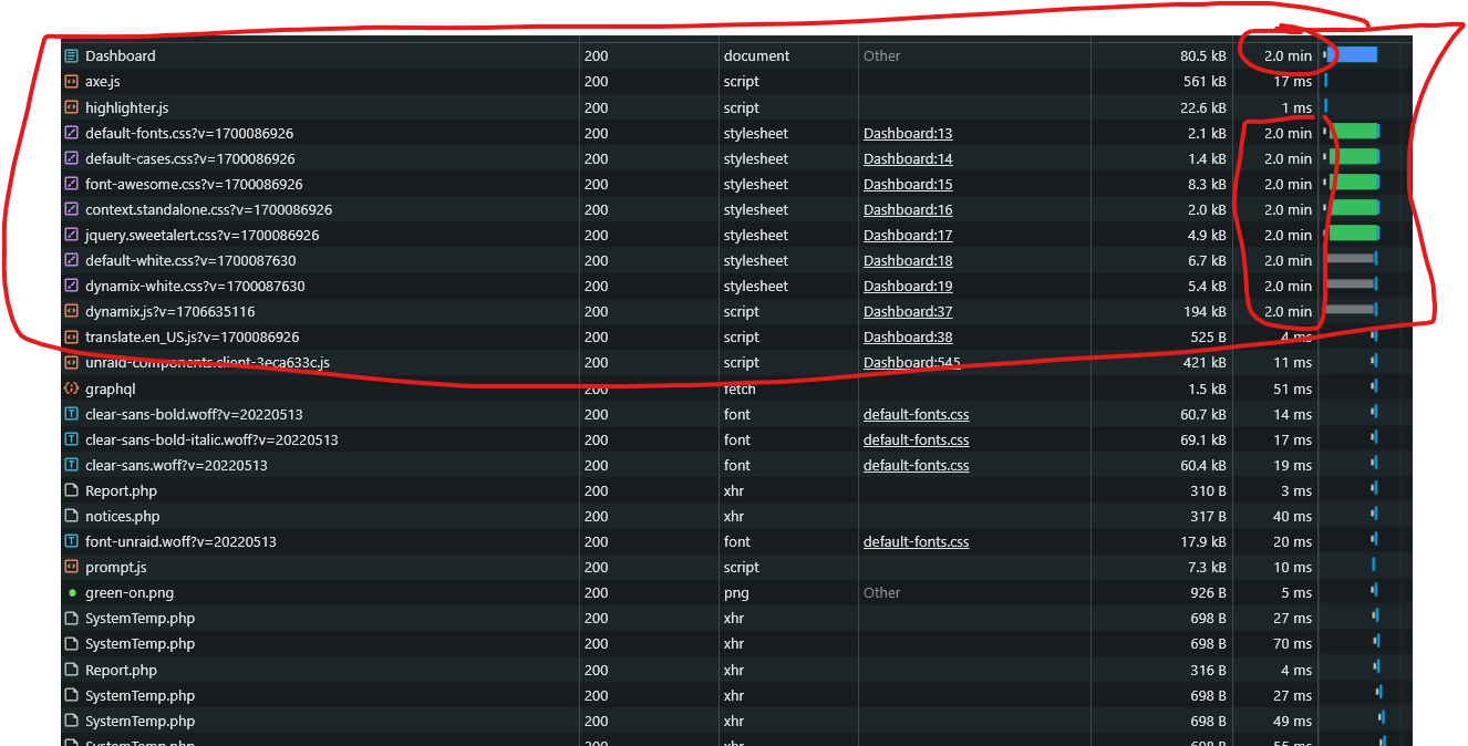

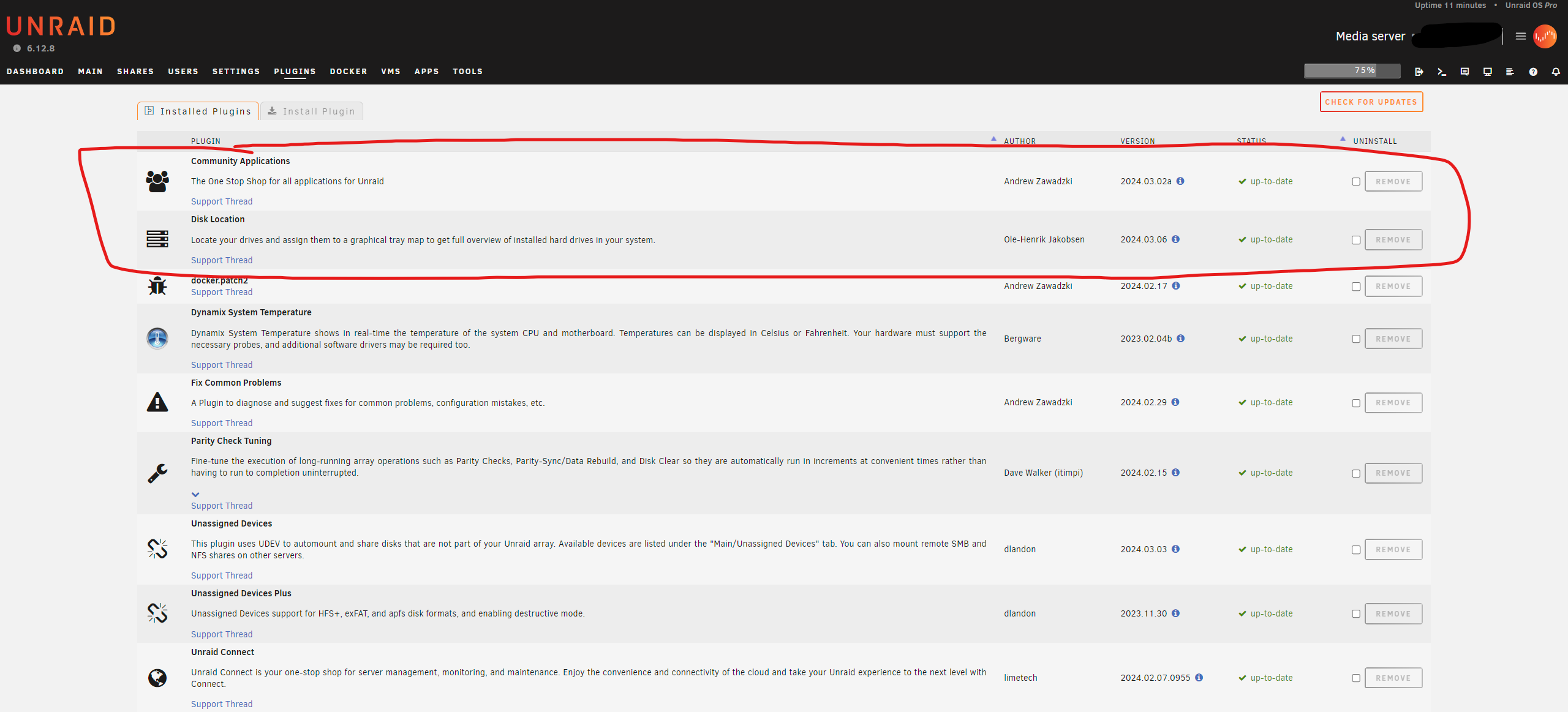

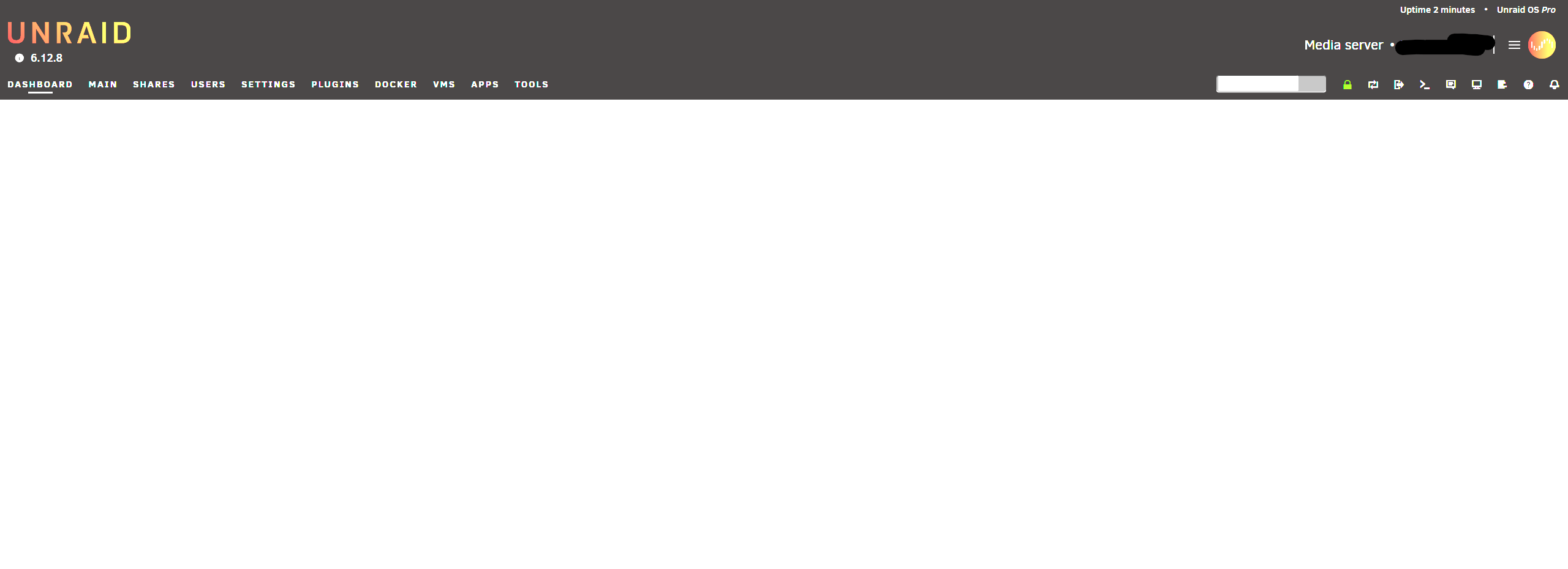

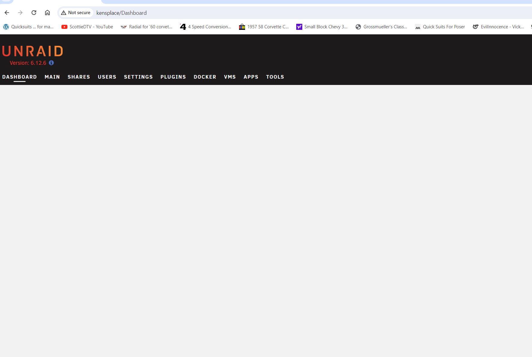

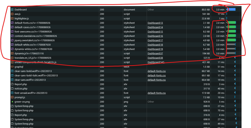

March 6, 20242 yr I just updated a few plugins and docker applications this morning and then shortly afterwards, I noticed that my Unraid Dashboard page won't load properly. If I recall correctly, the only plugins that I updated were: Community Applications version 2024.03.02a Disk Location version 2024.03.06 I also updated the following Docker applications: Dozzle HandBrake I rebooted my server by launching the terminal and entering the command: reboot My Unraid server did reboot, but I'm still experiencing the same behavior ☹️ This is what the Dashboard page looks like: The other pages, accessible via the header tabs, are rendering ok. I checked the browsers developer tools, and some resources are taking 2 minutes to resolve: These are my installed plugins: These are my installed Docker applications:

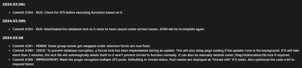

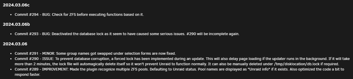

March 6, 20242 yr Author Solution I just checked and there was an update for the "Disk Location" plugin, after updating it, the issue went away.
March 6, 20242 yr Yes, I just update Disk Location to version 2024.03.06c and the issue is resolved on both servers.

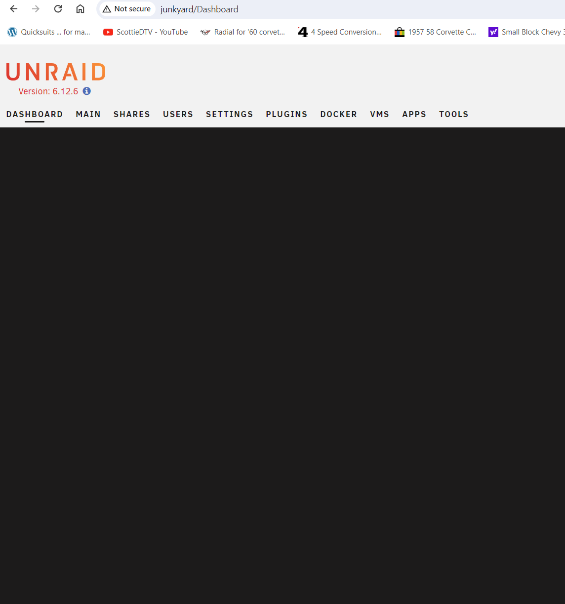

October 28, 20242 yr It was working fine, but then I went from some version to 2024.10.27 and now I have the blank Dashboard. * Found the support thread: Edited October 28, 20242 yr by semtex41 fixed typo and linked support thread.
October 28, 20242 yr Interesting to note this happened again this morning on one of my servers after an update of said Plug-in. I've removed the Disk Location Plug-in and the dashboard reappeared. Will monitor this to see whether a newer version will solve this issue.
